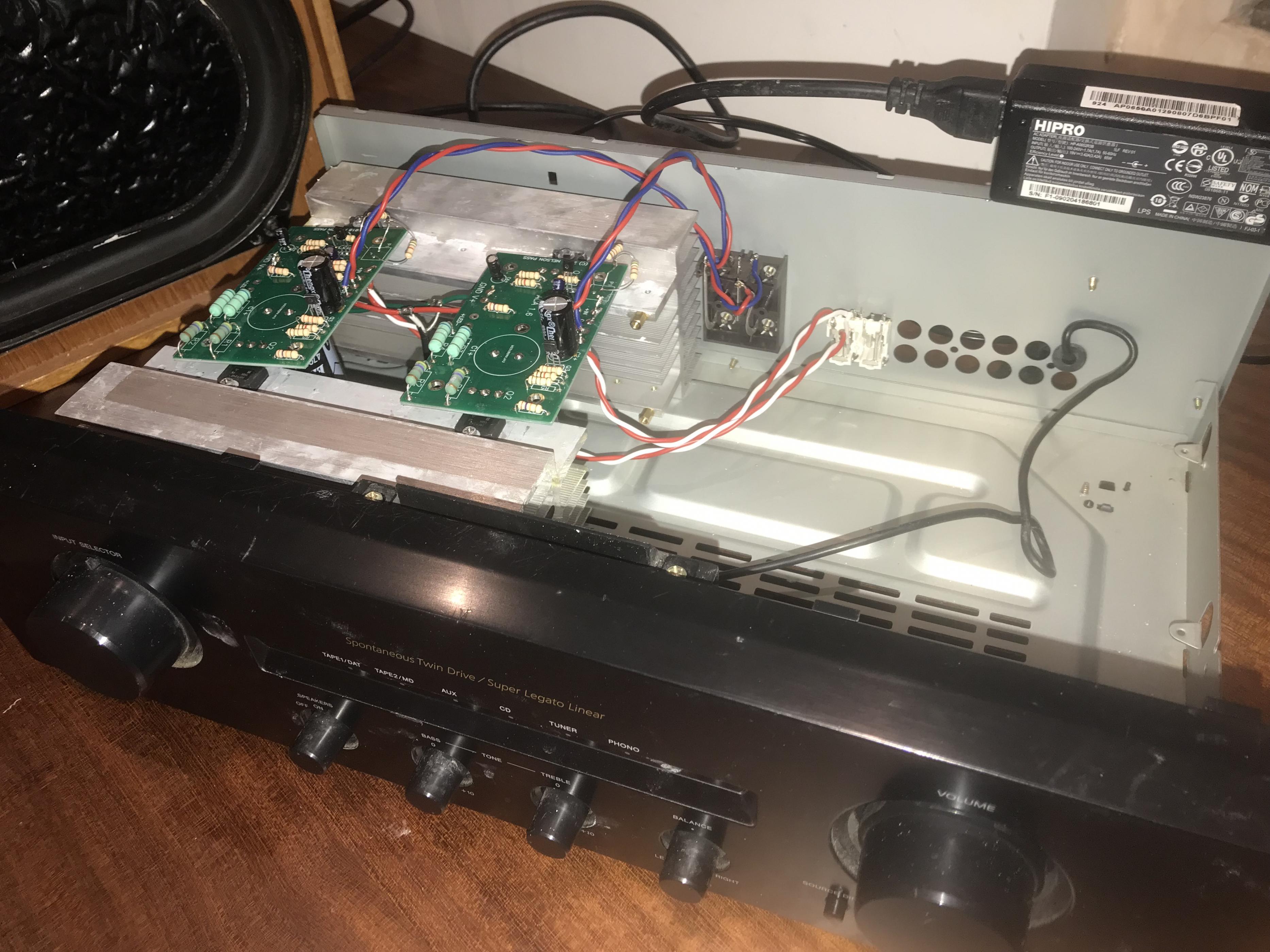

My attempt at a cheap ACA. I bought the PCBs from the diyaudio store ($15) an old Sony amp (£0.99) and used its case, speaker posts and RCA jacks, bought an old laptop SMPS (£5), managed to salvage heat sinks and capacitors (free), bought transistors and power resistors from a local shop (£15), total cost about £36.
Powered it up and it worked first time - happy days! Its a bit quiet fed from my Iphone headphone output, and feeding my KEF 104, but I'm currently bodging the trimmer pot with a couple of resistor so I'm hoping (fingers crossed?) that once I've set the bias properly the volume will come up. If not I'll be after a pre-amp or a better music source I guess. I have a couple of salvaged 24V fans that I'll add given the suboptimal heat sink arrangement...

The ACA responds well to a 24V supply, along with some tweaks to the input and feedback resistors. I like using 20k for R11 and 90.9k for R12. The trim pot should be adjusted to get about 12.2V for the "bias voltage" to take advantage of the higher rail voltage. Those changes will get your power output closer to 9 Watts, which will be a noticeable improvement.
