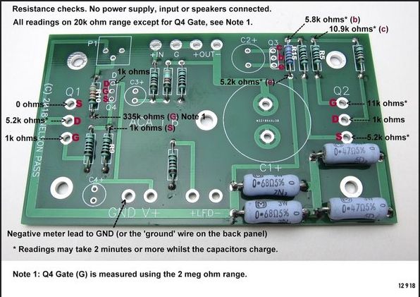

After having enjoyed the superb sound of my ACA, I am now again living in silence....😢
A few minutes after I turned the amp on I heard a loud pop coming from the right channel and after that it remained dead-silent.
The right channel is no longer heating up, and the left channel still plays, so there is no short.
What would be the most likely part to ‘give’, resulting in the abovementioned?
Rhank you in sdvance,
Neel
None really as all parts are used well within their ratings.
Just because it made a loud pop from the speaker doesn't mean that anything catastrophic has occurred. The speaker coupling cap seeing a sudden change in voltage would account for the noise you heard.
I recall you had problems earlier, so perhaps some undiagnosed problem with the build remains. Whatever has happened, a few quick voltage checks should be all that is needed to see what has gone amiss.
If you post the voltages present on the three FET's and one Bjt transistor then hopefully we'll have a good clue as to what has happened.
Neel007 - for how long has your amp been working? Easiest thing to check: make sure you don't have any leads on the bottom of your PCB touching the sink. You should also be able to power down, disassemble, and compare resistance measures between your channels. This might provide some clues. My guess would be to go after the transistors first: ZTX 450 is cheap and easy to replace. Start there if you find resistance differences. Next check the 2SK170 - both of these small transistors are static sensitive. If they are good, have a look at the big mosfets - they are also static sensitive.
See the attached images for voltage and resistance measurements. This might help a little, but these boards don't have caps/transistors installed...
