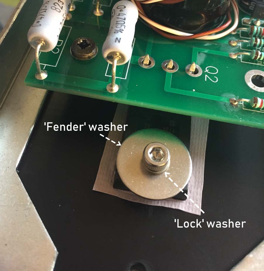

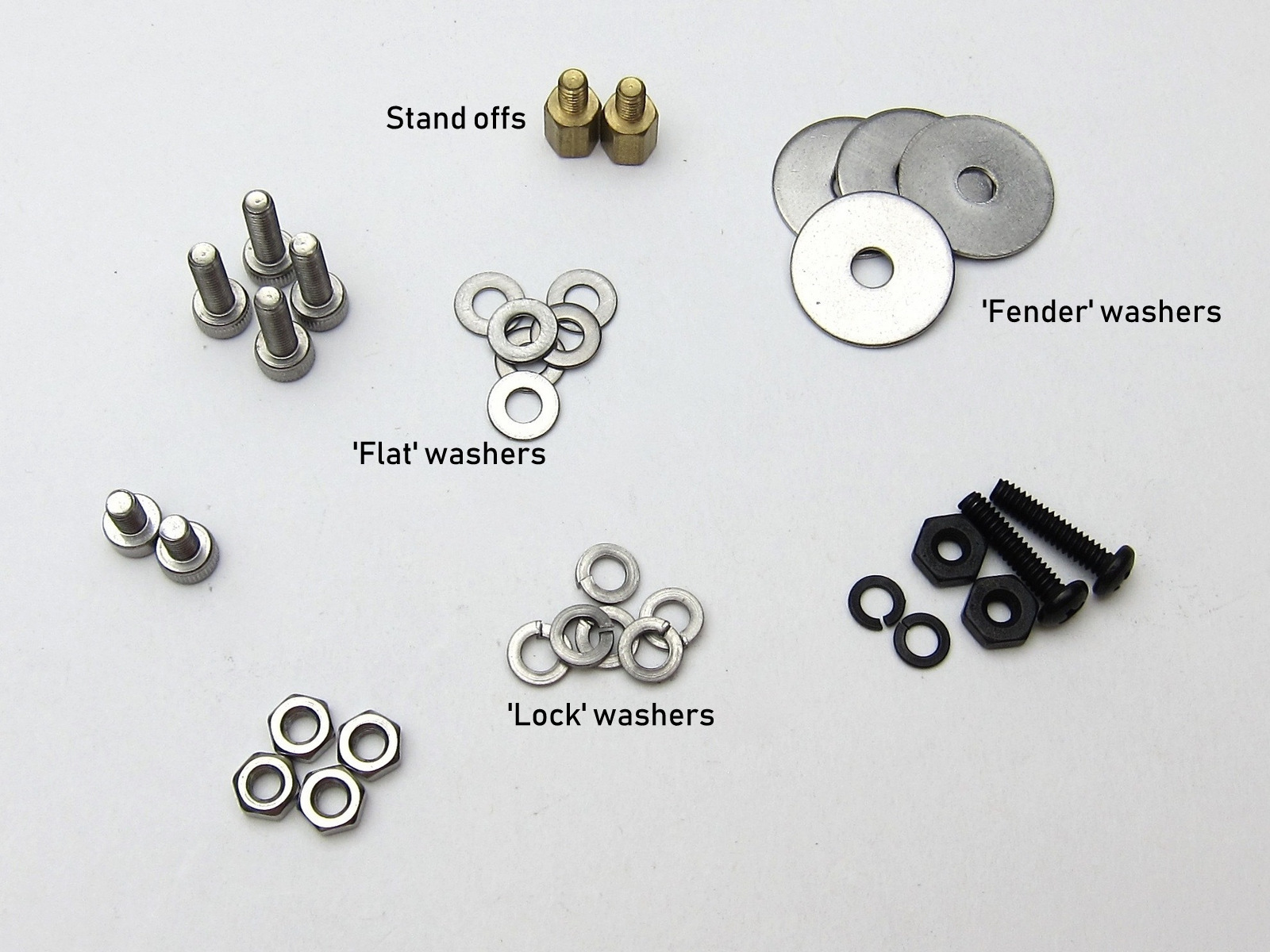

Little lost on step 14. Point 3 reads
"There should be a lock washer (split washer, spring washer) between the fender washer and the screws."
Is this saying the image is wrong? What's the lock washer? Does it go transistor-lock washer-fender washer-top of screw. Or transistor-fender-lock washer-top of screw?
The idea is to provide the most uniform pressure on top of the transistor against the heatsink.
The best way to achieve this is to put the larger flat washer over the transistor: this will apply the uniform pressure in the largest available area.
On top of that you want a pressure washer that will offset any misalignment between the screw head and the large flat washer. It will also prevent vibrations and other variables to loosen the screw.
On top of that you want the screw head making the pressure against the lock washer.
Does this make sense? I find it easier to understand things when they have a reason behind them instead of just recipes to follow.
Hope this helps,
Best regards,
Rafa.
Hope this helps,
Best regards,
Rafa.
Yes, the lock washer is not shown. See pictures. It goes pad, transistor, 'fender' washer, 'lock' washers then screw (bolt).
Reasons as Rafa says.

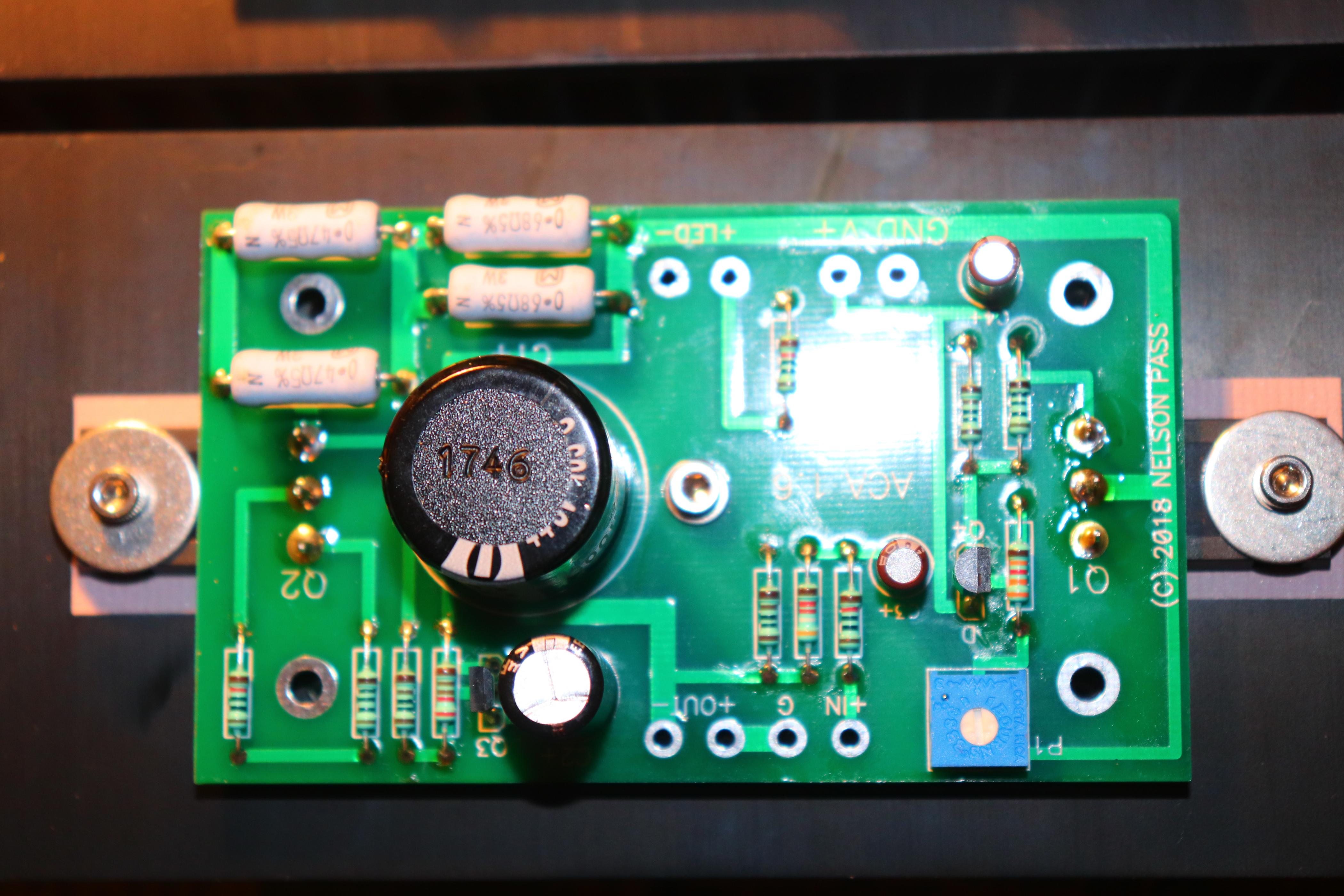

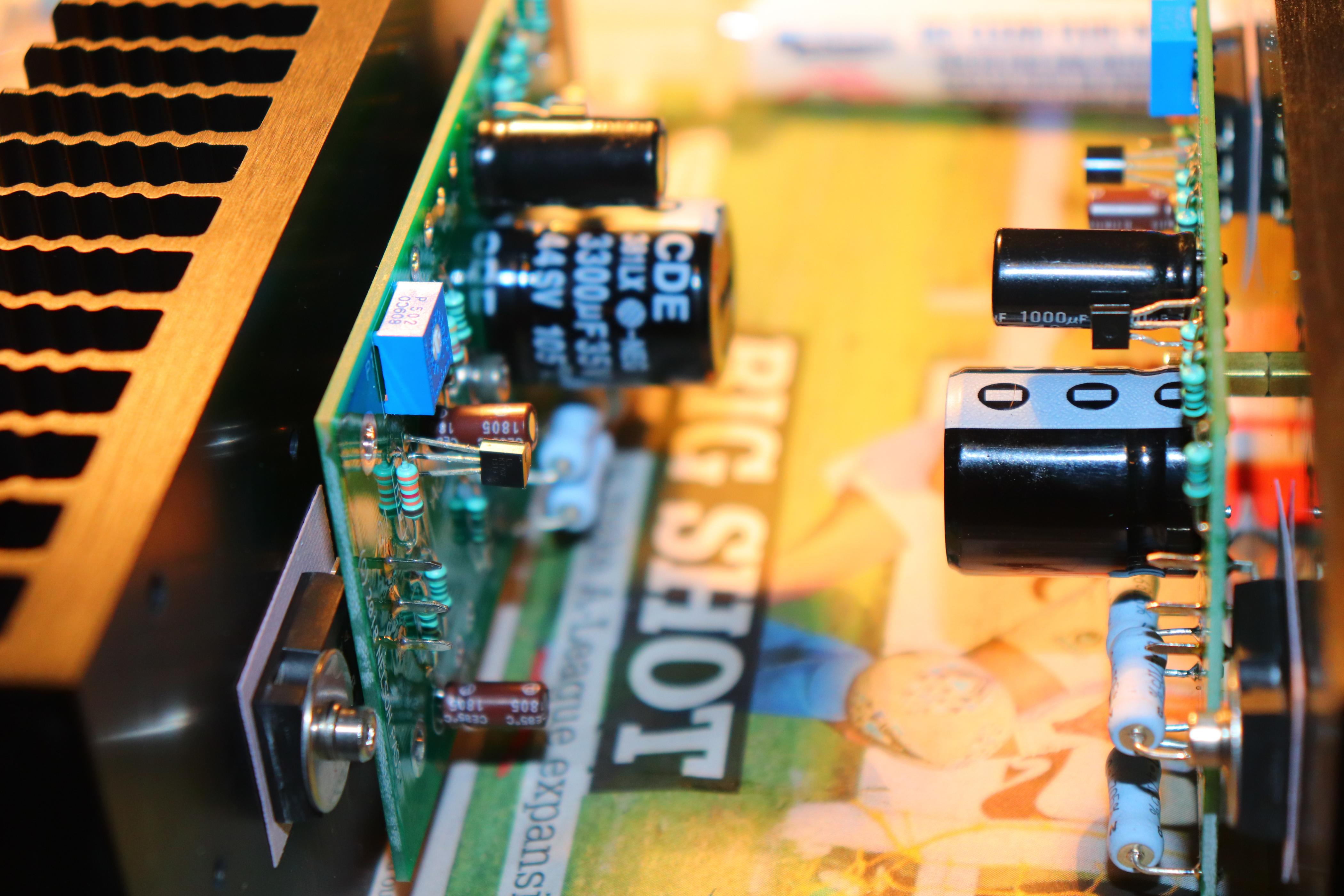

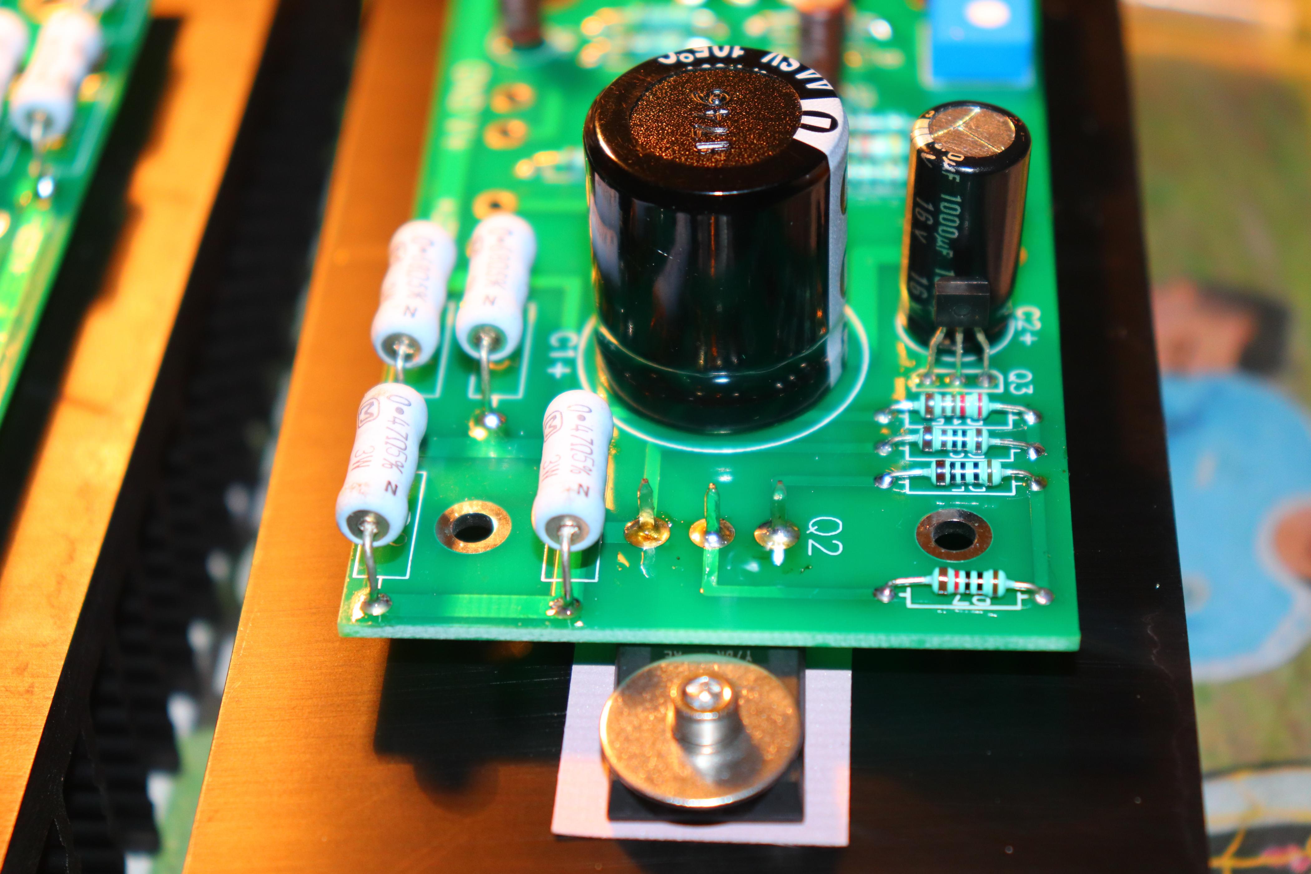

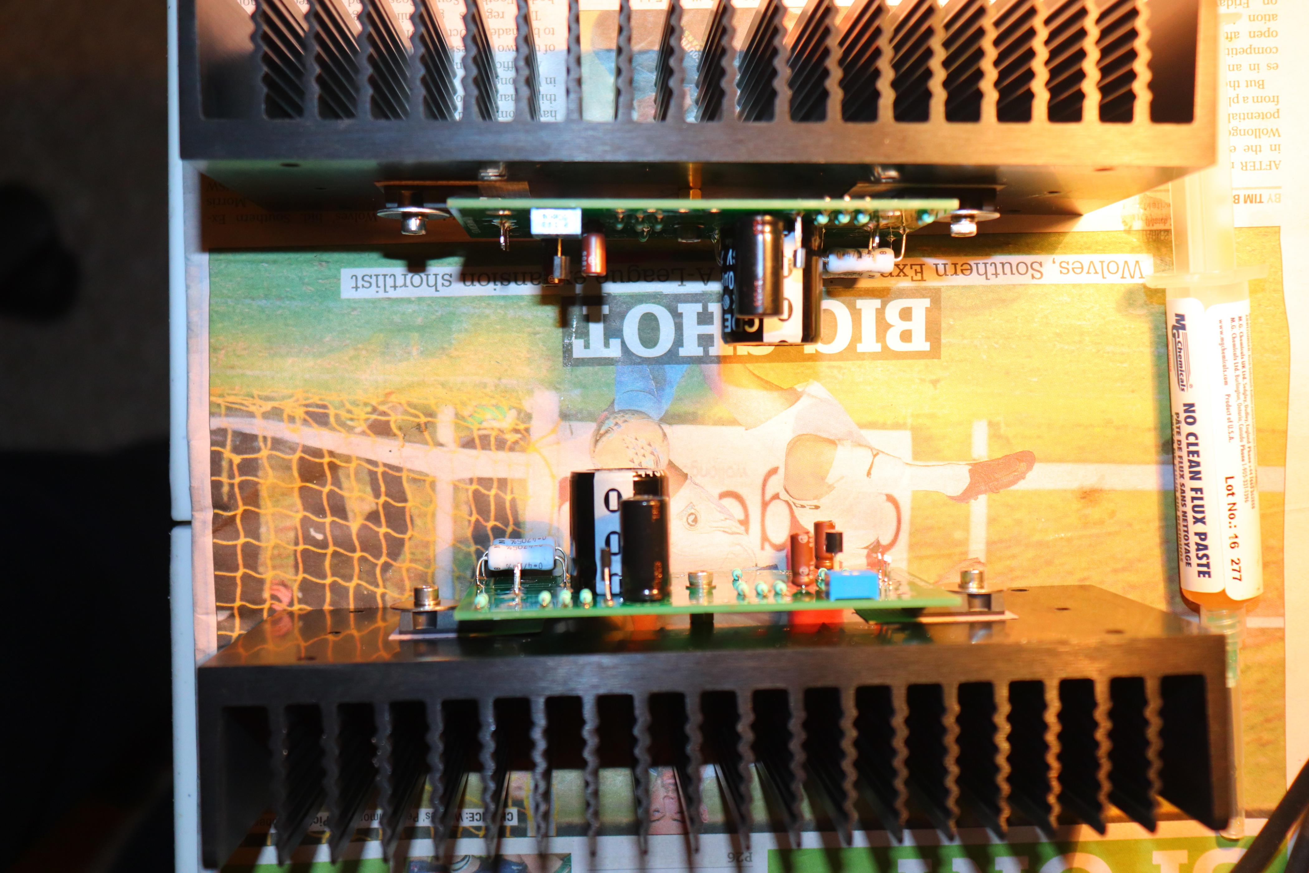

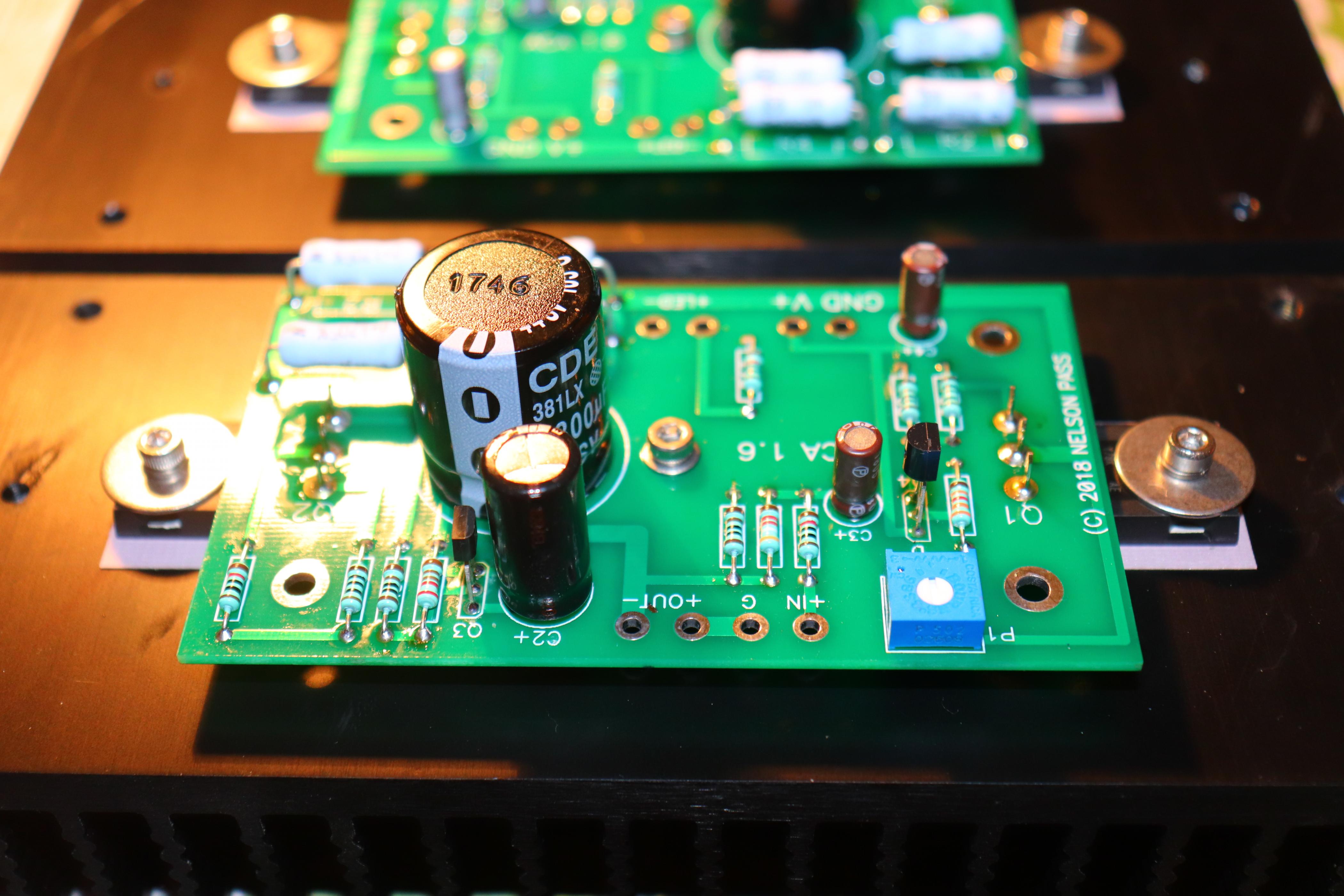

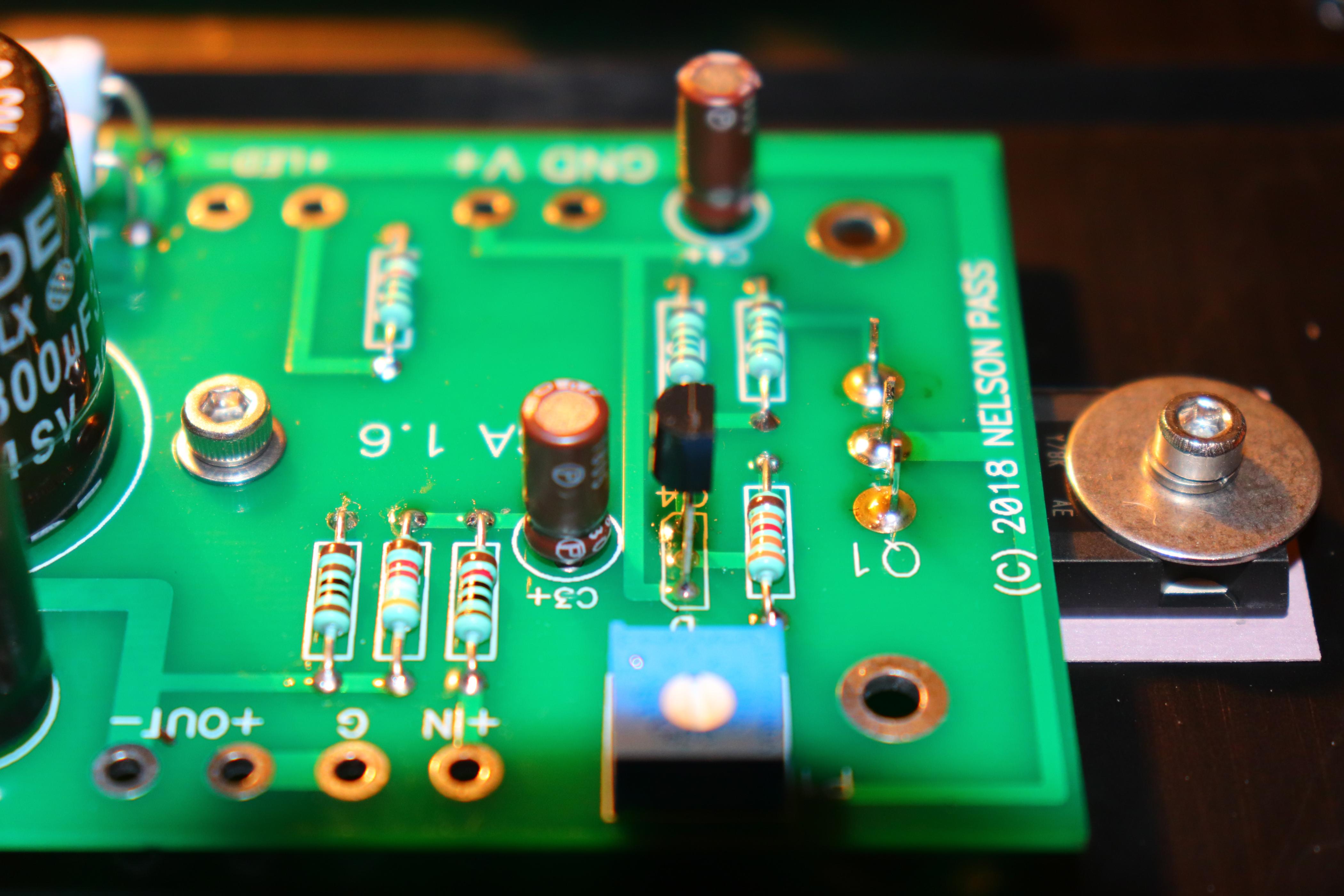

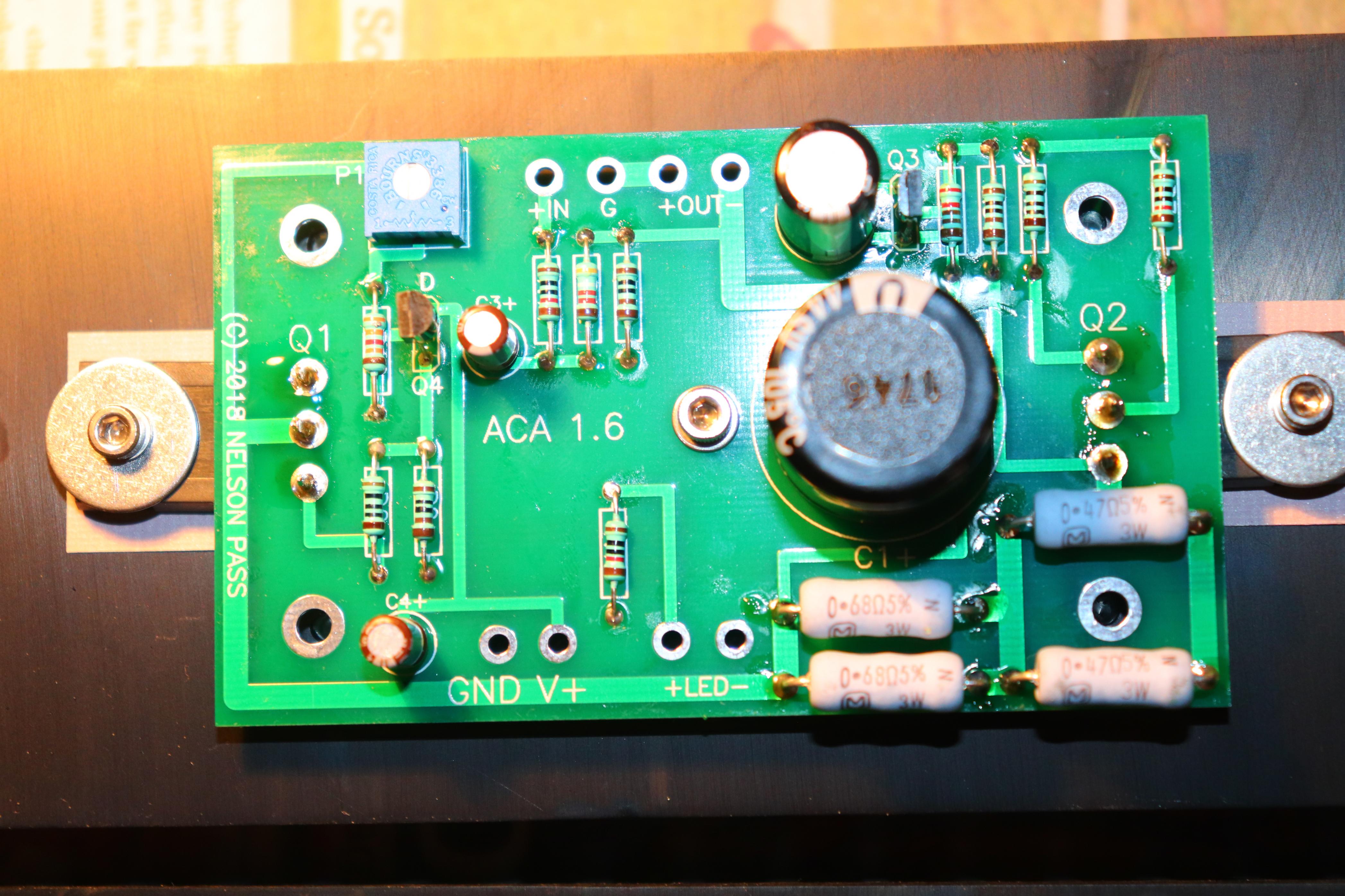

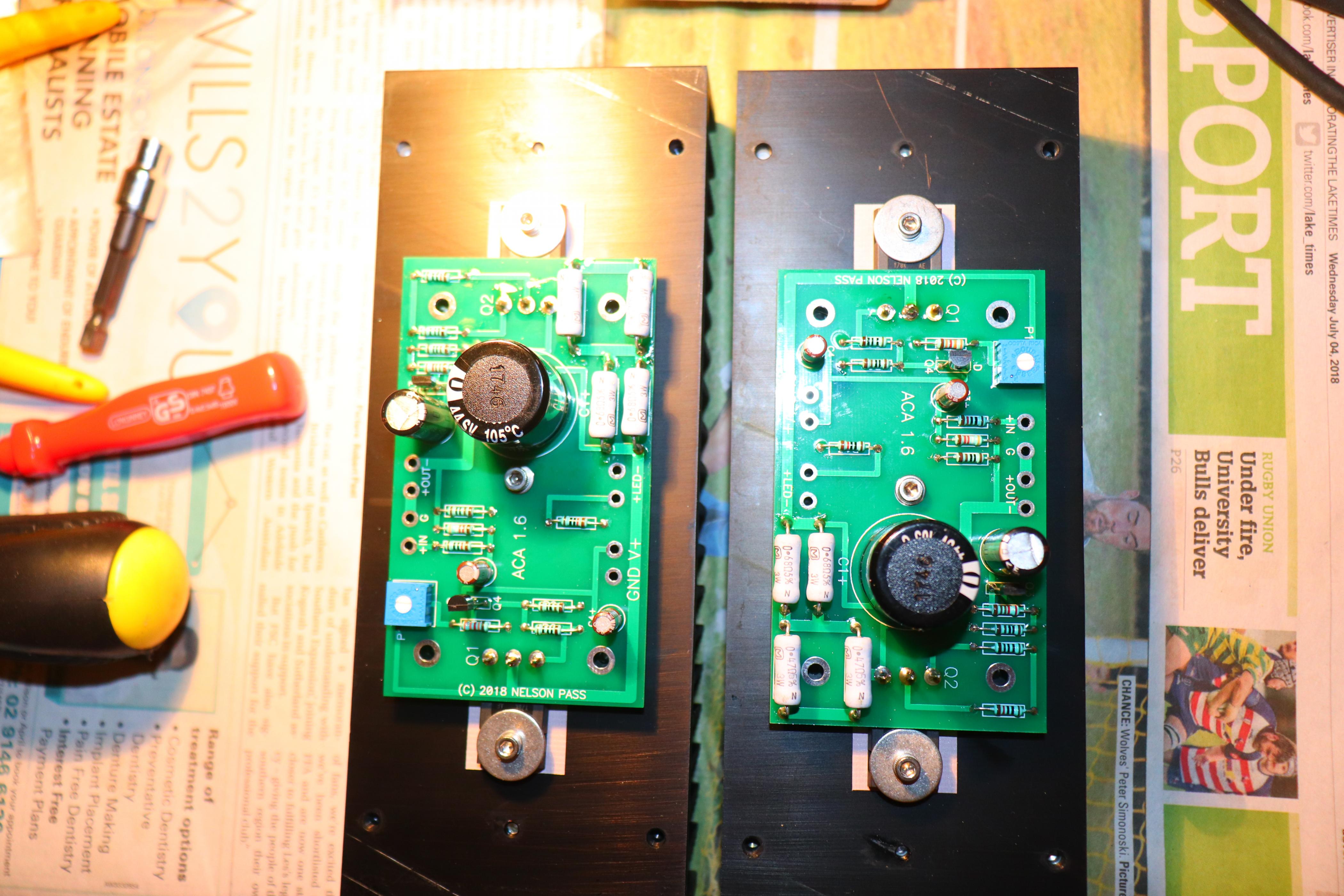

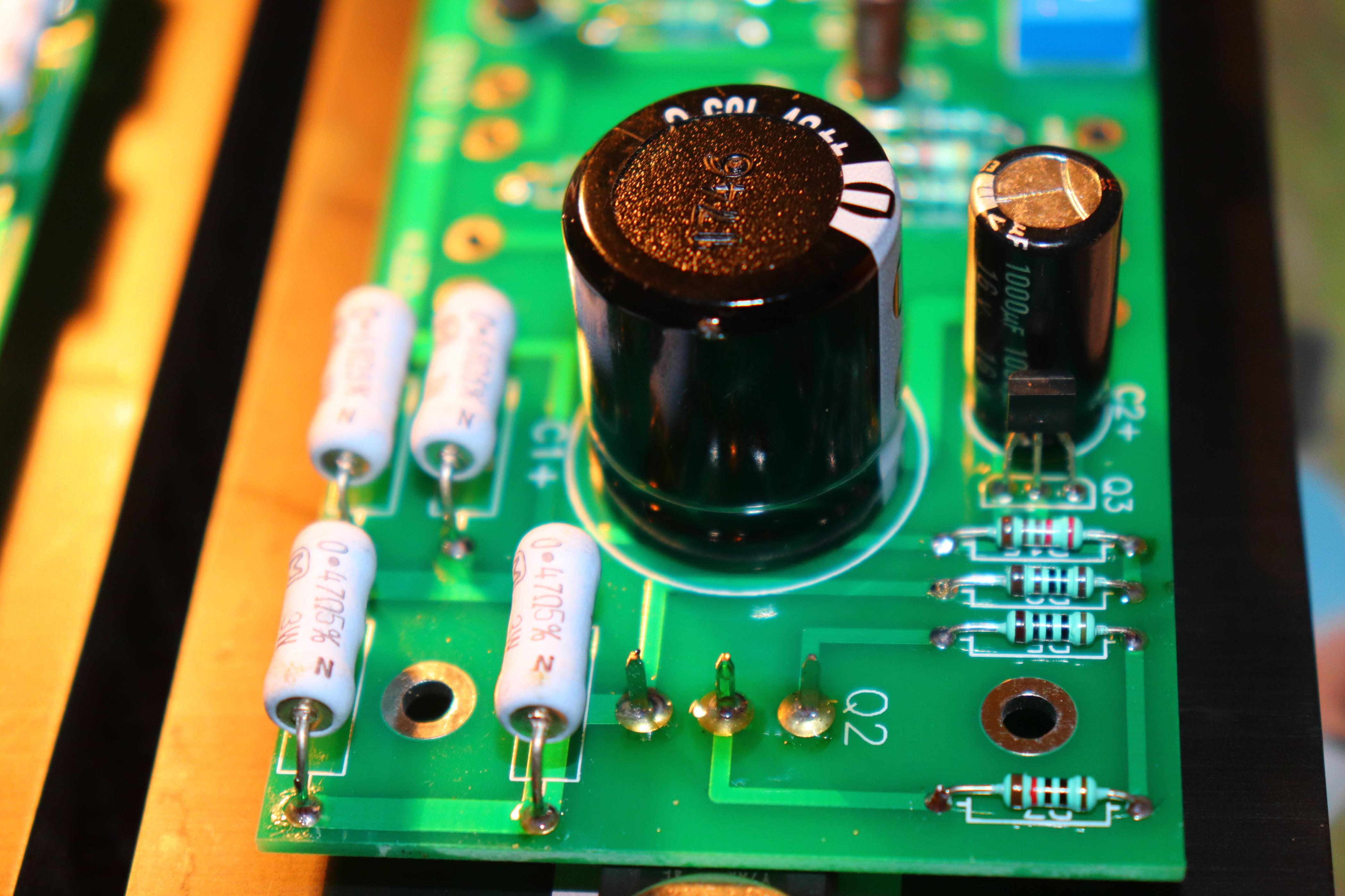

Soldering the ACA 1.6 amps
Hey all, I built my ACA 1.6 PCB's and put them on the heath-sinks. I plan to build another ACA for dual mono configuration, but I will first build this one in stereo and test it in my sound system. It was fairly easy to put all components together thanks to 6L6's excellent build guide. As I always do, I used no clean flux paste on all the solder pads and -joints, which lets the hot solder flow evenly over the pads and you get beautiful solder joints. I used a Weller temperature regulated soldering station with differently sized screwdriver tips; temperature was 300 degrees centigrade on the bigger parts / pads, and 250 degrees centigrade on the more vulnerable parts like the small transistors. I also used a small crocodile clamp with a small piece of folded aluminium foil clamped on the transistor legs on the other side of the PCB whilst soldering them, to keep them cool. This is especially important with "unobtanium" 😎 parts. The lead-free solder with rosin-core I used contains 96.5% tin, 3% silver and 0.5% copper, with a melting temp of 200 C.
I hope to finish both amps in the coming weeks and test them in stereo and in bridged mono.
