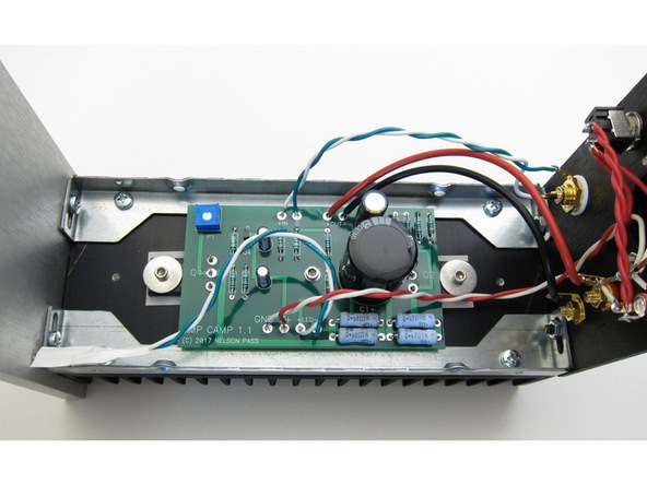

I checked everything:
- that there is no shorts anywhere
- that MOSFETs are not shorted against the heatsink (middle leg should not beep continuity with the heatsink)
- I actually measured every expected value on their 'next' points... so I measured a resistor one 'hole' ahead and one hole before to make sure everything was properly soldered and with their correct values (which I did measure beforehand as well)
- make a final visual inspection that every cap and transistor is oriented correctly (I had one soldered the other way around)
Be sure to first power up the amp without any input source or speakers! Once you start it up, I tried to quickly assess that the bias current is not beyond the 12V mark. And then, just work slowly.

So o checked and rechecked and all seems correct.
I cant find any shorts, the mosfets dont beep against chassis, any leg from them, all seems correctly oriented and i am still afraid to power it up lol...
As i dont have alligator connectors with me i am going to buy them and then i'll make the 1st power on.
Just to make sure i have this right, on the back on the speakers connectors, the red ones are the out+ from pcb right? So what is ground from the back pannel wires is the speaker + on the back? That is correct?
This is also chassis ground.

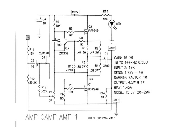

Yes. And yes it is confusing. The 'Red' output terminals are connected to the Ground wires.
Make sure it is like Step 35 of the build guide.
It conforms to the circuit diagram Step 1 that is '+ OUT' connected to 'ground'.

Let me just report to you the S now measures about 12.+ v so are resistors 1 2 3 & 4 all ends. Resistors 3 & 4 are a little lower at 11.6 v. on the other ends.
However, there is no sound coming when connected to a speaker.
The other board also measures similarly and there is sound coming out.
The DC conditions appear to be correct now which is 95% of the way there really. If the bias pre-set works correctly and is able to swing the voltage on those four resistors by a good amount (say down to 7v volts and up to 18v then your problem has to be either no continuity of the audio signal to the input coupling cap C3, or no speaker continuity from the output coupling cap to the speaker sockets. Or something like a short at the input or speaker sockets.

Check/compare input and output wiring between the working and the non-working side. Could be something as simple as a shorted input, or something more complicated. Post some pictures.
