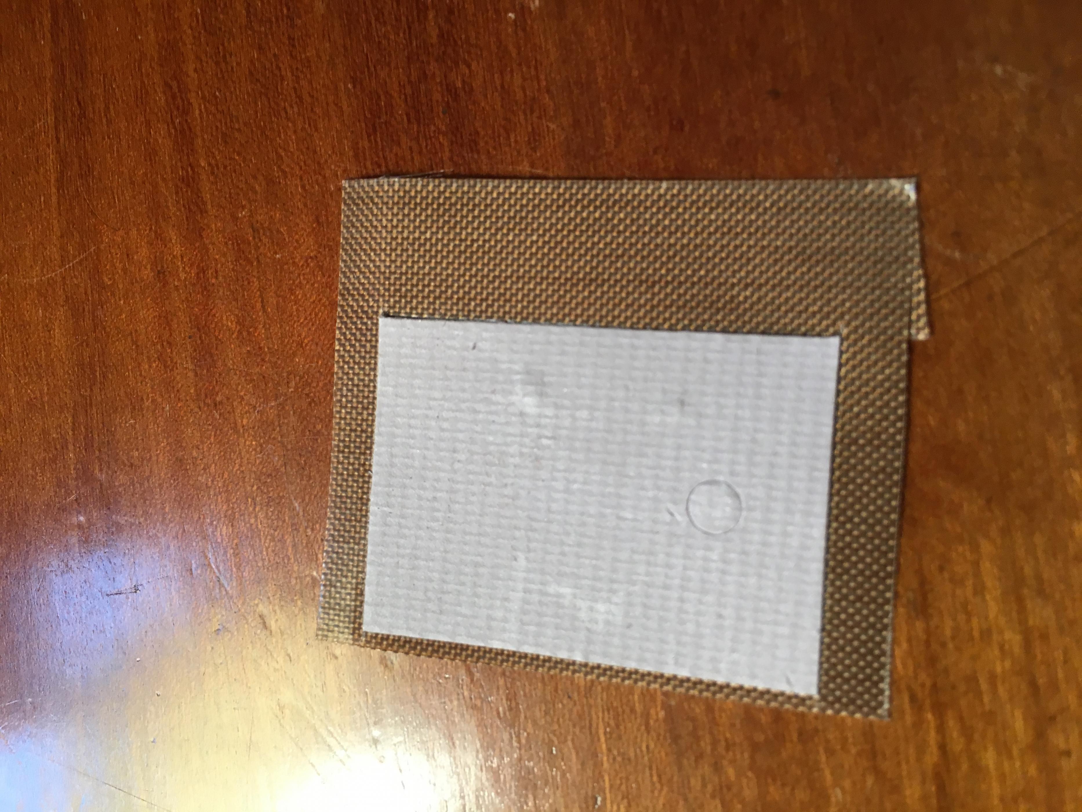

When I used just the grey layer (the lighter layer in my photo), had all kinds of problems - distortion, volume drop, etc.. When I replaced with both layers, everything cleared up! In the build video on diyAudio, the TekThings guy uses both layers as you can see in my photo here. The woven brown layer is pre-cut underneath the grey layer. What's going on?!

Jeez....you guys are confusing me...I believe its ONLY the grey pad that's keratherm and that needs to be placed between the chip and heatsink....without any thermal paste....

Yes - Only The Grey

Sorry for my contribution to the confusion... All evidence points to the grey only in spite of what I experienced. The video on diyAudio appears to be incorrect. The guy never says "apply both layers," but he clearly does so in the build.
In the meantime, I have one amp working beautifully with just the grey layer. The other not... but when I add the backing, viola, all good.
Scratching my head in confusion. Bad mosfet maybe?

The grey Insulators ones are official also. They were never very pink...in fact maybe we just wanted them to be pink! 😉
That video is wrong - he cuts out the clear backing sheet backing sheet and uses it, - Wrong- Dont use the clear backing sheet!
The most logical reason the amp worked with the clear backing sheet is as has been mentioned- without the backing sheet there was a short through the rubbery correct insulator.. maybe a sharp piece of metal or wire stuck in the Keratherm or a metal burr on the heatsink poking through the Keratherm. Its quite soft which is why it works- it conforms to the surfaces..

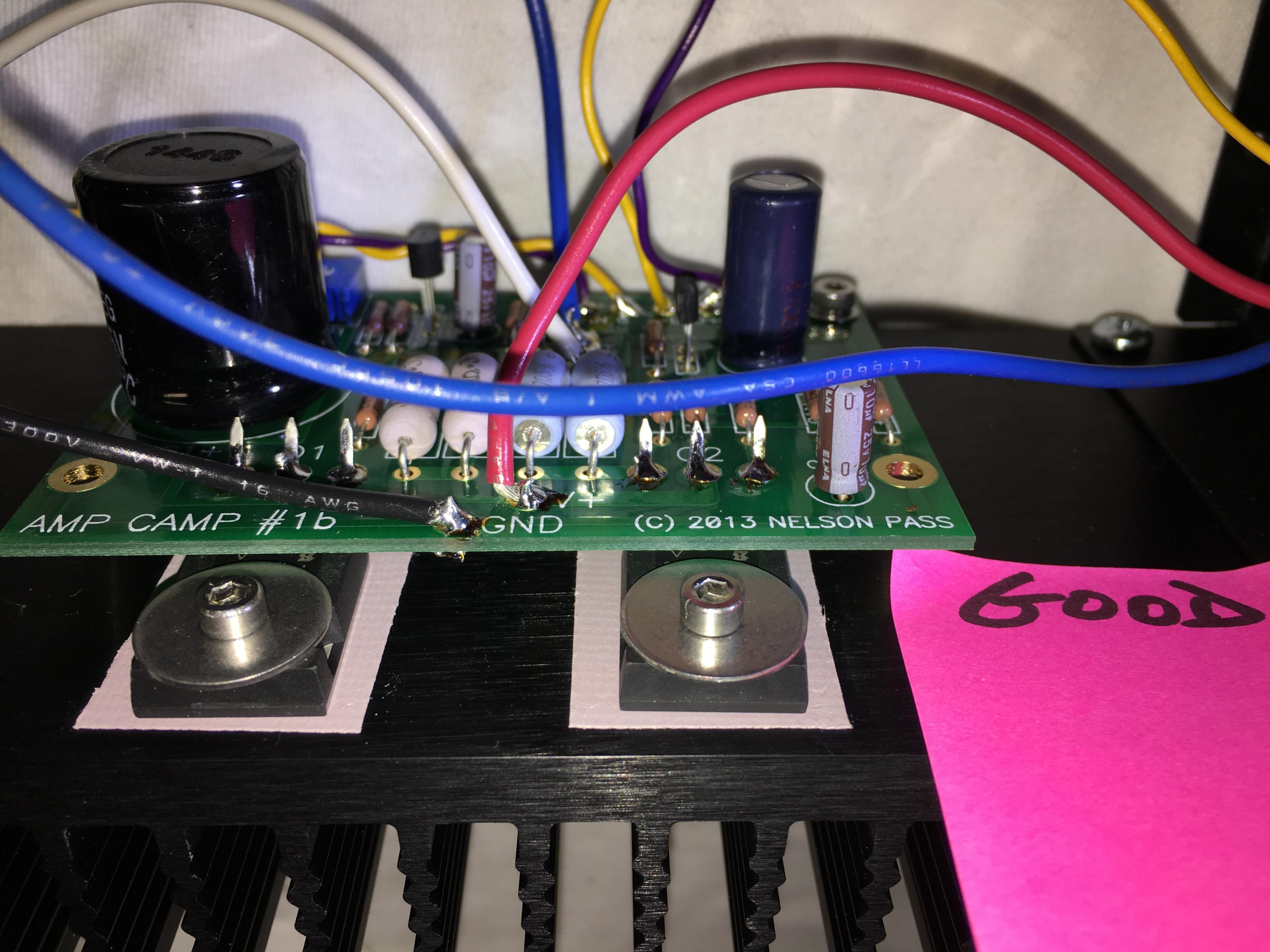

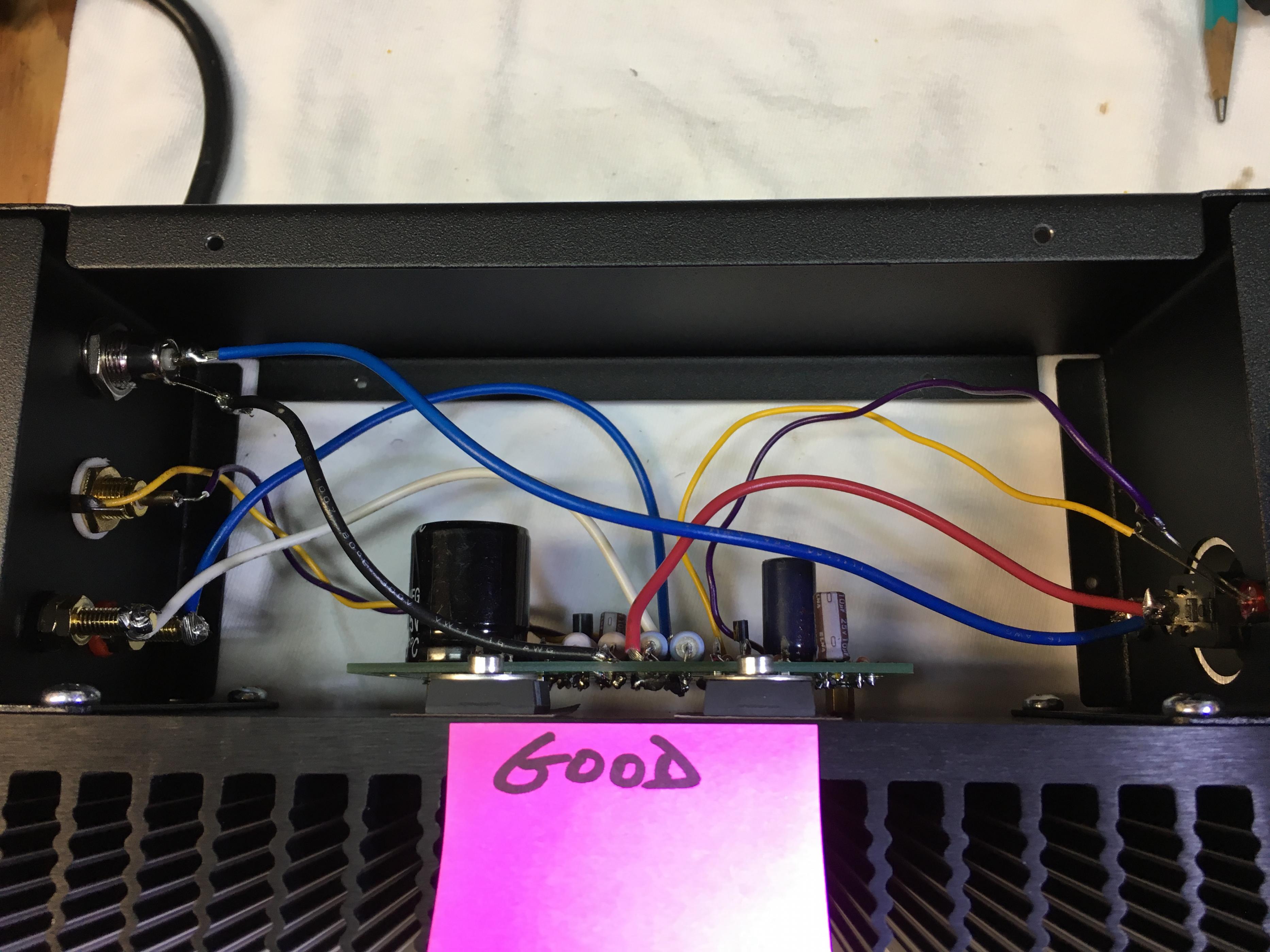

The Good, The Bad, The Ugly

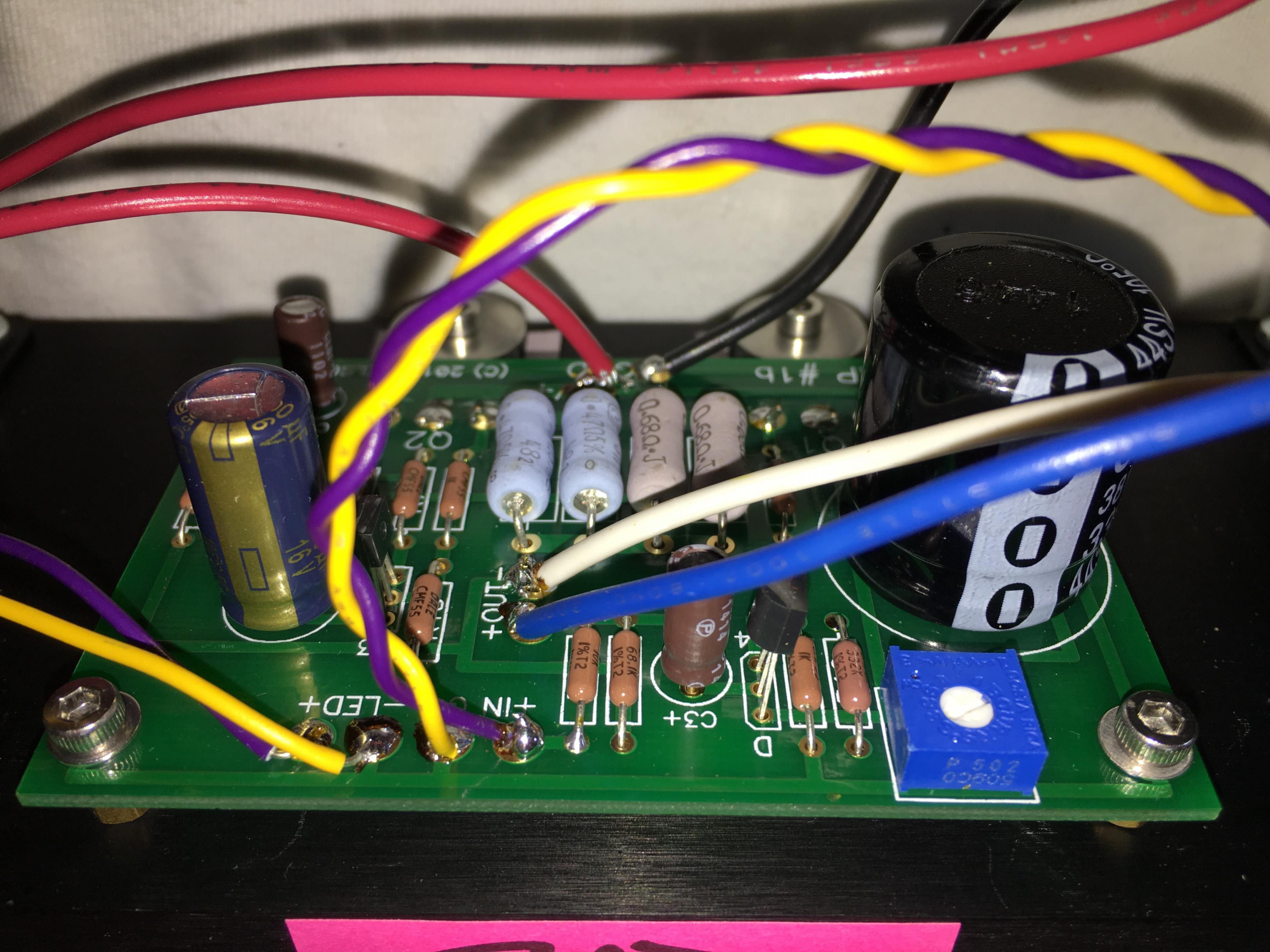

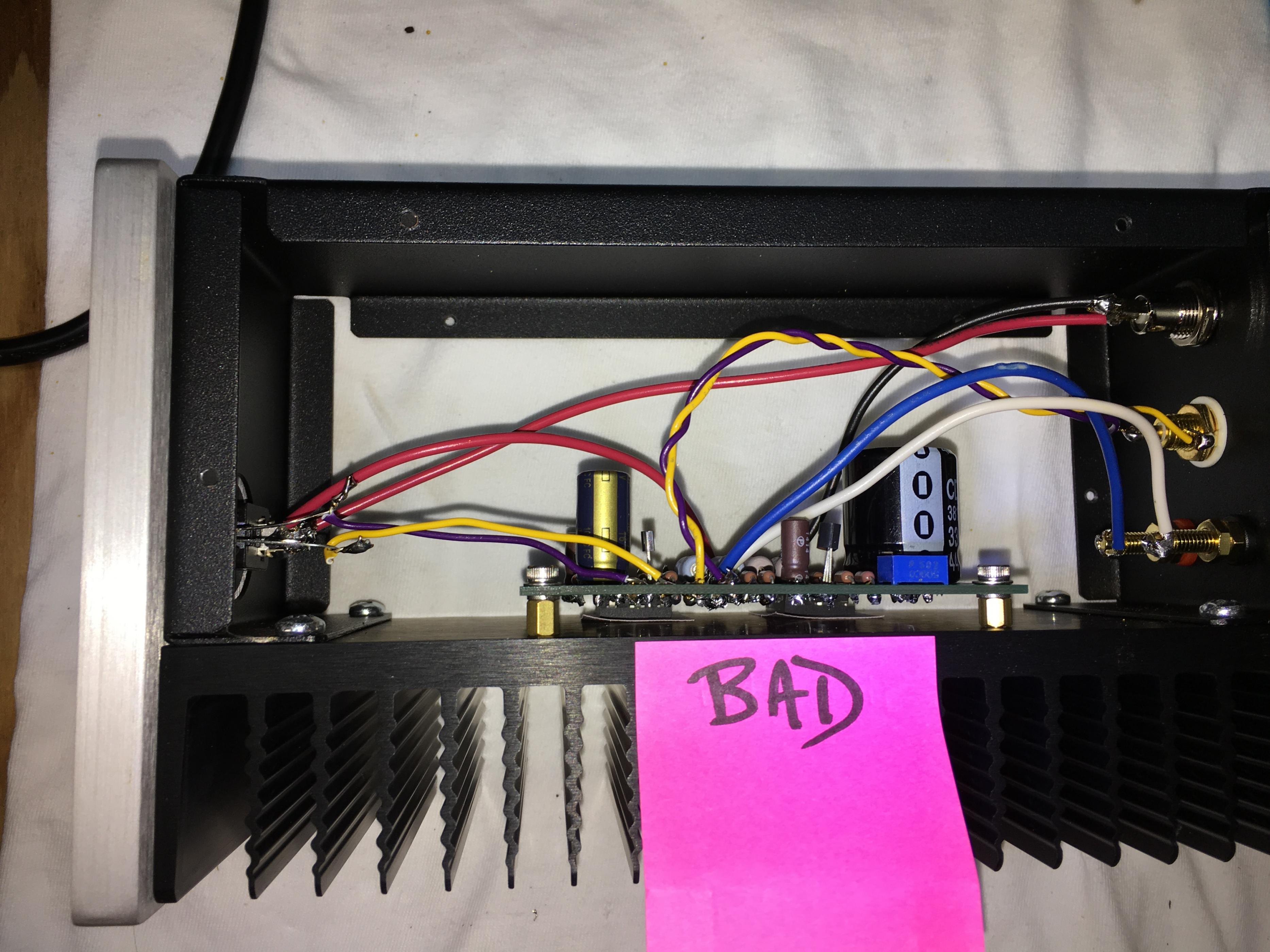

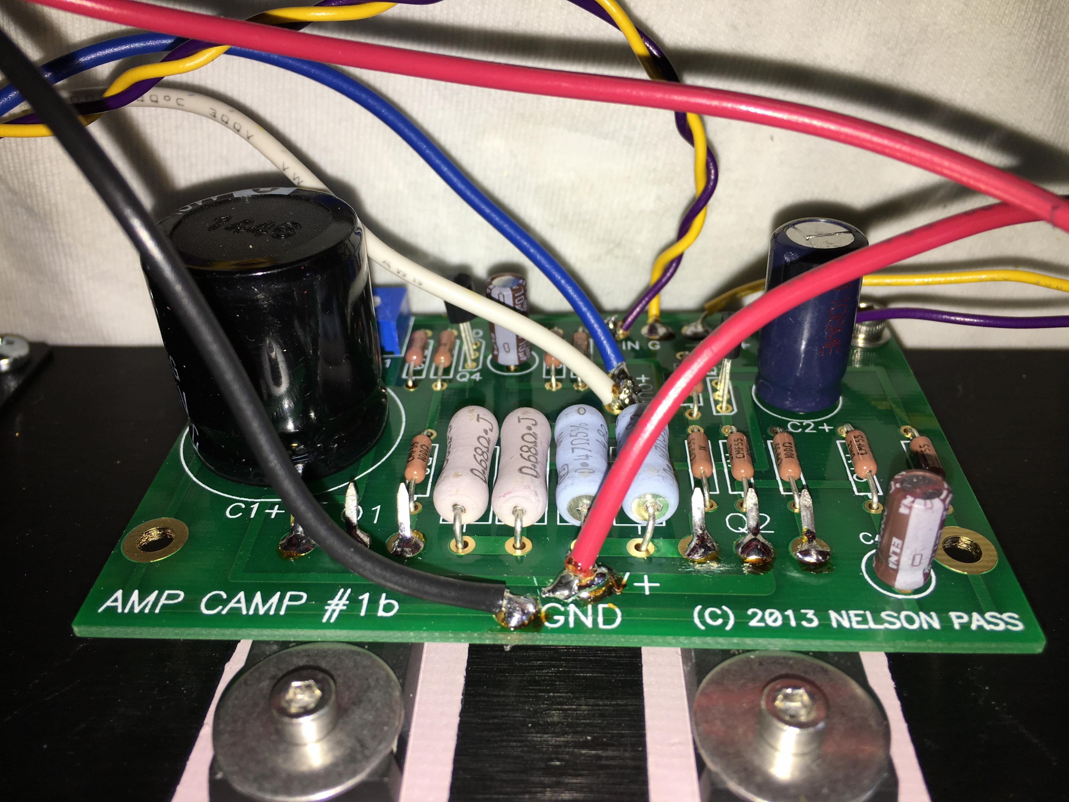

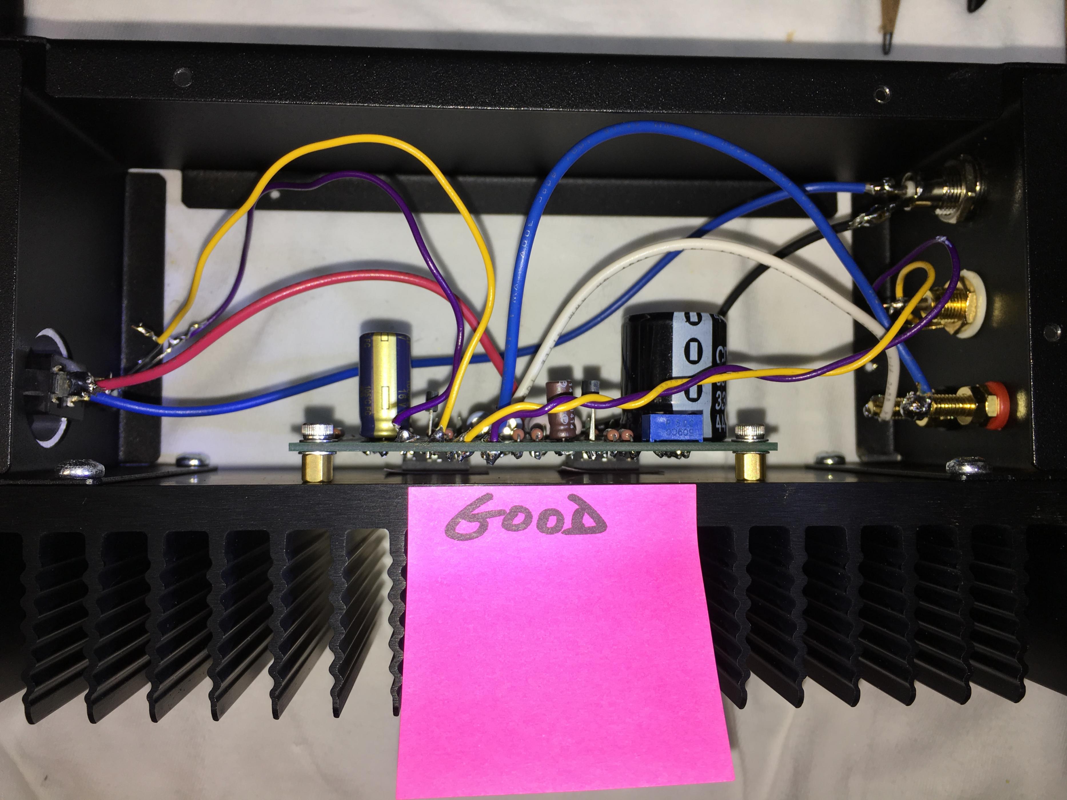

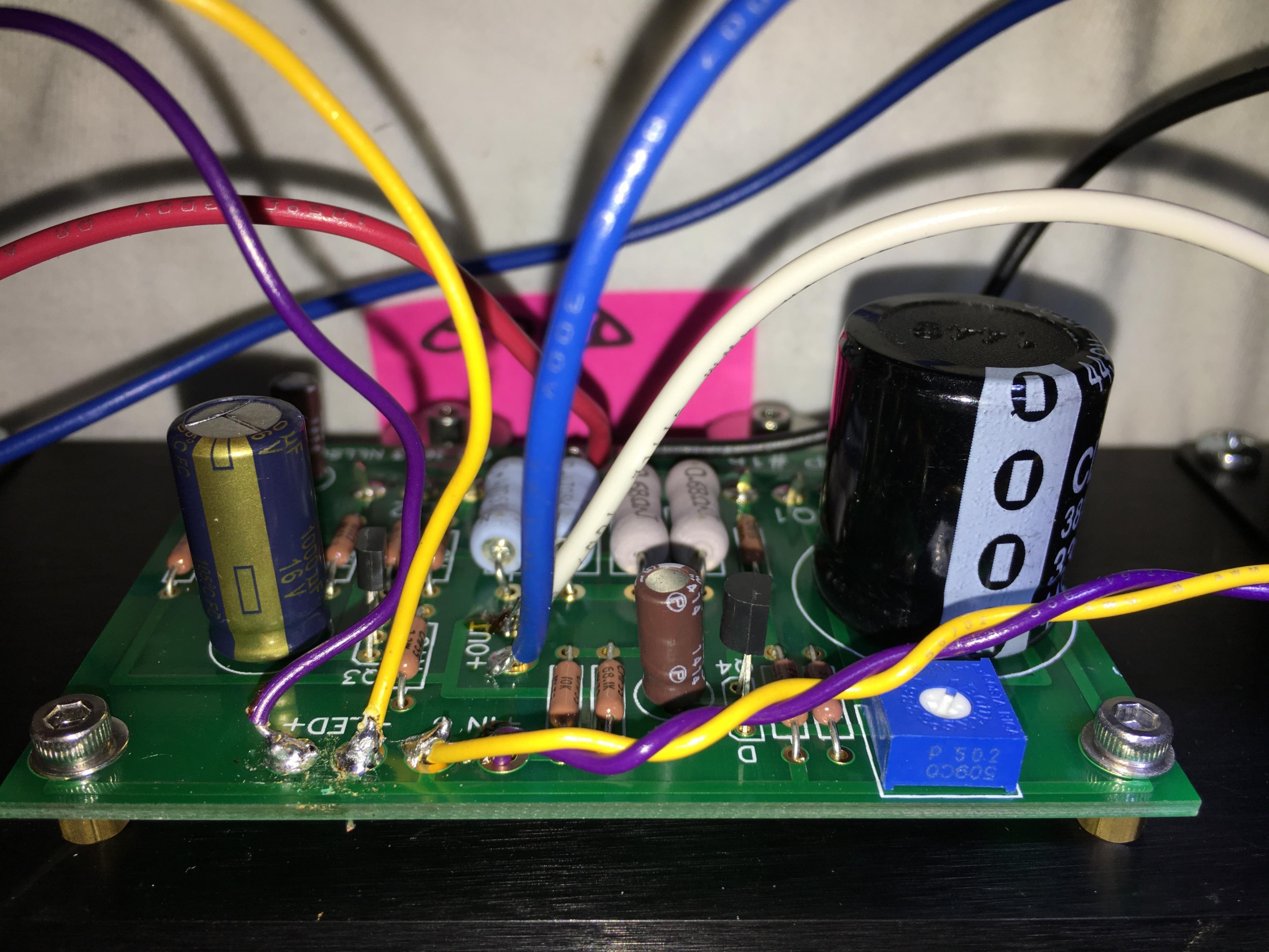

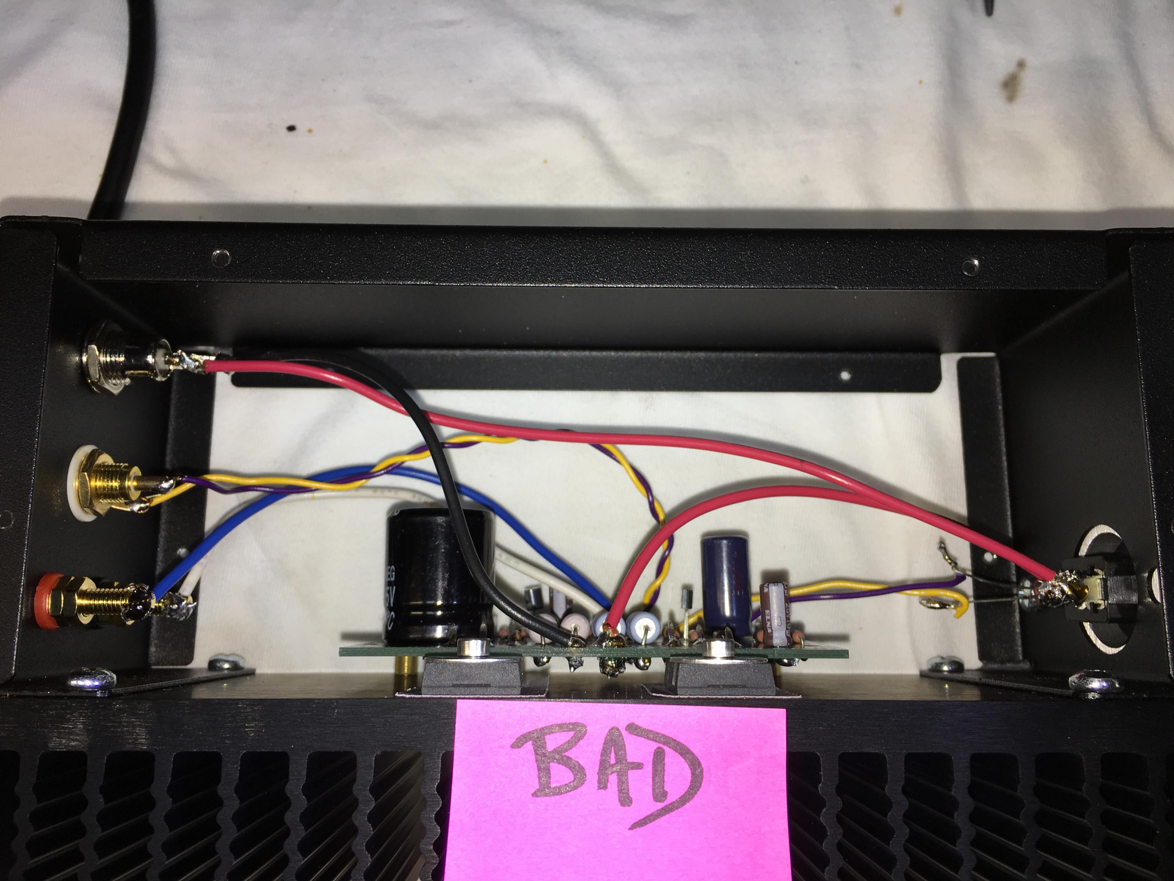

DIY friends. Finally had an opportunity to take and post some photos of my wayward 1st attempts at building amps.
So, first, 4 photos of the good one.
Then, 4 photos of the bad one.
The ugly? Well, one look at my soldering...
Thanks for any and all sleuthing to help this rookie DIYer...
I must confess, about ready to throw in the towel 😱
