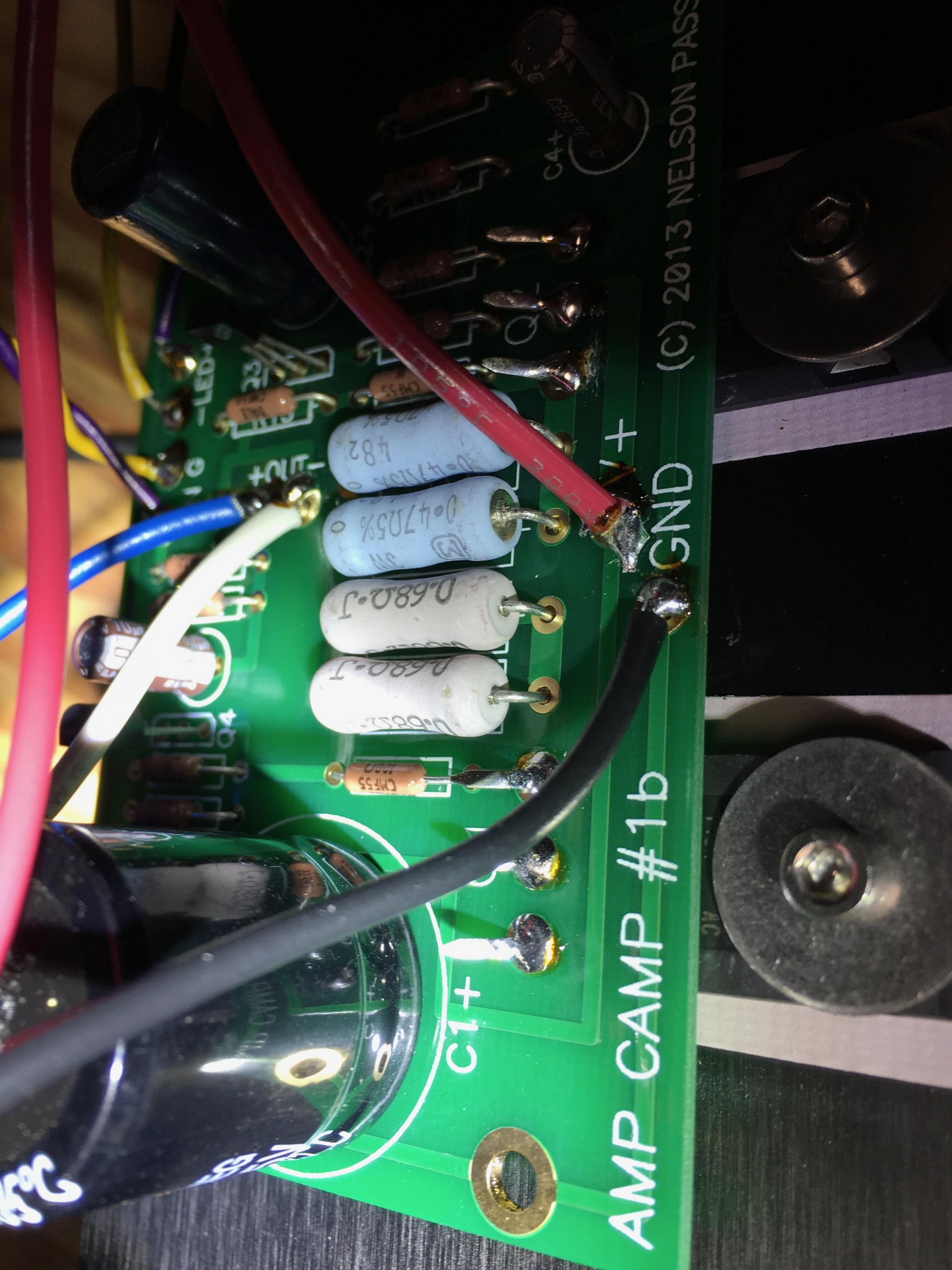

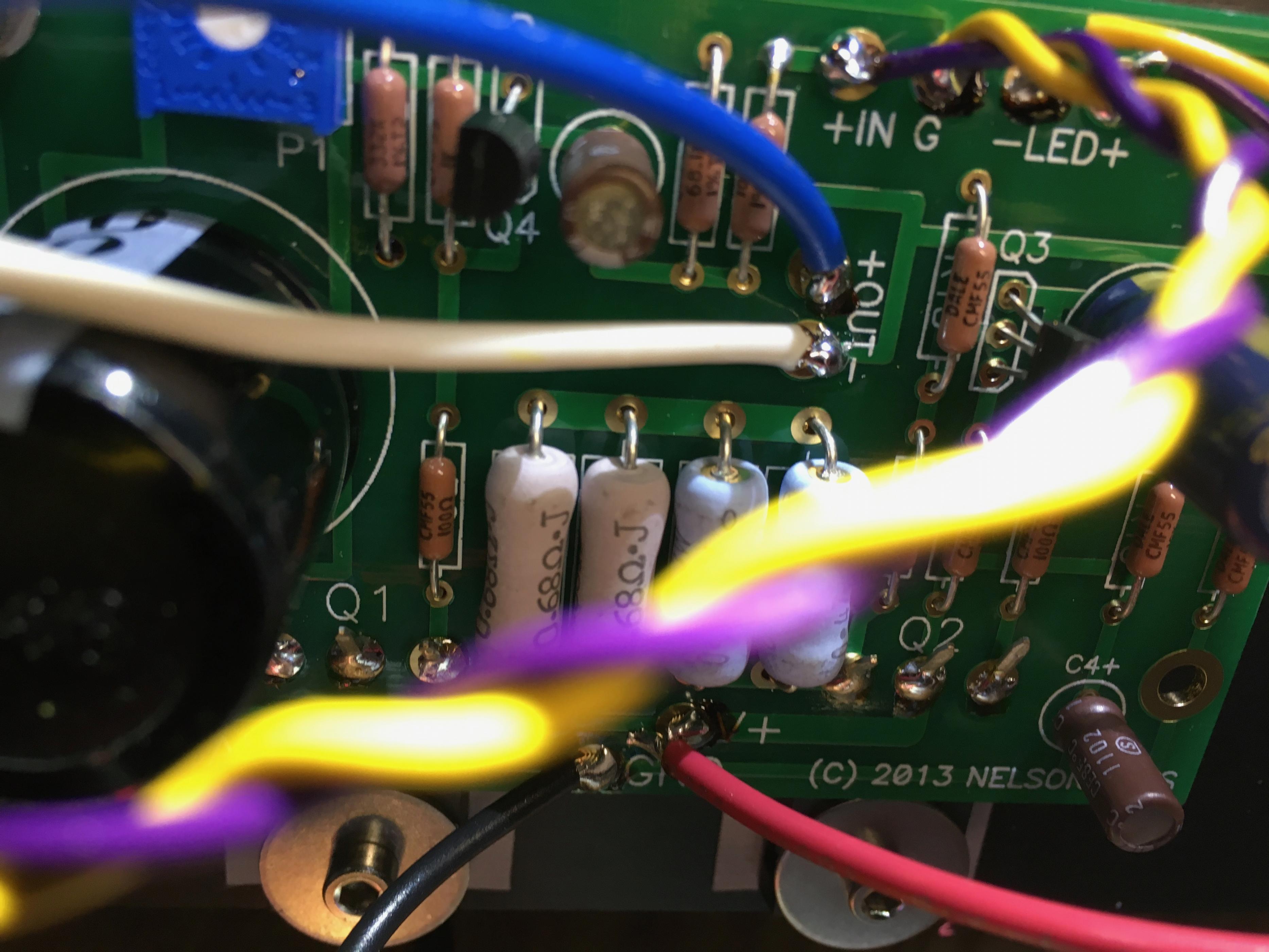

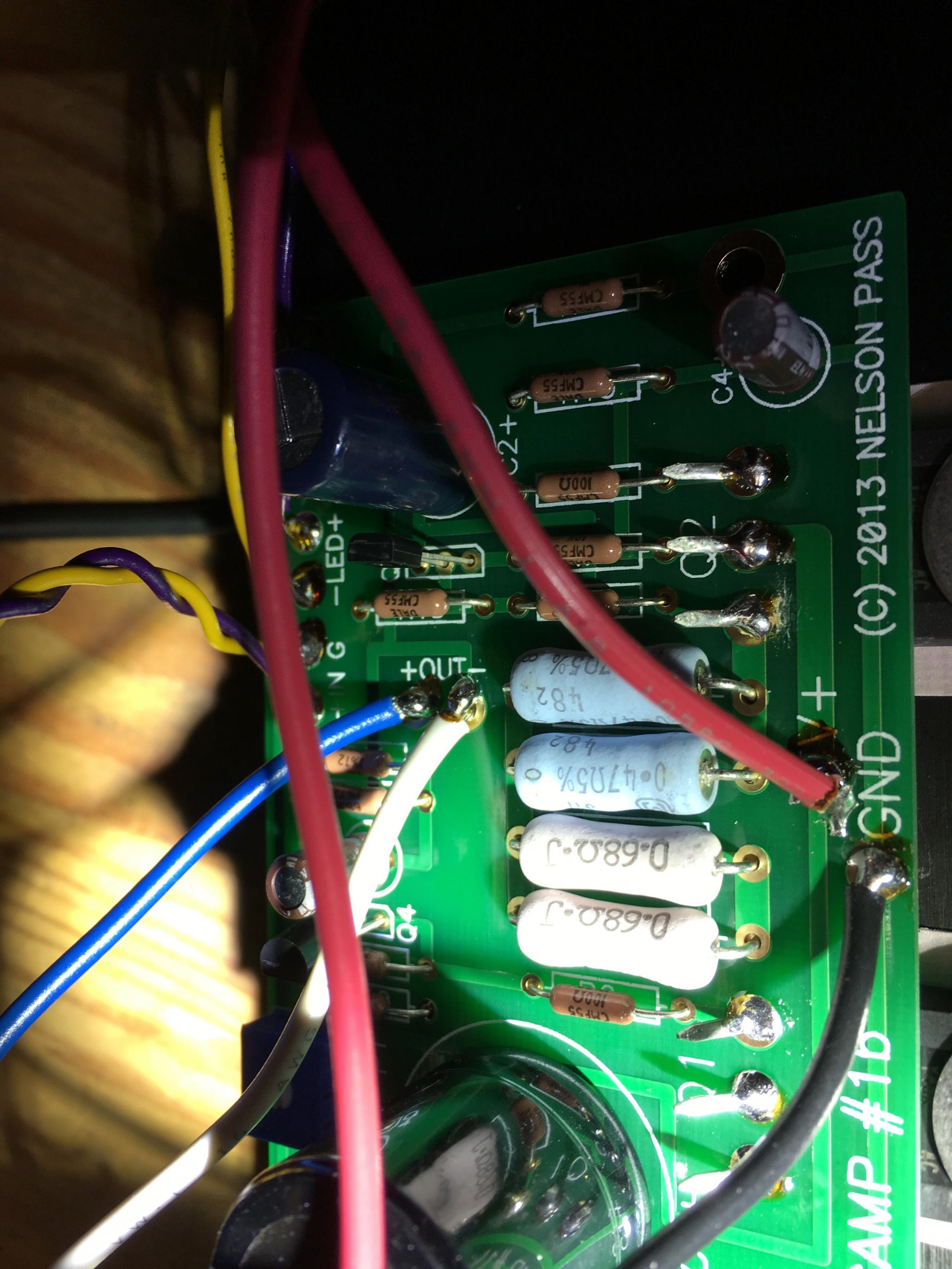

I have checked the PCB and all the grounds (input signal, output signal, and power) are connected on the PCB as well as the standoff pads. Is there any reason to make all those connections? I'm inclined to run a 14 gauge wire to the power ground and connect that and the others at an adjacent terminal block. Am I missing something?

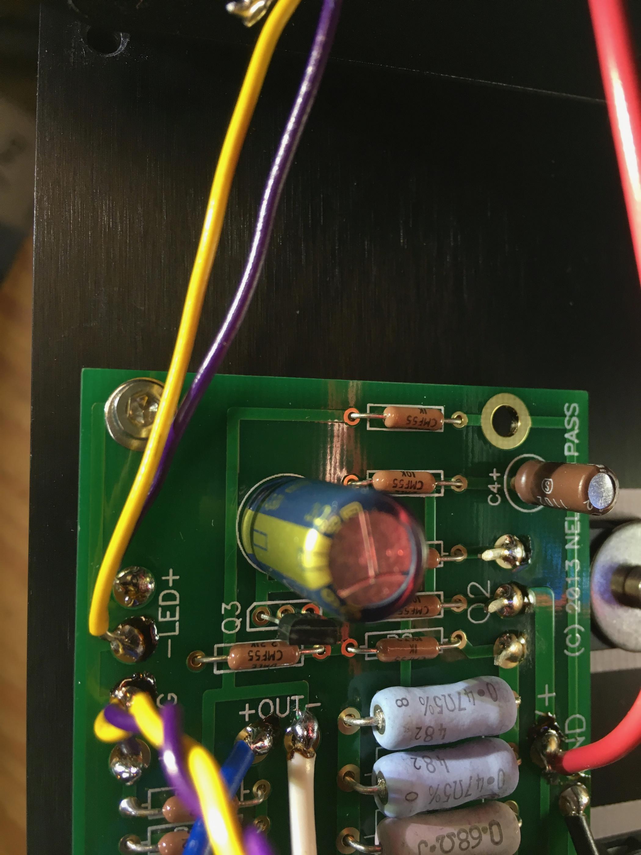

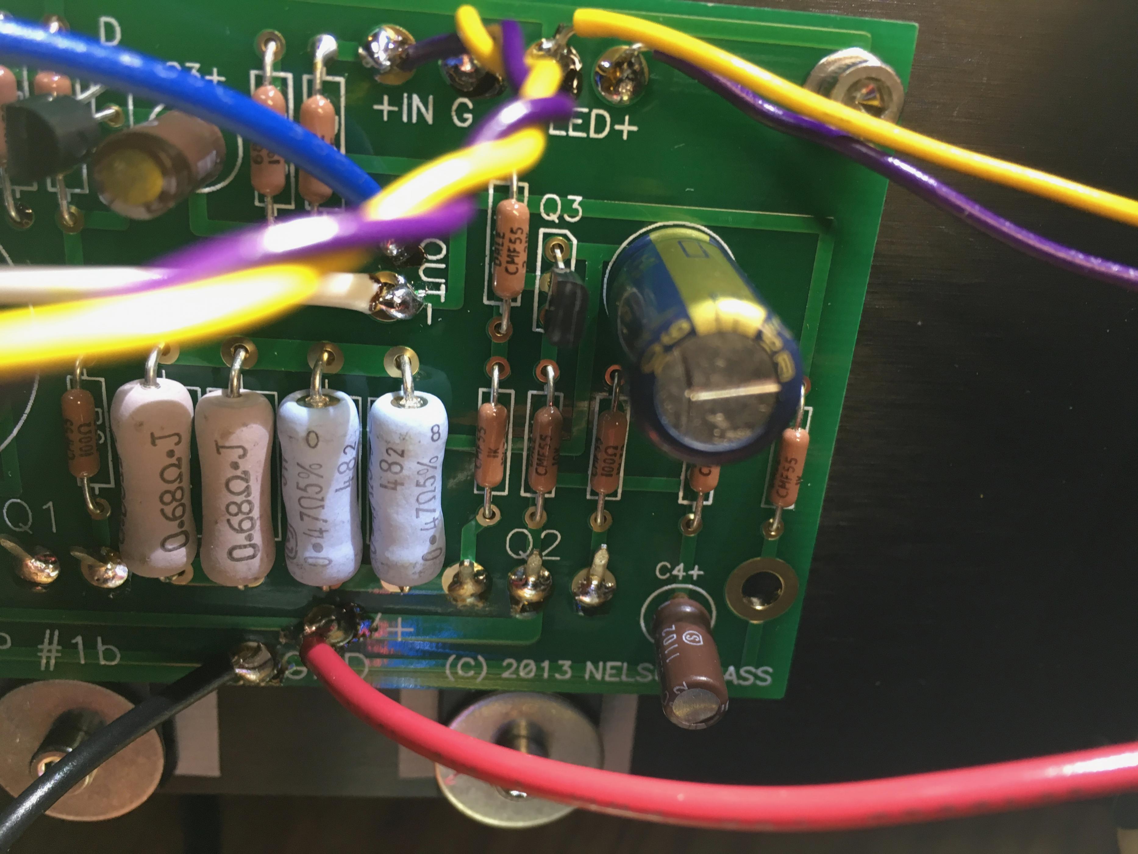

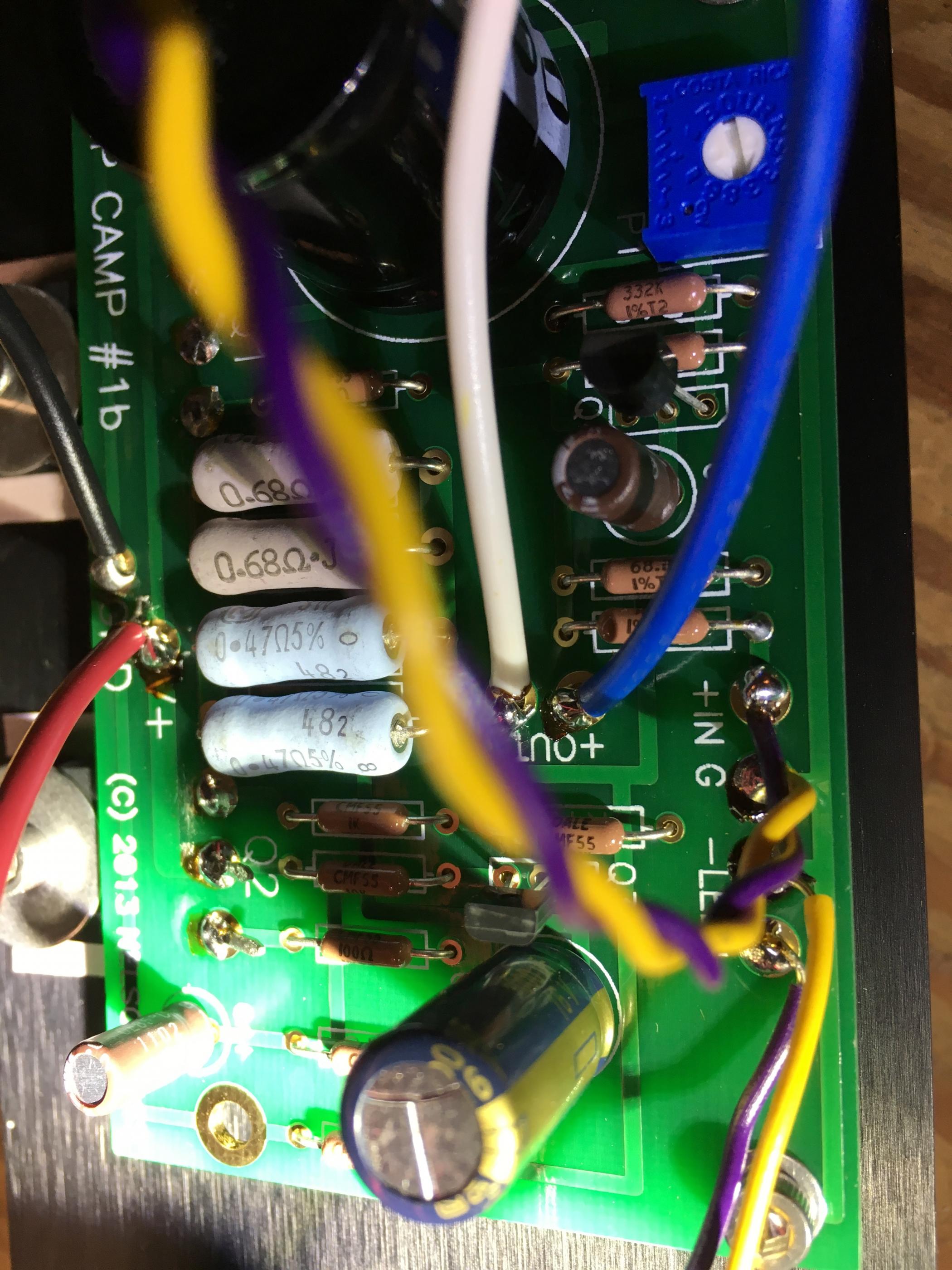

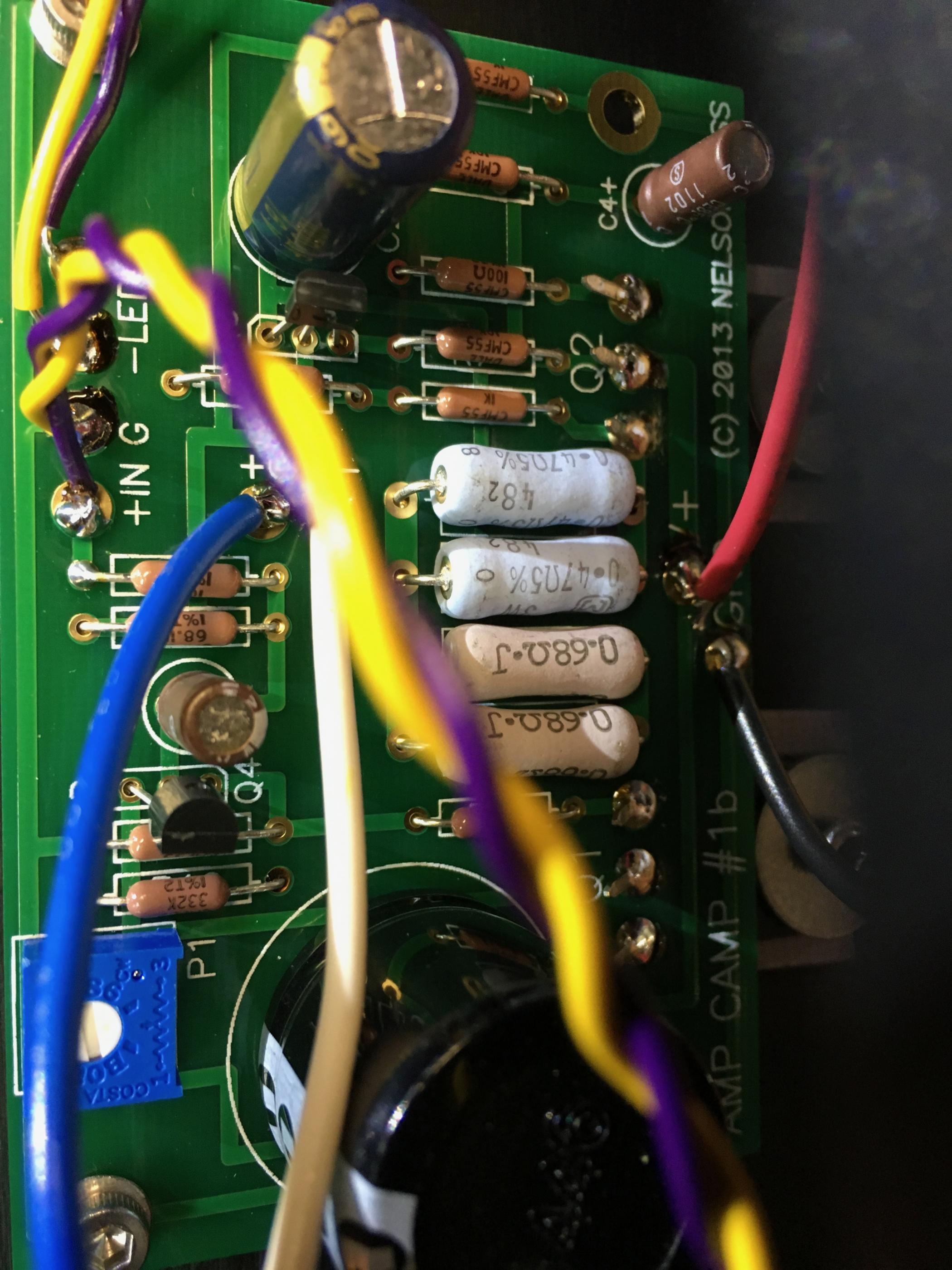

ACA Trouble Shooting for a newby please!
Long time audiophile, first time I have ever built something on my own. Minimal practical knowledge, but I can follow instructions and am decent with a soldering iron.
> Built the first ACA, sounds terrific, no problems.
> Built the second, sounds good for 5-10 seconds, then volume drops off a cliff and output becomes very distorted, regardless of source. Gently tapping internal wires or chassis gets a blip of added, staticky distortion.
> Checked all solder joints, everything looks good
> only thing I have found out of order is this: when I test ground and Q1 center pin, DC is 10.2V or so, then takes off to 14, even 15VDC!
Not a clue what to do from here. Any help greatly appreciated.
Thanks Zen Mod
soldering , parts placement and orientation , no contact between mosfet case (center pin!) and heatsink , mosfet properly tightened
Snugged up the MOSFETs (no improvement) and everything else looks good to me.
If these photos don't reveal anything, happy to take more.

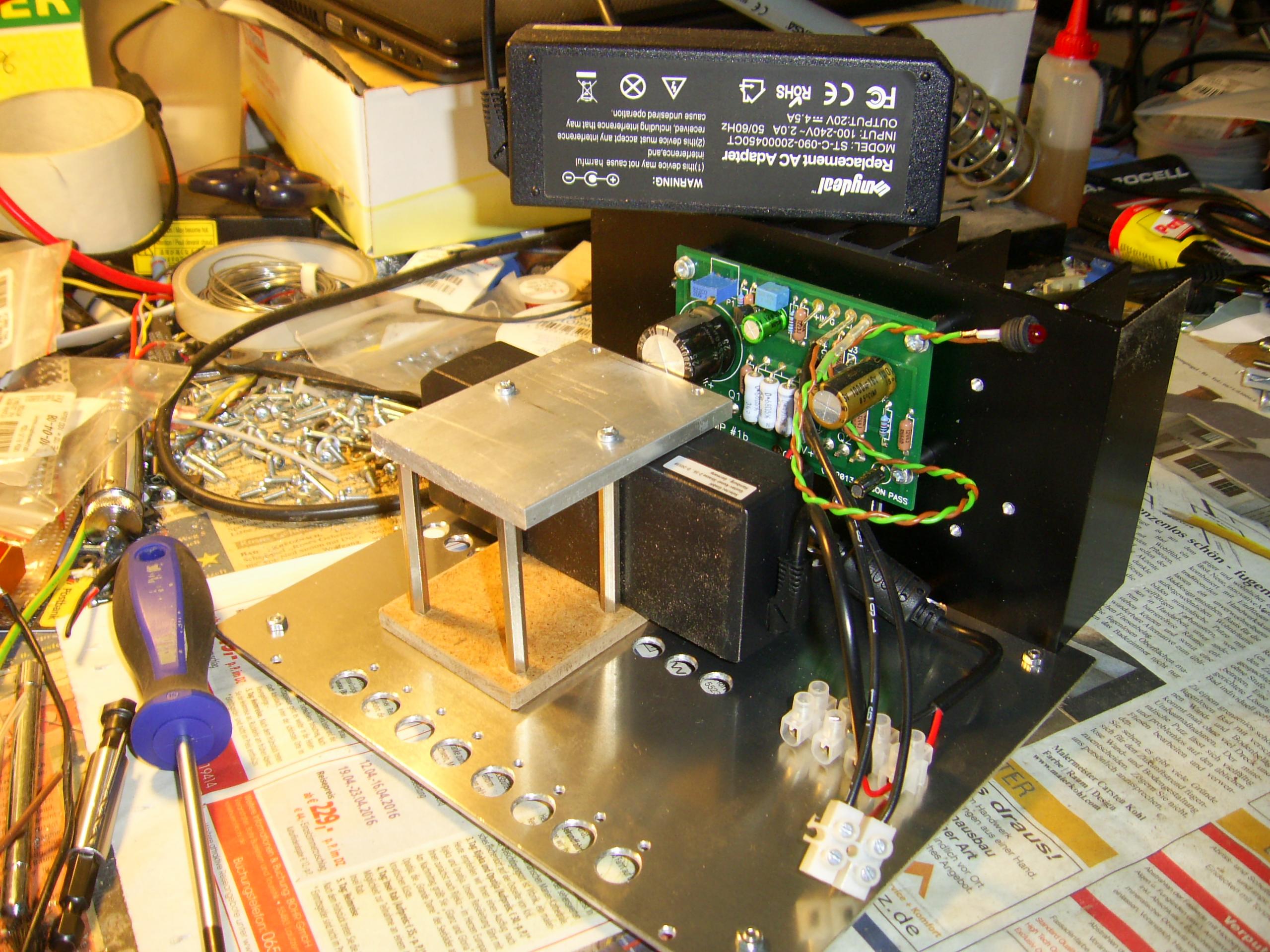

more heat needed
Hi Hemi.
For my soldering i use Ersa Multitip 25W.
The gold plated points needing a bit more time heat up and than the solder you
can see flow/melting and fills the hole and surrounding the wires - double sided board.
Take time- not overheating parts- single point soldering careful.
Hope you can fix all for better result and will work than.
So looks my last soldered board- is tested and worked without trouble.
