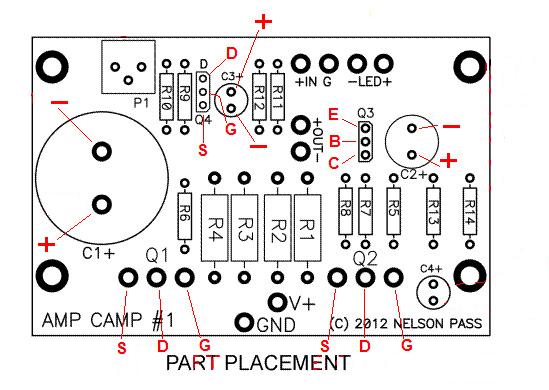

I have attached a pic to identify the names of the transistor terminals where I would like you to measure Voltages. The capacitor polarities are shown just so you can double check them.

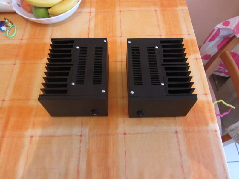

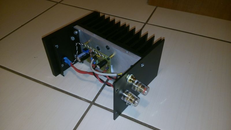

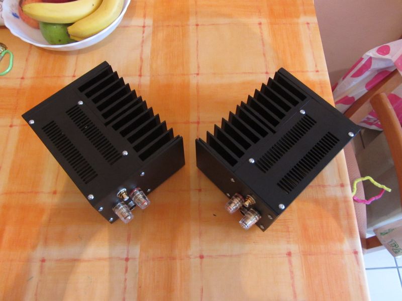

Nice and compact build. But that is going to run hotter than a whorehouse on nickel night. Have some fans ready to be installed. I found that 2kg of heatsink per block is enough.
This is fairly normal for this circuit. C2 charges up slowly through R7 until eventually Q2 starts to conduct. When Q2 is conducting enough current, Q3 turns on and holds the current at that level. However in a normally operating amp, this process should take about 10 seconds.
I will definitely do the measurements the day after tomorrow when from an easter trip and report here.
Total weight per monoblock is 4,5 kg. I can hold my hand on heatsinks as long as i want after 5h of work. Heatsinks are termally coupled with 10mm Al plate, and with front and side being 10mm thick as well the entire enclosure act as heatsink.
Here are the measurements on the faulty biard with a 19V SMPS.
Btw, I heve already installed the 2.21K mod.
Something seems wrong around R6. The Source of Q4 is 4.6V connected to one end of R6 but the Gate of Q1 connected to the other end is 0V. Normally the current flow through R6 is so small it can be ignored. Either R6 is defective or there is a break in the track on the PCB somewhere. With the power off measure the Ohms between the Source of Q4 and the Gate of Q1. It should read 100 Ohms +/- a few percent.
