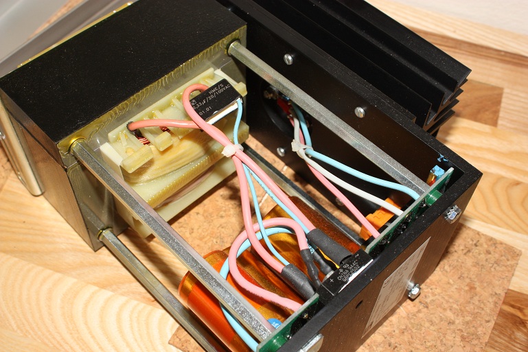

19V single ended for 5W...![]()
ahh
been looking at this regulated power supply, not knowing what to do with it
a friend dropped it on my doorstep
0-24V, 10A
