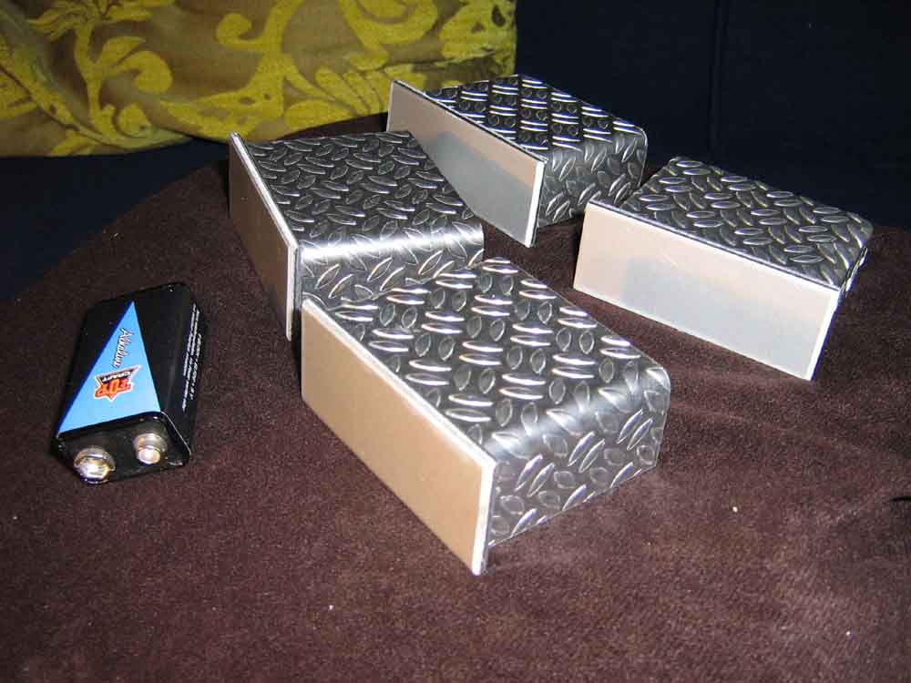

About the cooling contact, I got a piece of a sort of silicon coated cloth to put between the chip and case. Don't know what it's called, but it is
at least non-toxic.
The silicon coated cloth might not be electrically insulating. I had some and found out th hard way it was not, although it was sold as such.
Having said that, my own amp3 has the chip mounted to the case (inside a copper tube) with no insulation. The output minus needs to be insulated as well
I didn't even think it was a problem with TA2021B to connect the heatslug to ground...I thought it was a 'not connected' part of the chip...
Anyways, my amps work fine (even with the first one I built, where I used heat conductive paste..)
What's that copper tube thing? Pictures?
P.S. Even at the torturing levels and on 4 ohm load the amp stayed reasonably cool (tested it for half an hour).

v-bro said:I didn't even think it was a problem with TA2021B to connect the heatslug to ground...I thought it was a 'not connected' part of the chip...
Oh, and correction: It's connected to ground....
