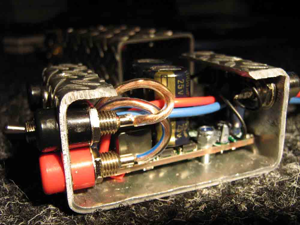

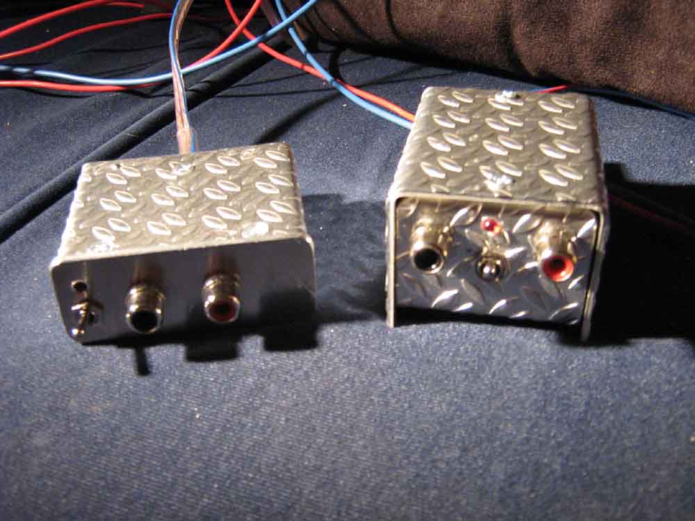

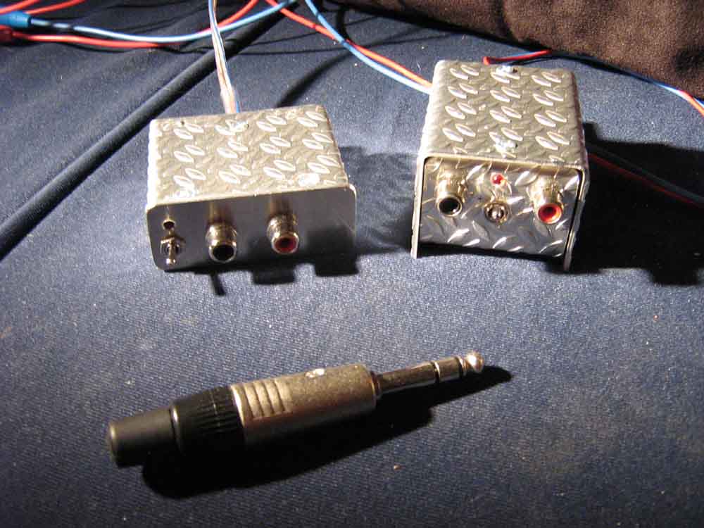

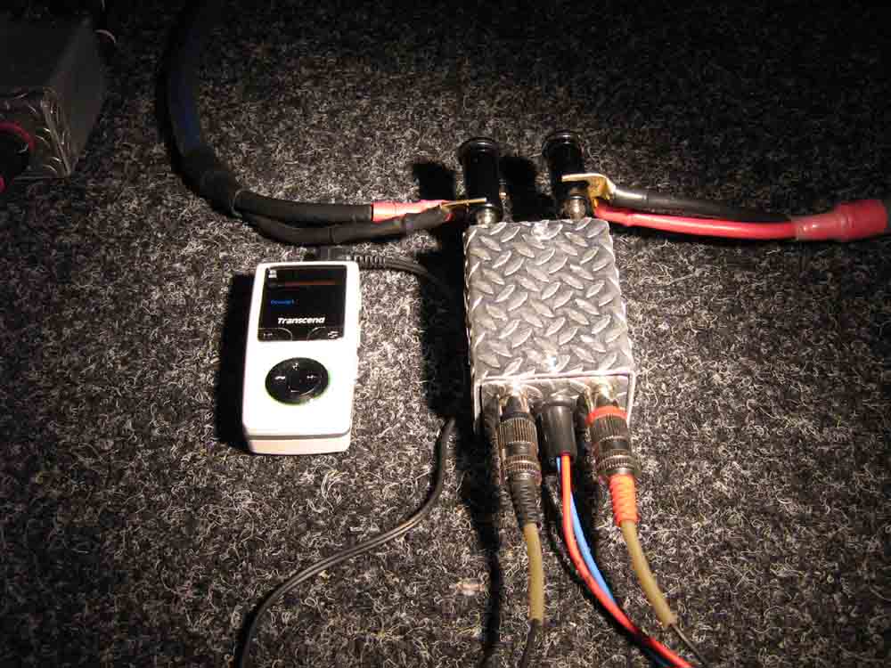

I encased another AMP32 (see pics) only the led doesn't get any power anymore. Must be something on the board, there is simply no voltage on the pcb pads...
But it produces fine sounds....🙂

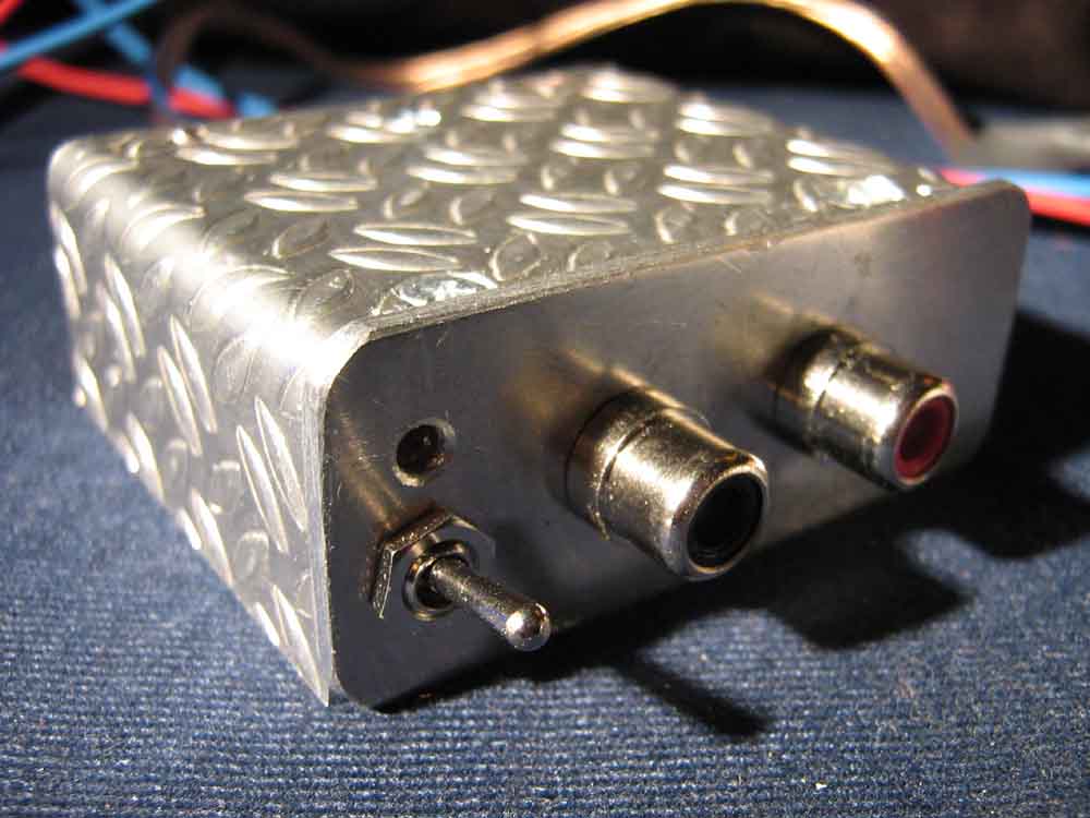

Here's a picture of it playing:
That is what you call efficient use of space. What differences have you found with the 1000uF caps instead of the stock ones? I might have to try that mod.
Regarding your problems, I have no idea. I would hazard a guess that something shorted somewhere, possibly on your case. Take it out and go back over everything.
Check the diodes, maybe one of them went bad, that could help explain why you aren't getting any voltage. Or if you are using a switch, check the soldering on it. Mine stopped working, but it turns out one of the wires broke off my switch. I got really scared i shorted my amp somehow. My LED never worked in the stock position, I soldered it to the open hole in J3 but it never lit up. I had to wire it with a resistor to my power supply input for it to even function.
Also, you might need a heatsink, even though your chip is pushed against the case, it is diamond plate and thus not flat not giving adequate cooling contact. Thermal grease would help, but that is only for when you get the amp running again and at this point is the least of your worries.

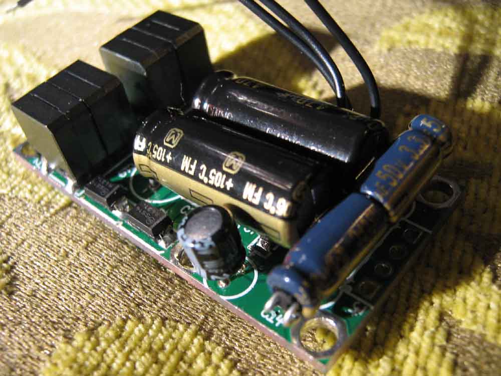

I had a lot of trouble with the last one, but got it working at last, the soldering on the chip gave problems. When I tightened the screws it failed, than I had it working but it produced clicks from the speakers when I tapped on the case. After I went over the soldering again it worked flawless...
About the cooling contact, I got a piece of a sort of silicon coated cloth to put between the chip and case. Don't know what it's called, but it is

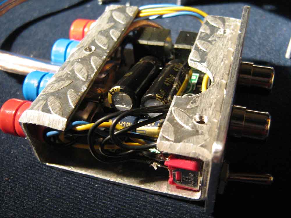

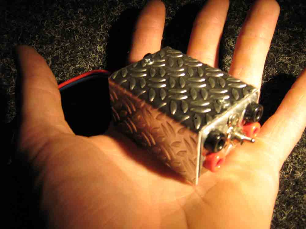

Here's a picture of one I made to fit into the smallest possible casing, I put the caps flat...

V-Bro,
Totally cool and I am very impressed by your creation.
Can you compare the sound of this small cutie to other D-amps?

I gave another demonstration at work with the little gem connected to two community subwoofers parallelled with granite tops, soon the room filled with people the one more stunned than the other! The sound pressure level went up so high people had to shout in eachothers ears!
The little gem connected to a lab power supply set to 14 volts.. the consumption meter went up to 2.5A on the beat!
Really high levels can be achieved within reasonable distortion level, absolutely amazing! Offcourse this had nothing to do with hifi...😉
The sound pressure levels in my room on my own speakers are lower, but paid back twice in quality offcourse....
