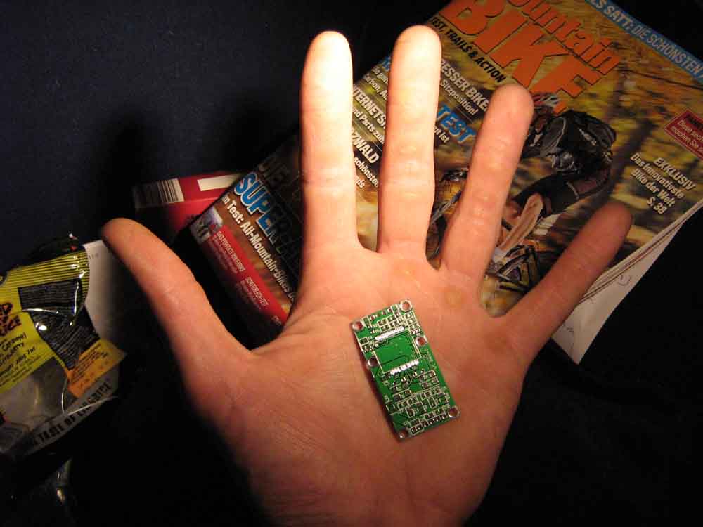

Just finished the first AMP32 I ever built, and it is working! Yeeeeehaaaa!
It's still in the test and burn-in period offcourse, but I can hear some really coherent sound coming from the little speakers. They try to keep up with the kickass bass signal from the little cute one...😛
Oh yes, one very important note on component mounting following order, don't place the 330uF caps before you placed the toroids!!
My Weller WTCP-S with standard solder tip didn't fit inbetween the toroids so I had to remove C18 before I could solder the last paw...
Unfortunately I damaged the cap in the process...

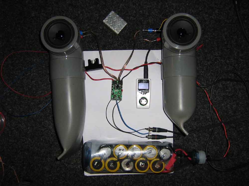

in my amp32, I'm using three 3.7V 2.4Ah Li-ION cells from a canniballized laptop in series to get 11.1V (12.6V fully charged) and it lasts about two to three days blasting at full volume 🙂
imagine when I use the other cells wired at 11.1V 7.2Ah!

In regards to the Li-Ion pack, as far as I know we are a few of the early adopters for using it for an amp.
Did you get the protection PCB? If not you should order one, and while you are at it get the "fuel gauge" which shows you the charge state of the battery.
check it out at
www.batteryspace.com look under li-ion cells, and you should find a link for them, or click on a cell and it should have a link near the bottom. You can see what it looks like hooked up on my battery. I shrinkwrapped it in clear to protect it and then silicone glued it to the outside.
It helps prevent overcharging and shuts off if the voltage drops too low.
Yeah my 4800mah li-ion pack runs for days at full blast. I usually have to charge it once every couple of weeks. It has 4 cells so I had to use an Lm317T, now it spits out 14.15v instead of the chip blowing 16.8 at full charge and yes... I have blown out an Amp 6 running unregulated. The battery blew a .25 inch hole in the chip (which I kept as a souvenir to my stupidity).

unfortunately, I got my cells from a laptop with a broken motherboard.
I now have twelve 2400mAh 3.7V cells. three wired in series for a smaller pack giving 11.1V at 2400mAh and when I need longer run times, I use the other nine wired in series-parallel for 11.1V at 7200mAh.
I made a charger from basic components since all other charge controllers on the net use a dedicated IC for that. I found a datasheet showing how to properly charge Li-ION cells and found out how important it is to follow the four step process.
the nine cell battery packs quite a capacity that I still haven't discharged it halfway ever since I took it out of the laptop and fully charged it once.
