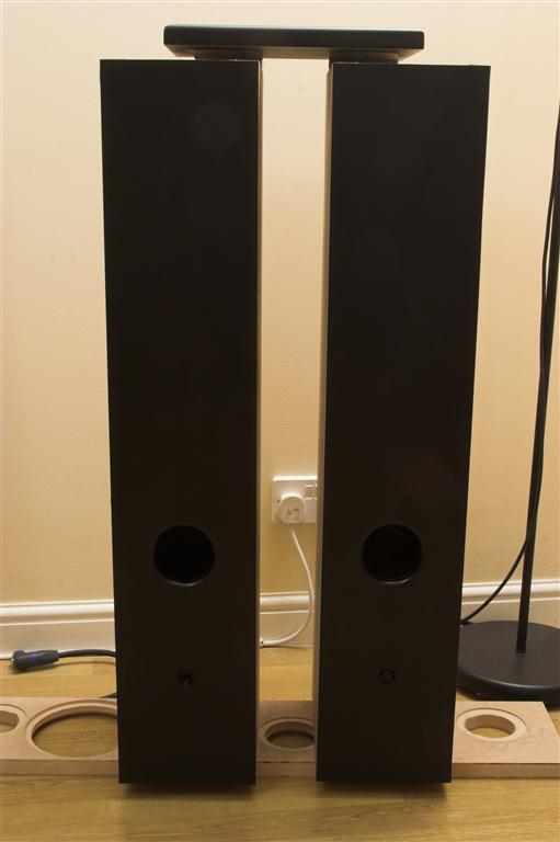

Keeping things moving along

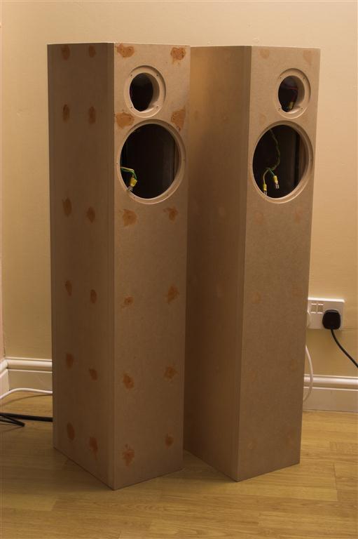

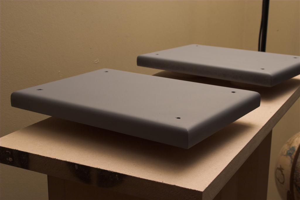

Whilst there haven't been any updates for a week or so things have been moving along. After enjoying listening to the Amish for a couple of weeks I have now filled all the screw holes and these have been sanded down as shown in the pictures below. I have also been painting the plinths, using halfords spray primer to get things started.

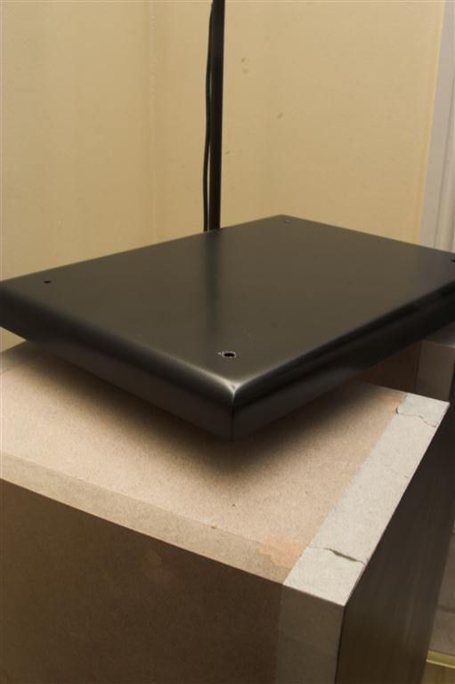

I applied two layers of primer then left overnight to harden, before sanding down and applying another couple of coats. These were again left overnight before the first couple of coats of satin black went on. As it was being applied it is very glossy and looked pretty good. When they dried they were exactly as I hoped they would turn out.
As with all things it this is not a strightforward process and I discovered that the edges were not as smooth as I would have liked. So they have been sanded back almost to the wood and the spraying has recommenced. I have attached photos of what they looked like before the sand down.
I'll be following a similar process with the back of the cabinets, though i am going to be less critical with these as I don't really expect people to be paying that much attention.

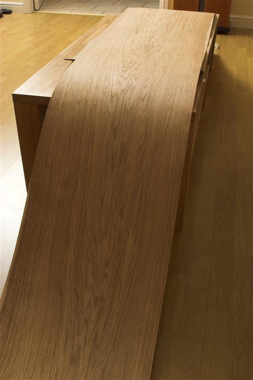

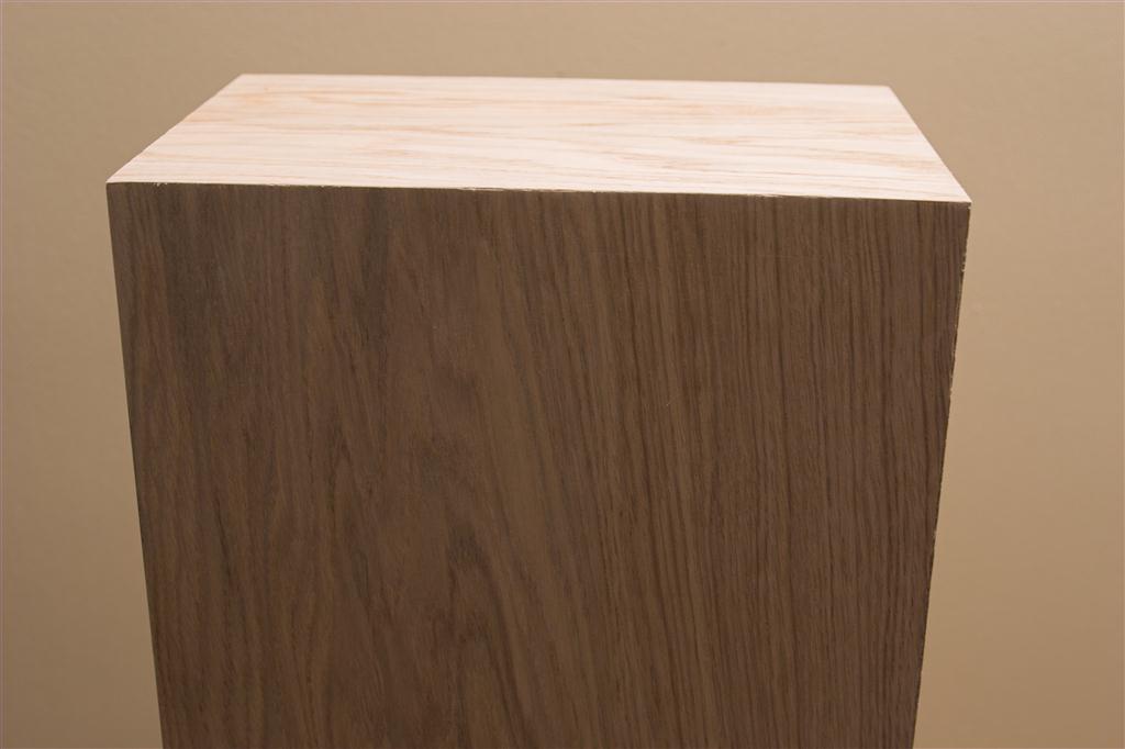

The final update of the night is the fact that my veneer has arrived! Very exciting... so I rolled it out to get a couple of photos of the beautiful european oak (crown cut) and I am not quite scared. 😱 It is very thin and very delicate easily splitting at the edges, so I am hoping I have plenty spare. To attach it to the cabinets I got an iron on glue film, which looks fairly strightforward, so I am hoping I can get that bit right at least!
If this works out as I hope then these are going to look gorgeous even if I do say so myself!

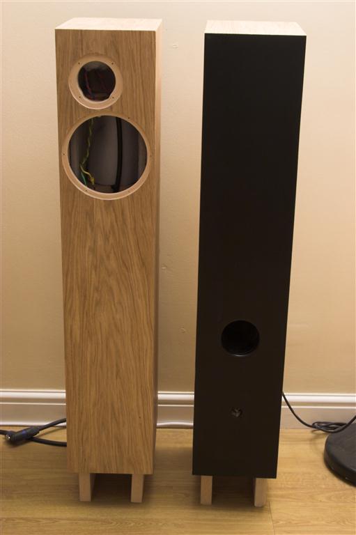

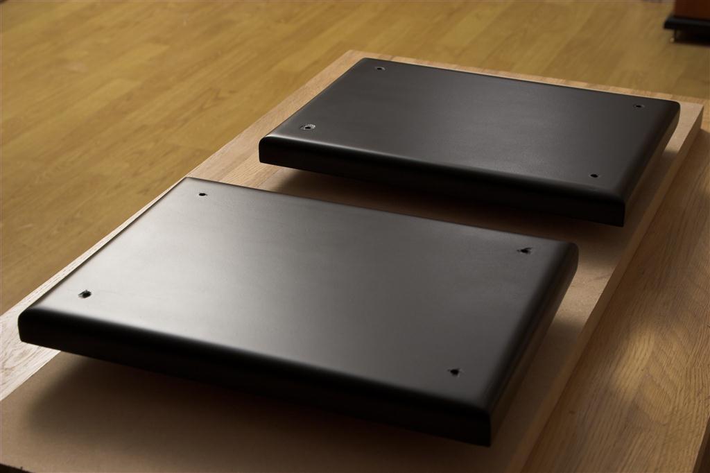

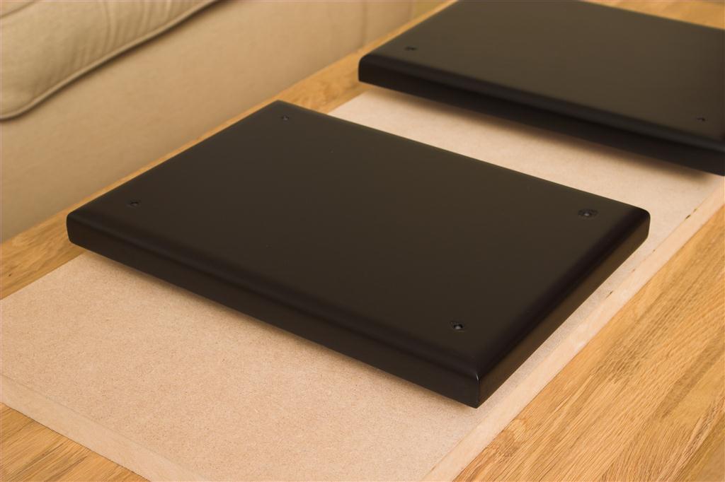

More spraying has been done and now the backs of the speakers are looking good. They'll get another couple of coats tomorrow night. And I have a final plinth... just the one as there was a bit of an issue whilst I sanded back the other one to get the edges smooth and the paint is not taking. So I am going to have to do a lot more work with that, but not to worry.
As well as the cabinets and the plinths the crossover box is going to get the same treatment so that it fits (looks) better in my TV unit.

You mention an iron on glue film for the veneer, do you mean a coat of Titebond glue?
Its not tightbond as far as I am aware. It comes in a large sheet with a paper back. You lay it over the piece to be veneered and with a warm iron you attach it to the work piece. It is then trimmed at the edges and the paper back removed. Then the veneer is placed onto the work piece and using the paper back from the glue as a protective layer a hot iron is run over the veneer and it is pressed onto the work piece (so it is like having iron on veneer, but you have to put the glue on yourself! 🙄)

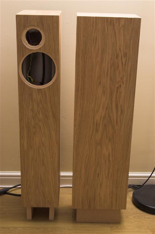

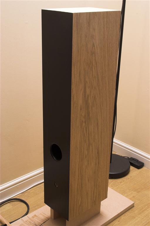

It has been very hard work as the glue film is not the easiest material to work with if you haven’t sealed the MDF with watered down PVA glue first. Once I got the hang of it things moved along, however, the veneer is very brittle and there is some minor filling to do in places. The hard part is going to be getting the holes cut out for the drivers due to the way the veneer splinters and there is only a thin section between the woofer and the tweeter. I have therefore, rightly or wrongly, decided to varnish this area now to help strengthen the veneer such that I can either cut or route out the holes neatly. It makes me very nervous, but I am sure it will be worth it judging by the way they look.
As you rightly say, the other furniture may be problematic with being waxed, lots of sanding required. I might give that a miss and choose a less time consuming hobby, like building starships (since you seem to be going with a Star Trek theme at the moment). 😛

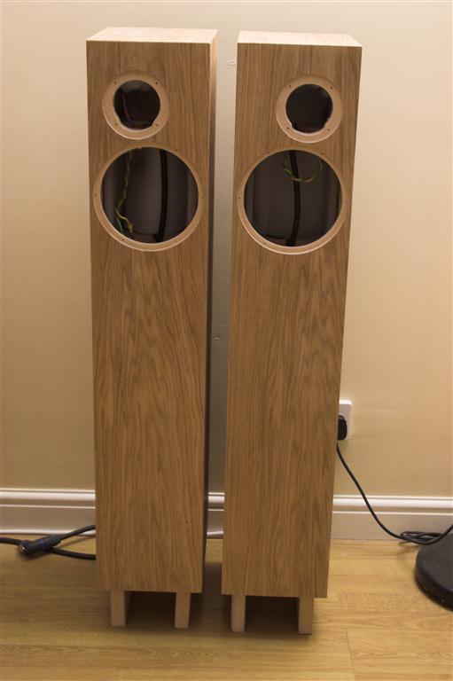

Well, they are starting to look reay good now... until you get close and inspect the edges! 😱

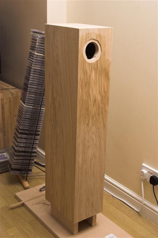

I have managed to get all the driver holes cut out and sanded back, which was a challenge where the veneer was more textured as they had a tendency to split or splinter. Still with a bit of sanding and using little fillets of veneer I managed to tidy them up a little. I'll get some wood filler at some point and make a better job of it.

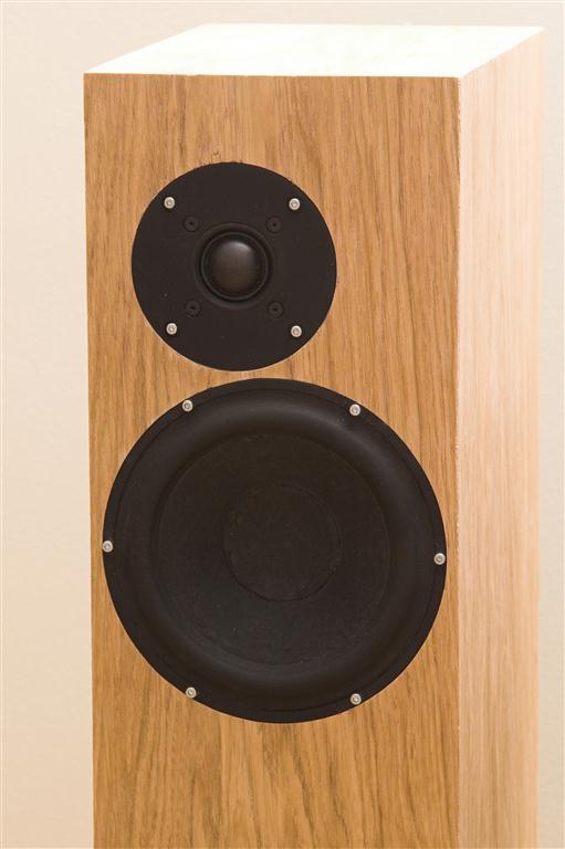

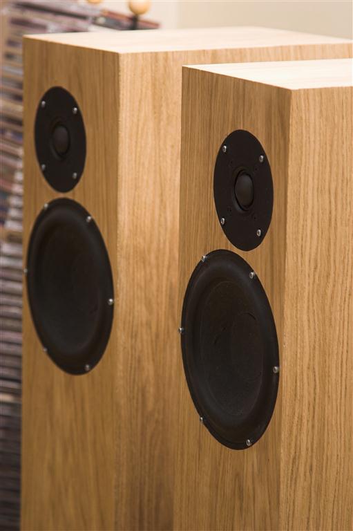

They have had a few coats of satin varnish now which has brought out the grain nicely and makes me feel a little happier knowing that they are less likely to get damaged now. Whilst I feel I have learned a lot with the veneering I will think twice before doing it again... of course I have a tendency to forget how difficult things are pretty quickly 😀
Anyway, a couple more photos. Later I'll have some with the drive units fitted and then I can sit back, relax and enjoy them again.

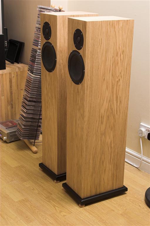

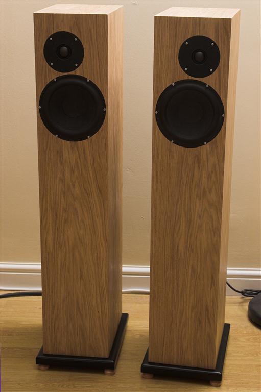

Well, here they are, drive units fitted and onto their plinths... I think they look gorgeous, but then I have just slaved over them, so I am biased! So was it worth it?
Need I say more?
Need I say more?
Definately worth it! Very nice pair of speakers. As I am reading your thread I am listening to my own pair of 8545K's and I am sure you will be as pleased with them as I am.

Ole, thanks for the comments! Yes I am pleased, they sound great, Troels is to be commended on his design and Scan Speak for making such great drivers. I can see why the 8545 was the mid-range favorite for a long time. The 9700 is also sublime and handles cymbals and hi-hats so well.

Beautiful work Ian! I bet they sound terrific!
One question though... Where did the crossover go?
In the picture of the whole system there is a black box in the bottom left hand side, that is the crossover. 🙂
