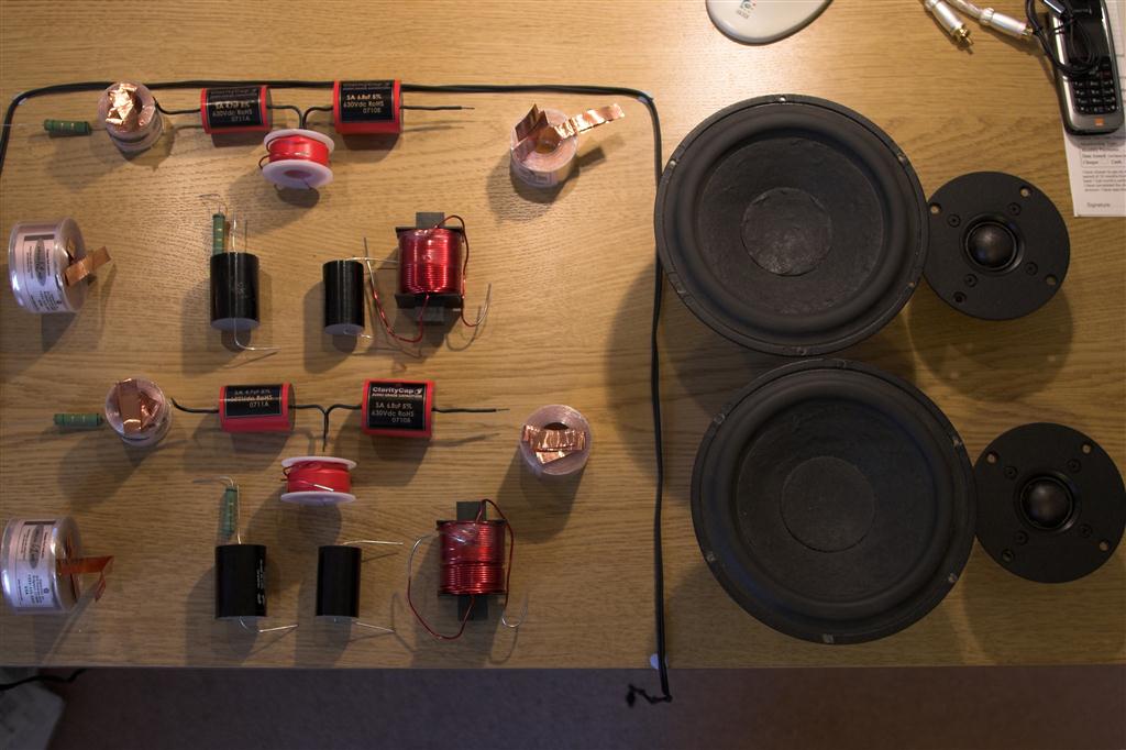

So with drive units purchased, it was time to aquire some cross-over components. This proved difficult to get exactly what I wanted in the UK and during my time searching the Amish project was updated by Troel's to provide a parallel crossover design specifically for the 9700... which was a bonus. I decided to bite the bullet and order my parts from Madisound and have them shipped over, knowing I would get stung for import duty, but it still worked out considerably cheaper than my other searches.
The picture below show the components all laid out in their glory, well bar a couple of resistors that had to be sourced from elsewhere.

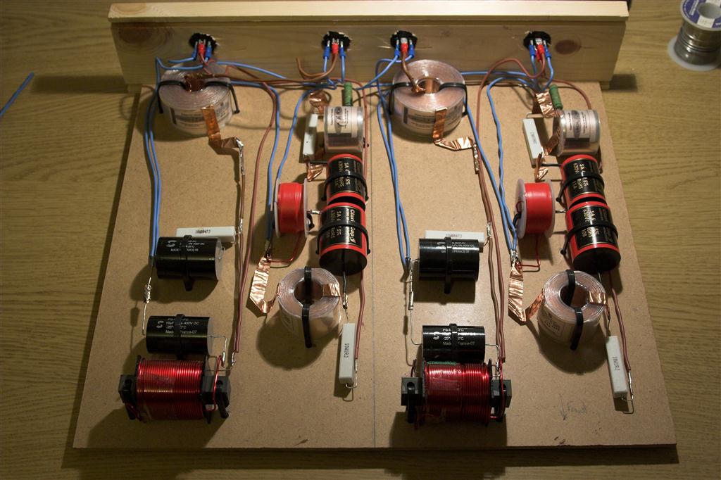

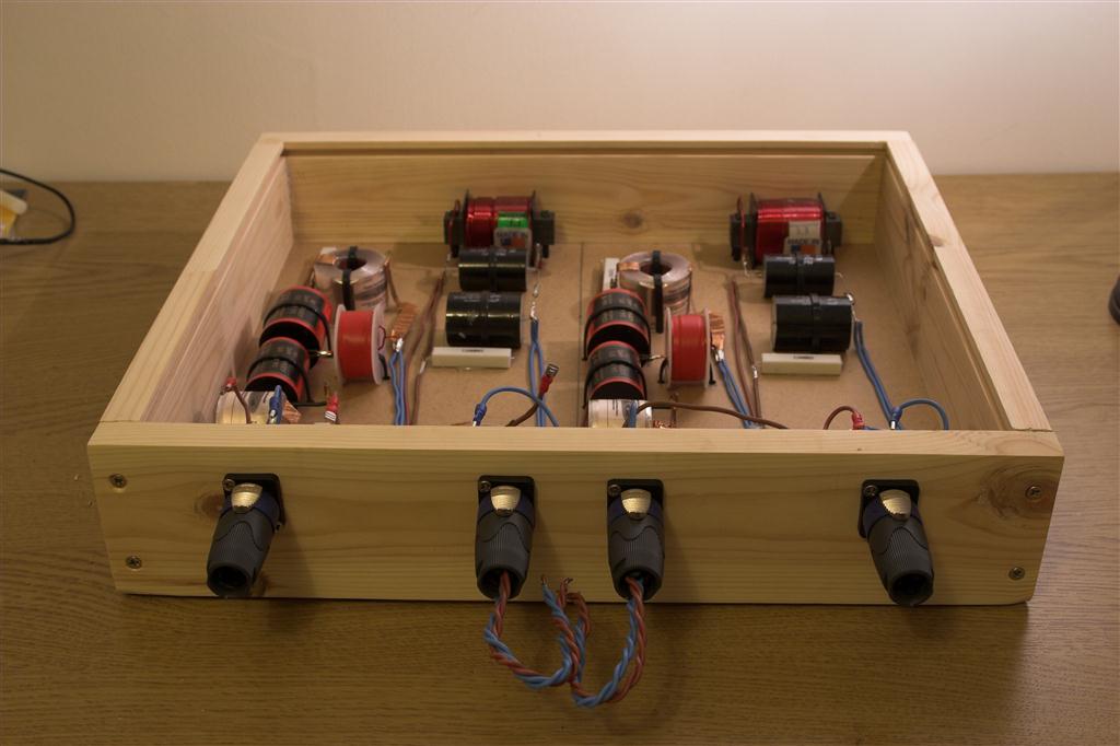

As I was waiting to collect sheet material and the table saw I figured I would kick off with the crossover now that I had all the parts. I decided due to the size of the coils and caps that I would build a separate cabinet for the crossover network. This would then fit neatly into the rack with the rest of my hi-fi and hopefully make a good talking point. Having spent some time working with pro-audio gear I have become very fond of the Speakon connectors as they support large cables, have four (or eight) pins and are very secure. This made them an ideal choice for the links in and out of the crossover as I mean I could keep the cable count down to single runs of 4-core cable, thus supporting bi-wire / bi-amping on the input side and obviously the split of low and high frequency signals to the speakers themselves. I’ve opted to fit these to the cabinets as well and to ensure that it is all neat and tidy I have a pair of right angle versions of the plugs.
The pictures show the crossover when I was initially constructing it and nearing completion, it needs the lid fitting and the box given some form of exterior treatment.

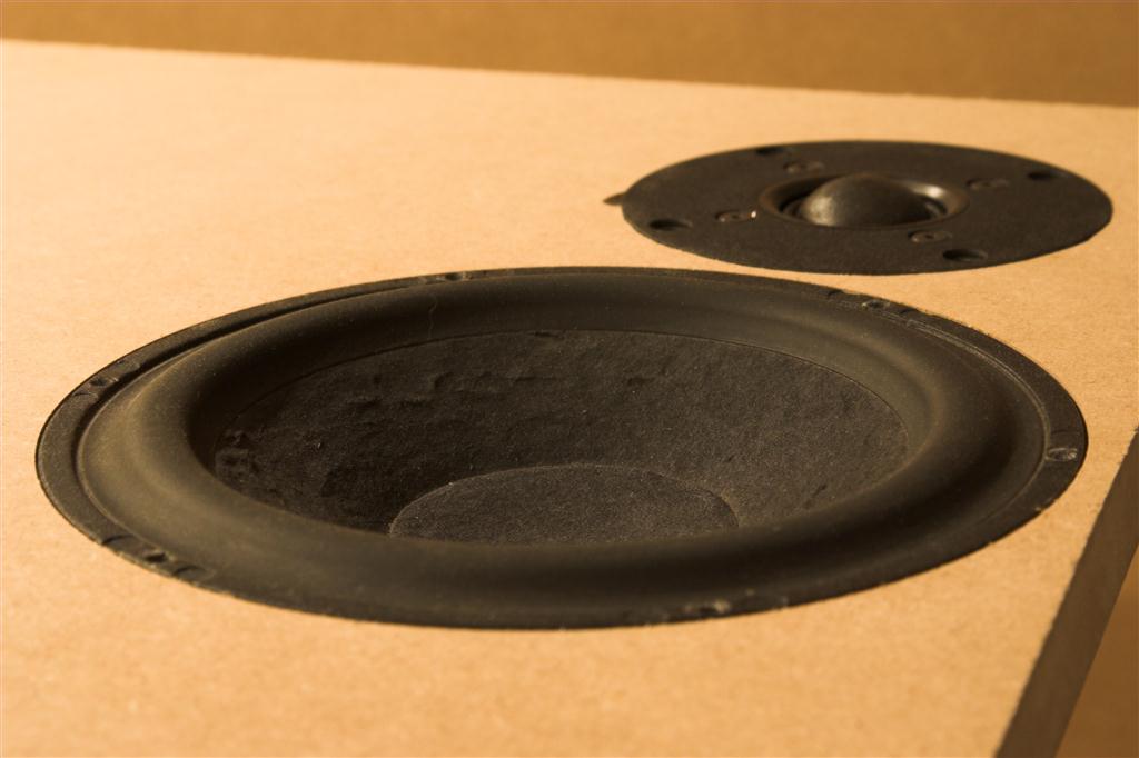

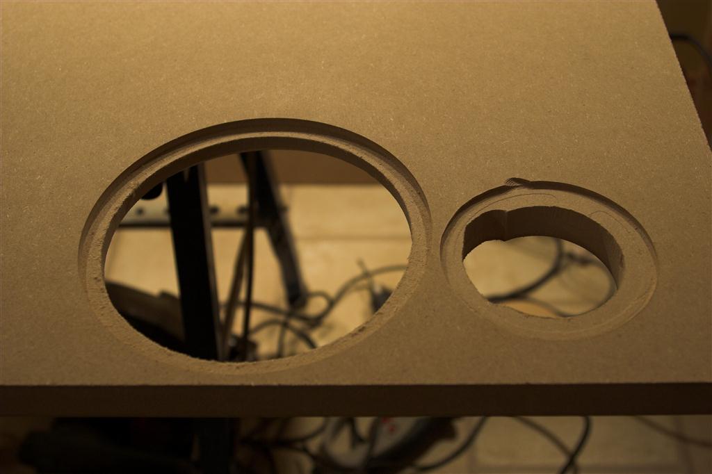

So with the jig built it was time to get some practice in and see how they work out. Things seemed to go pretty well with the first tweeter cut out, getting a good depth for the rebate and a clean circle. Unfortunately the hole was about 1mm too small, so I had a go at free hand cutting to open it up, which worked ok (not the tidiest job) and then I managed to nick the edge whilst taking a segment out of the actual through hole. DOH! 😱

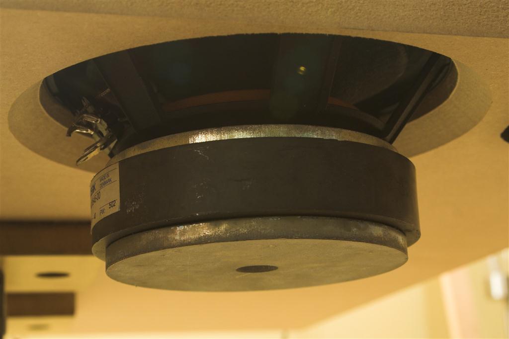

The woofer cut-out went according to plan and the depth of cut was spot on. So not a bad start really and it gives me a good idea of what these are going to look like.

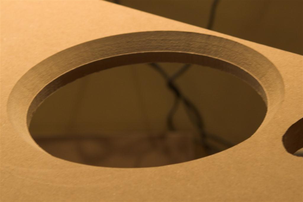

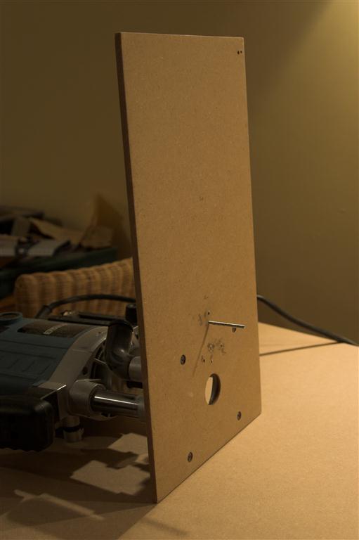

With a woofer hole cut it was time to try a chamfering tool, exciting stuff! I should thank Aldi at this point for my router bit set which cost me something like £7 and has 12 pieces in it. This process is thankfully fairly idiot proof and I love how neatly it looks when it’s finished. Shame there is only two of these as I could chamfer holes all day… and not that’s not a euphemism for something else!

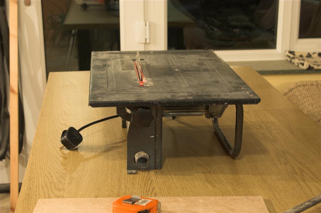

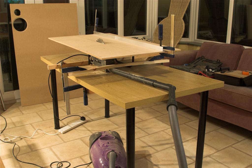

My next challenge is making some modifications to the table saw that a friend lent me to make it large enough to cut the MDF sheets I have sufficiently accurate for the cabinets to have a goof fit without lots of trimming and sanding. The top plate currently only allows for cuts 200mm wide, so to extend this out a sheet of 12mm MDF will bit fitted to the top with the blade slot routed out. A datum line can then be drawn where the blade protrudes such that it gives a reference point from which to measure. As a guide I’ll be using L shaped aluminium extrusion, which will be clamped to the “new” table top. So basically I have a project within my project!
Fingers crossed I can get this knocked up tonight and a few test cuts made, such that I can report good news… and hopefully there will be no loss of digits along the way!

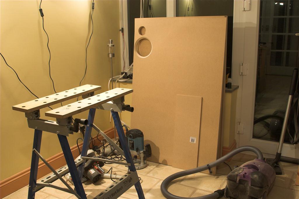

Well, the good news is that I still have all my digits today! The other good news is that I managed to achieve my aim of extending the table saw and even got as far as getting my test piece through.
Of course there were lessons to be learnt along the way, such as manhandling a 1.2m x .8m x 25mm sheet of MDF by one’s self and running it through a relatively small table saw is not without challenges. It was when I was halfway through cutting the sheet when it occurred to me that I was going to run into an issue when I got to the end of the cut in the fact that I could easily end up dropping the pieces (more stuff than hands). It’s incredible how a quickly spinning saw blade focuses the mind and I managed to gentle get both out of the way without incident.
The second lesson was the 9mm (I was going to use 12mm, but had a last minute change of heart) extended table top does have some flex in it when faced with the large sheets I am cutting. Tonight I am going to add legs to each corner of the table to reduce the flex and improve the amount of support that the table provides to the work piece. This will have the added bonus of making the cuts a bit cleaner. I may also use my other workbench to provide a supplementary support for the larger pieces.
What I was very pleased with is that using the aluminium extrusion to draw out a datum line has meant that the cuts are spot on the distance from this line, thus no fudge factor is required.
Below is a picture of my very messy temporary workshop!
The vacuum extraction is a bit hit and miss, it depends on the tool and which orientation you have that tool in. It works pretty well for the circular saw, table saw and the sander, not so good on the router, which makes the most mess! I had to empty the bag twice yesterday I made that much dust… thankfully I bought some dust masks as that MDF dust is not pleasant.

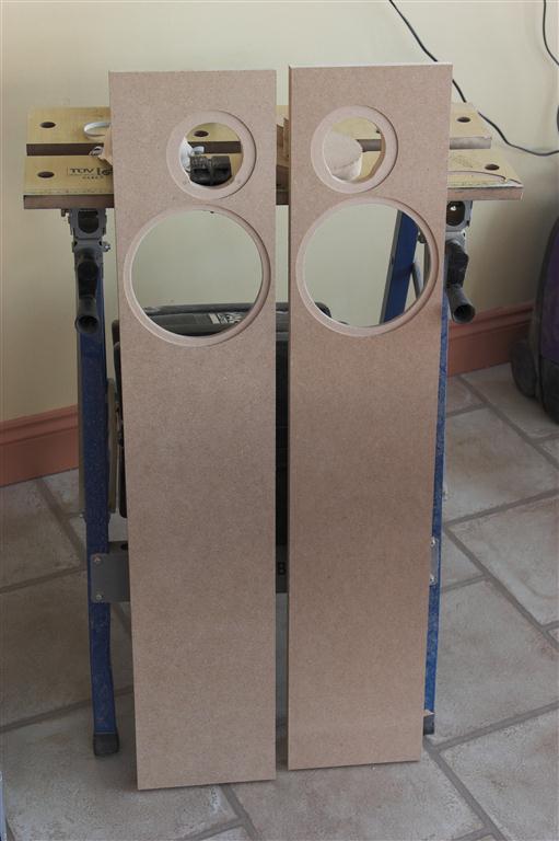

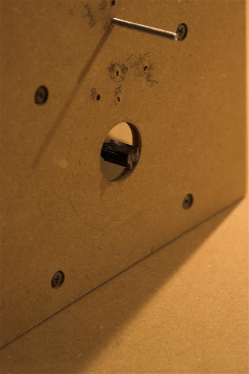

I have been banging my head against the wall trying to get the tweeter hole just right and I kept getting it about 1/2mm too small. So after 4 attempts to get the jig right I am finally happy with the results and can start on the actual front panels now. However, I did get some freehand practice with the router earlier and i can now make a much neater job of the notches in the tweeter hole.
The braces, tops and bottoms are all the right size and have now been cleaned up and chamfered (photos to follow), which means tomorrow I can get the pilot holes drilled and match panels up to give the best fit. Its all getting quite exciting now!

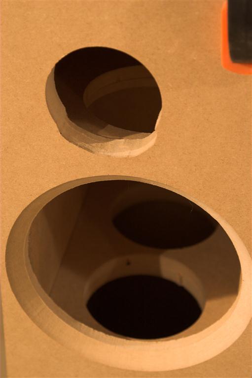

Friday night and Saturday proved to be very productive (sad I know, I should have been down the pub) 😱
Anyway, I got cracking with making sure the jig was just right for cutting the tweeter holes and then prepared both baffles, which thankfully turned out very nicely. As you can see in the photo the test piece took a battering, but it was worth it in the end.
Also shown are the braces all ready for installation.

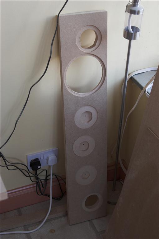

I got all the holes drilled on the sides, fronts and backs... or was at least most of the way through when I realised that I had cocked it up and got the holes on the front and back too far out, so they didn't line up with the braces! 😱 This meant more measuring and drilling (and eventually filling), which leads me onto an aside:

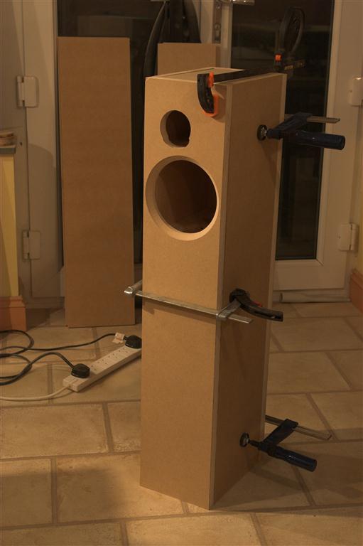

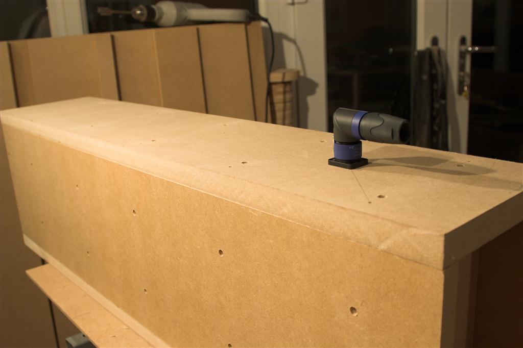

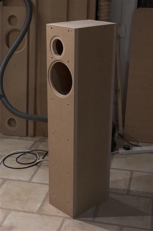

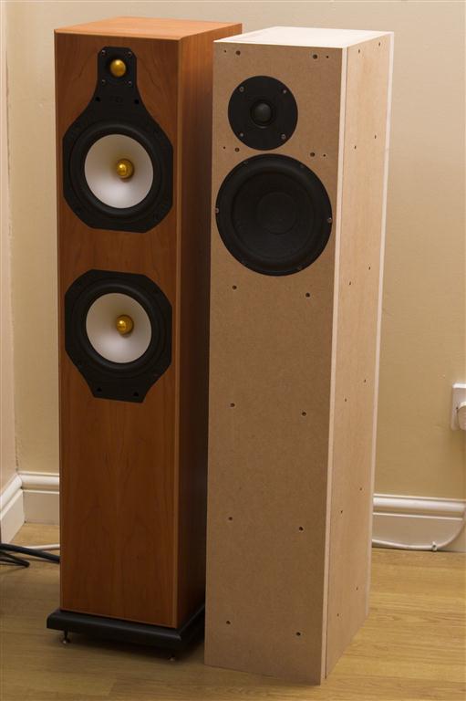

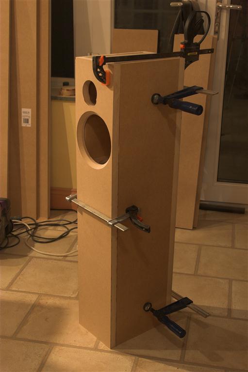

So back to the thread, with all the pieces now prepared it was time to dry fit everything and then get the screws in. This went reasonably well with the first cabinet (or so I thought), the tollerances were int he order of 1mm on the whole, nothing that can't be solved with some 40grit sandpaper and a bit of time 🙂 However on closer inspection what I realised is that some of the braces had split slightly on one side as I did not pilot hole them (never believe what it says on the box of screws, always pilot home... not splitting my backside 😡 )
The second cabinet went much better and the fit was very good, helped by spending a bit more time on the alignment in the first place. It is all a learning curve, perhaps I should have made three cabinets to be on the safe side?!
Why is it that building these speakers dominates my thoughts during the day and when I am trying to sleep like an obsession, however, when I am actually working on them my mind is elsewhere?

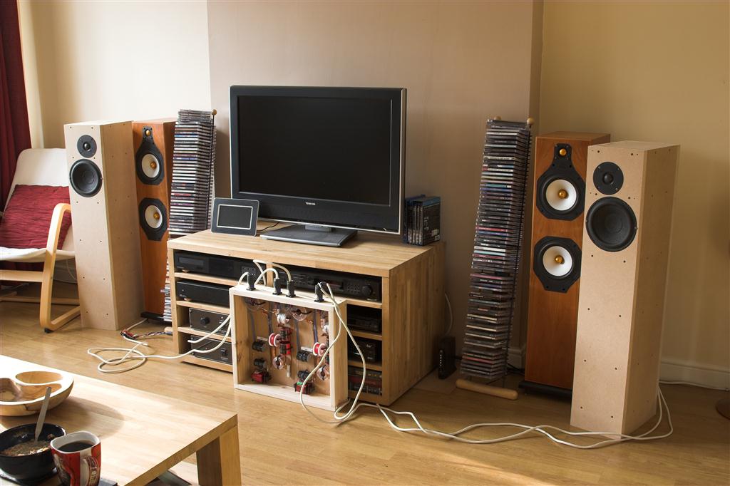

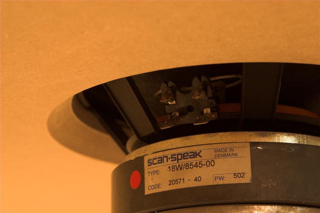

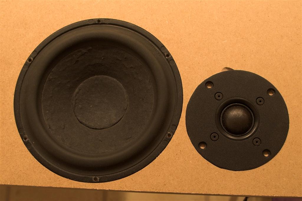

With a pair of cabinets now pieced together I couldn't resist getting the drive units fitted to see how they looked... then that lead to the thought that since I have a few days wait until the rest of the stuff arrives (port, stuffing, etc.) I might as well wire them up and have a listen. After a bit of digging in the shed to find my "old rag" collection, which is basically soft clothing past its best and some fabric I used for a parcelshelf many year ago I got something into the cabinets so they didn't sound too much like hollow boxes and some wires run into the cabinets. The latter of these was done using the hole you can see below filled by the speakon connector that will eventually populate it.
I ended up going to bed around 1:30am after putting cd after cd in the player I was enjoying listening to them so much. In terms of clarity they are ahead of the Monitor Audios especially when it comes to the treble end of the spectrum, however, without the port they are lacking the weight and extension that I am used too. It is obviously unfair to do any serious reviews at this point, but early indications are very good.
I still have quite a bit to do with them, once the rest of the parts arrive they need stripping down, gluing, reassembling, damping and stuffing adding, wiring, terminal plate completing, veneering, plinth building... god that seems like a long list!
