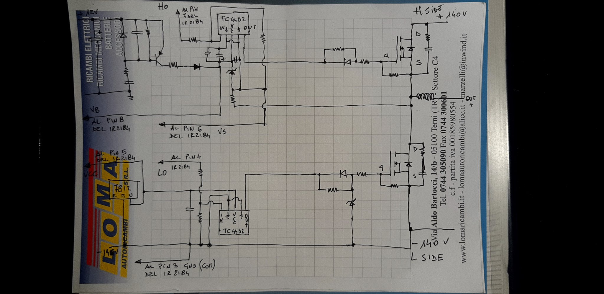

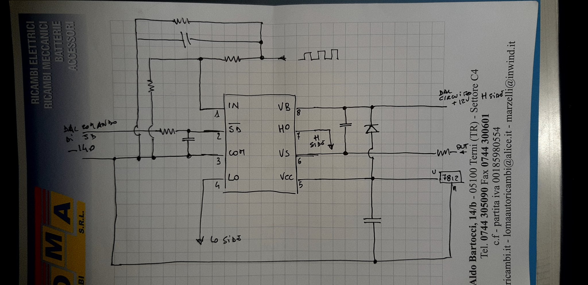

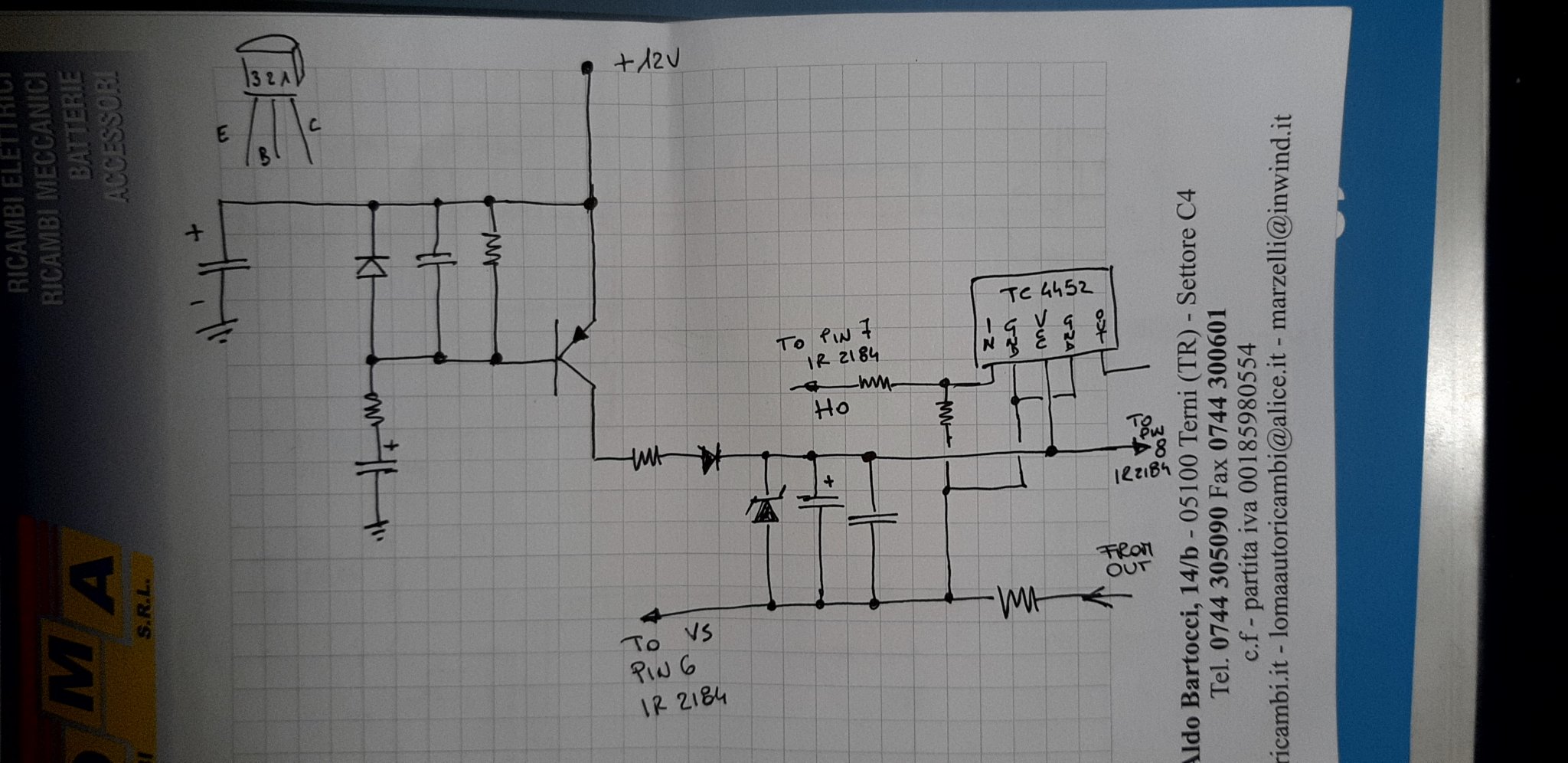

hi all guys, taken by the enthusiasm of the green led on, I ignored an anomalous behavior of my VFL. Without an input signal it oscillates at 13.982KHz and logically this translates into an annoying "whistling" which is also heard on the loudspeaker. Do you have any idea about it? which IC generates the PWM signal?

At start up, with the capacitors flat, the amp doesn't oscillate, but if I inject an input signal it starts oscillating at 14kHz. If I turn off the amp, remove the input signal and turn the amp back on, it resumes oscillating at 14khz. To stop the self-oscillation I have to turn everything off and discharge the capacitors.
In fact, the oscillation frequency turns out to be too low. I would like to understand which chip is responsible for generating the PWM signal.
This is a self-oscillating amp, not a clocked amp that would have a dedicated triangle wave generator. Feel free to correct me if this is a clocked amp (would make troubleshooting easier).
The oscillation frequency is sometimes determined by the small capacitors at the input to the class D driver. The ones highlighted in the diagram may be those caps.
Is your 2184 driver in a socket?
