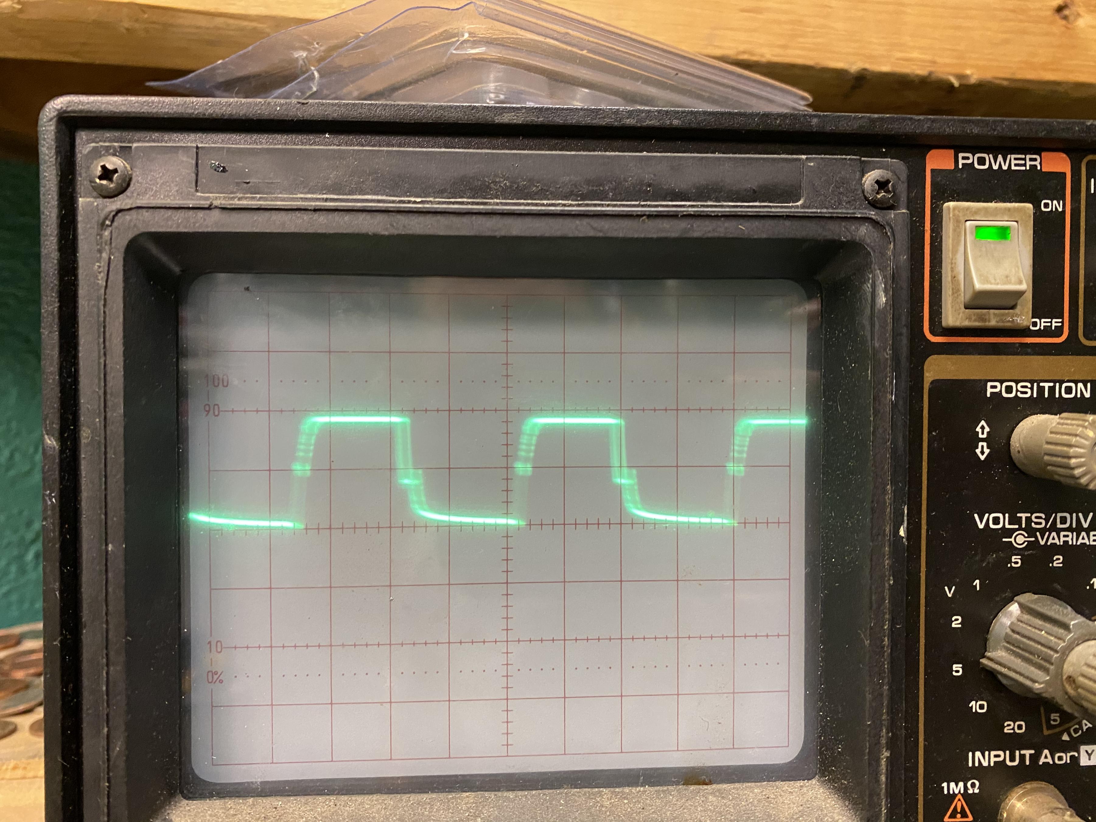

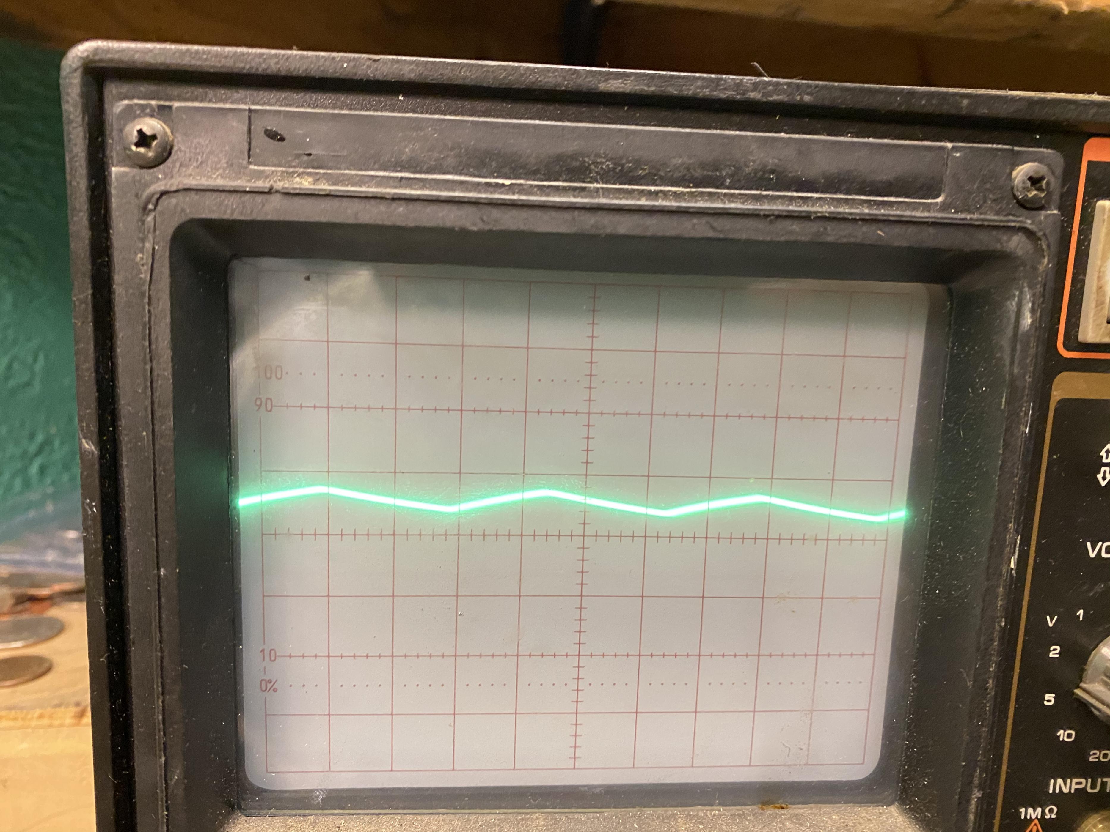

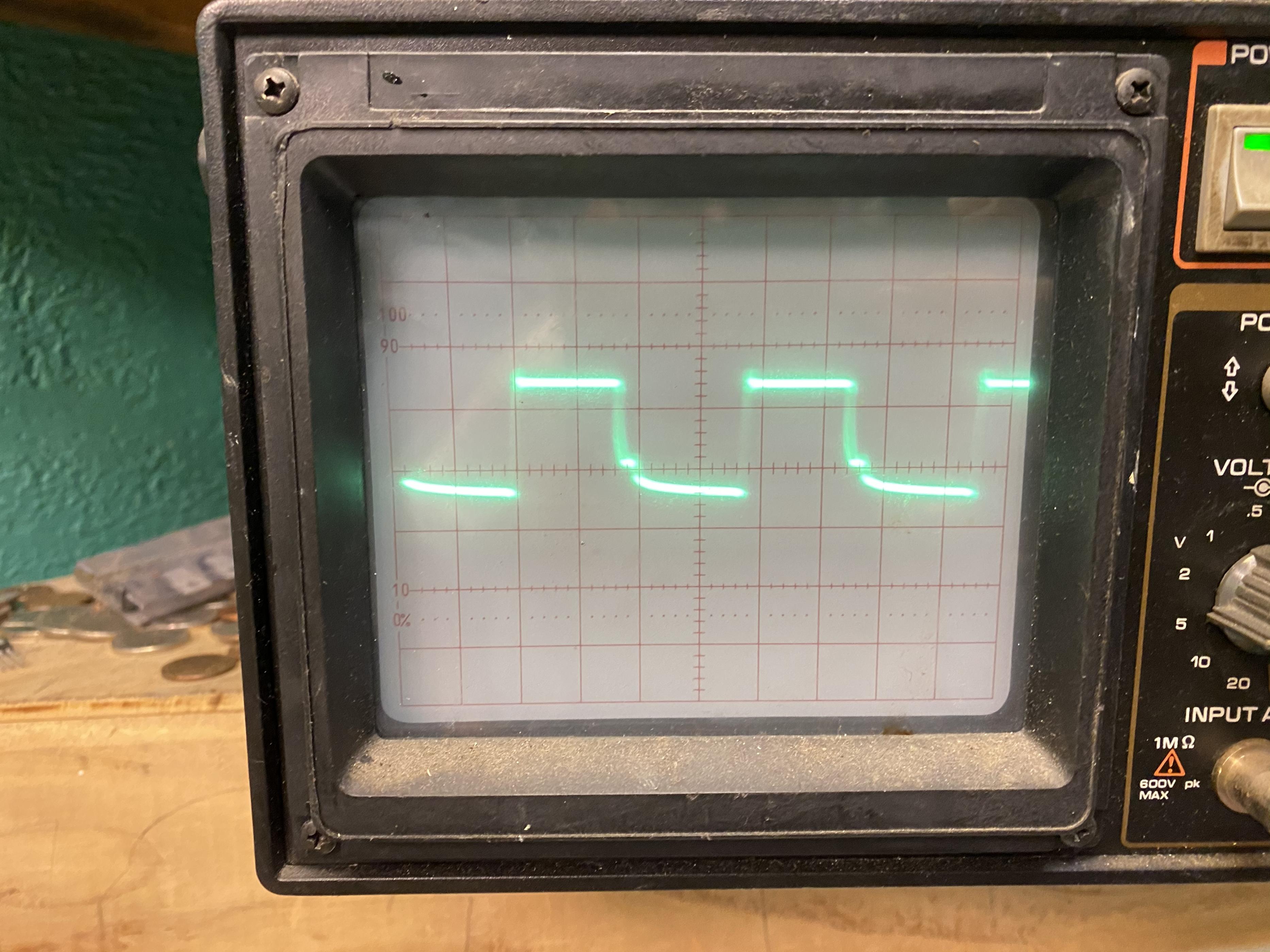

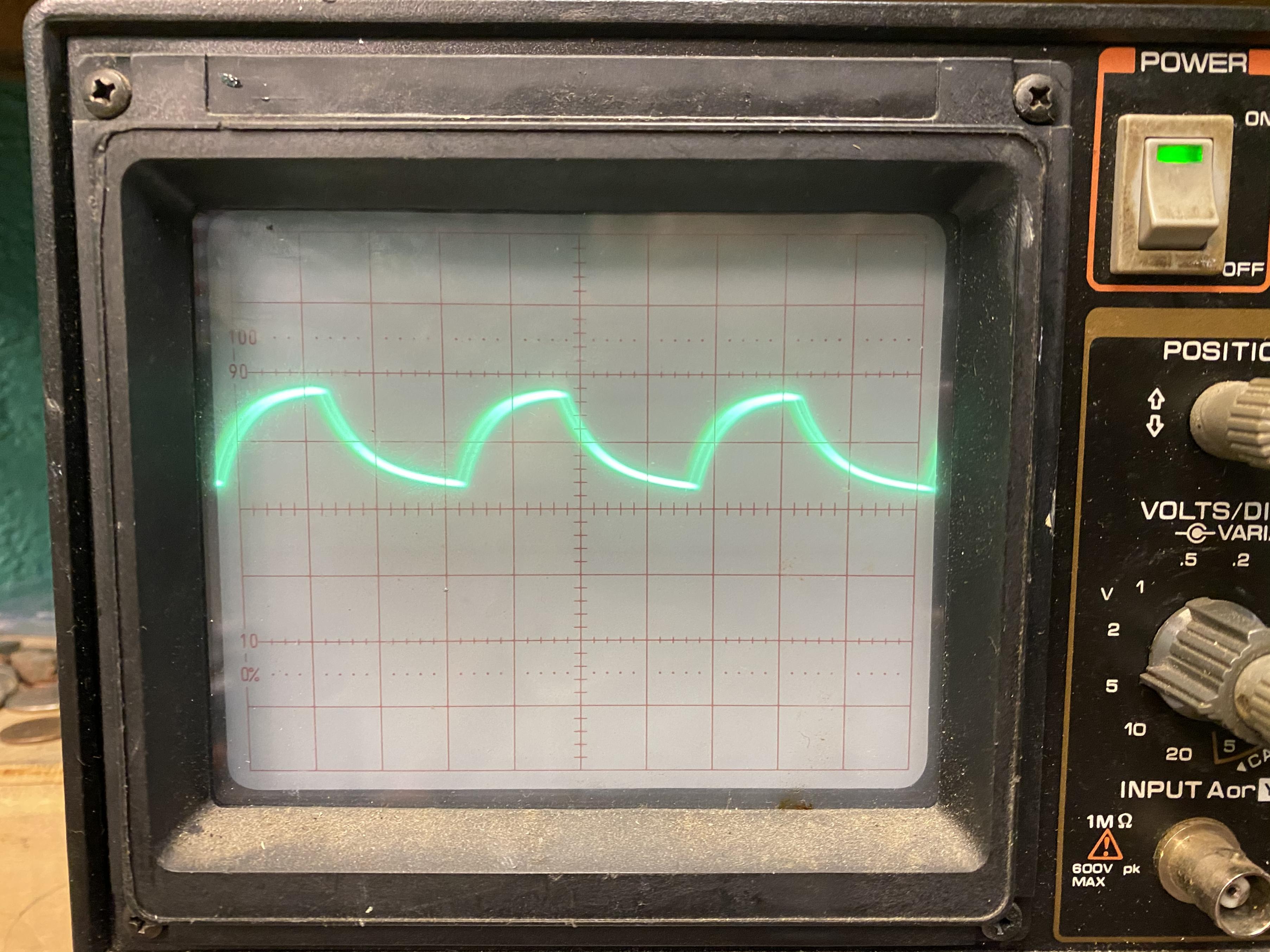

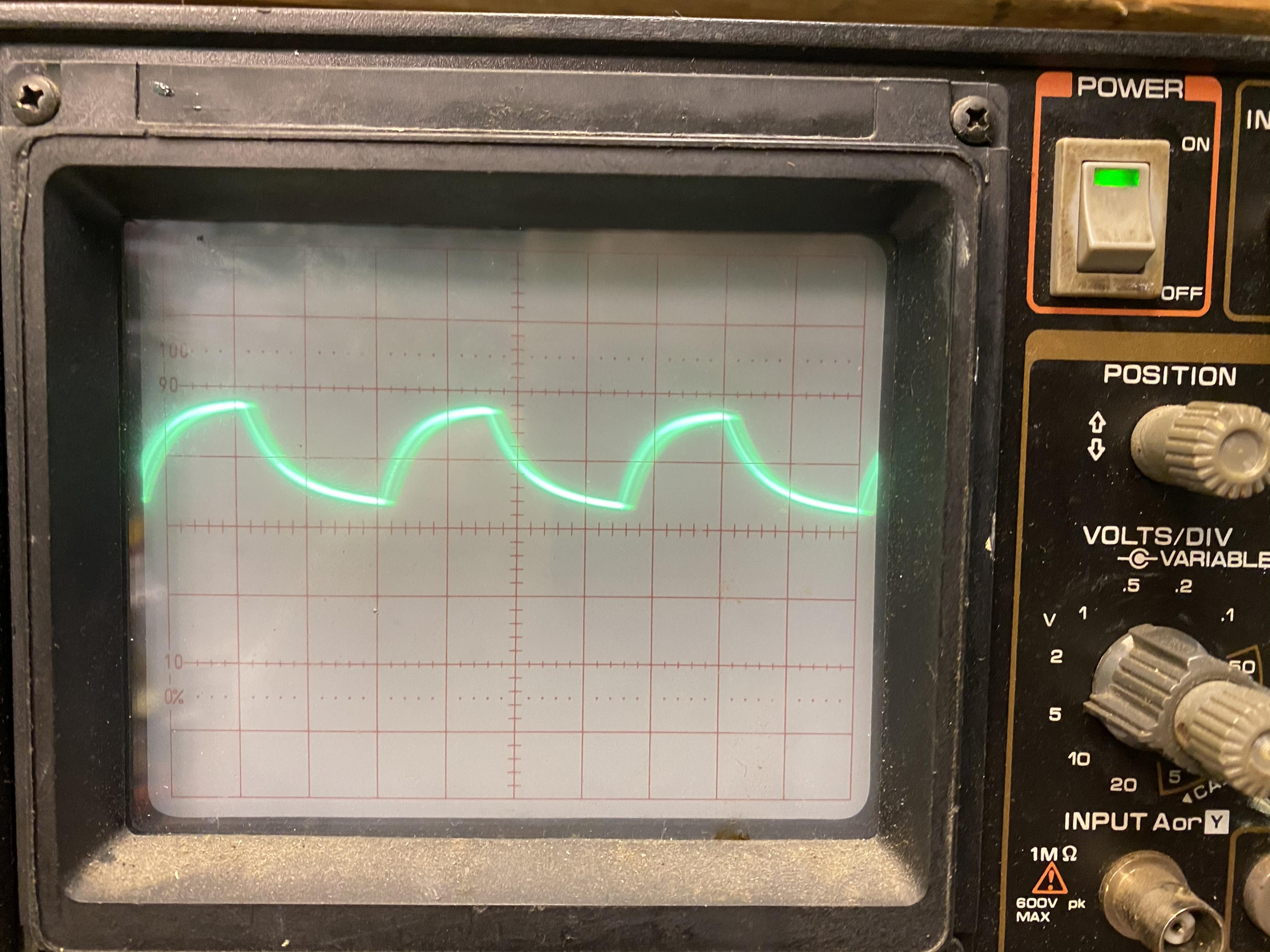

Back to this amp.

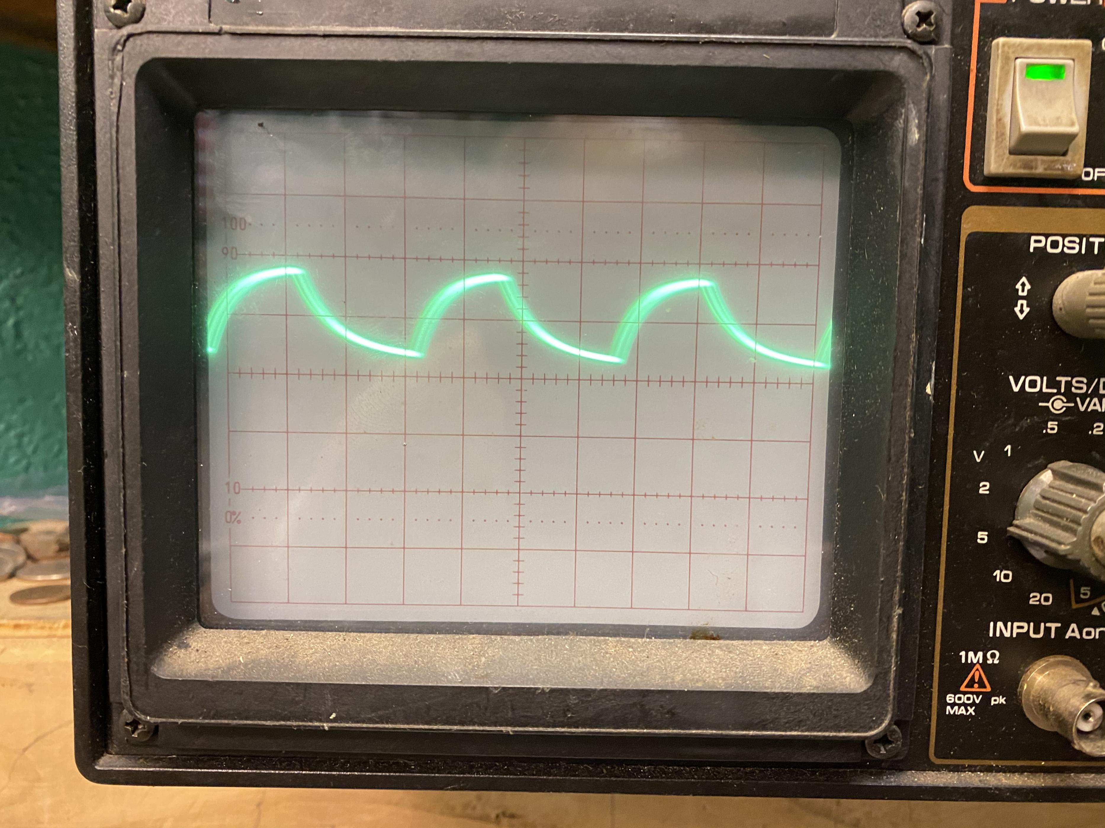

I get bad drive signals on all 6 banks of fets .
The trace was aligned on the center line before taking any readings and the scope is set to 10us 5 volts/div
Any thoughts ?
Any thoughts ?

A couple of drivers are defective .
The original drivers were A1275 and C3228
Instead of using the BD139/140 as replacements since I have to use double sided tape on a few of them so the back doesn’t short to the buss bars in the amp .
I’m wondering if I can replace them with the following

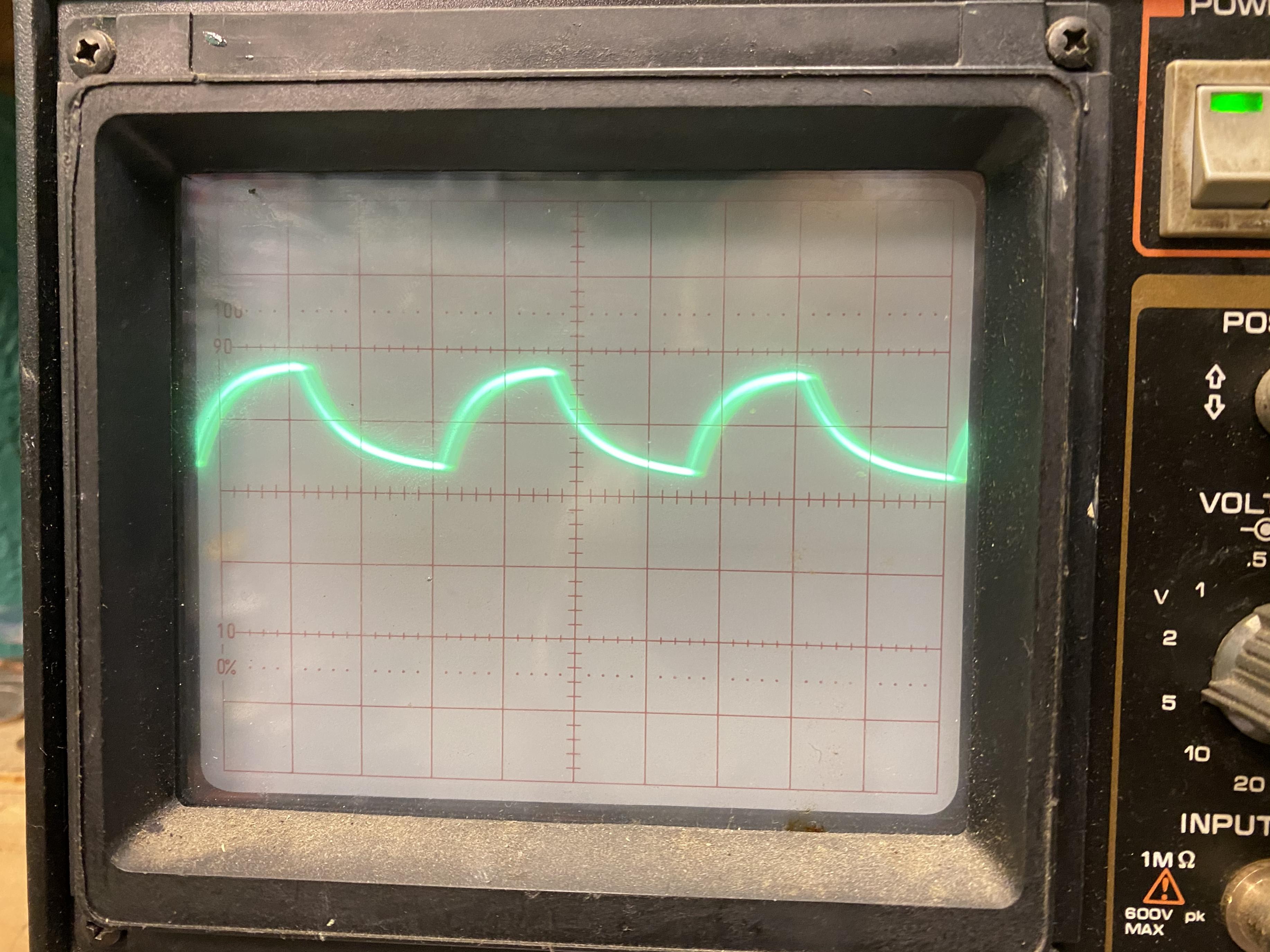

Ok I replaced all of the drivers again and redid the solder connections on the resistors and 10 volt diodes .
All waveforms are identical now .
I had issues with 1 bank of fets before replacing the drivers since that 1 bank of fets had no drive on it would it affect the rest of the banks as well since all the power supply fets were heating up

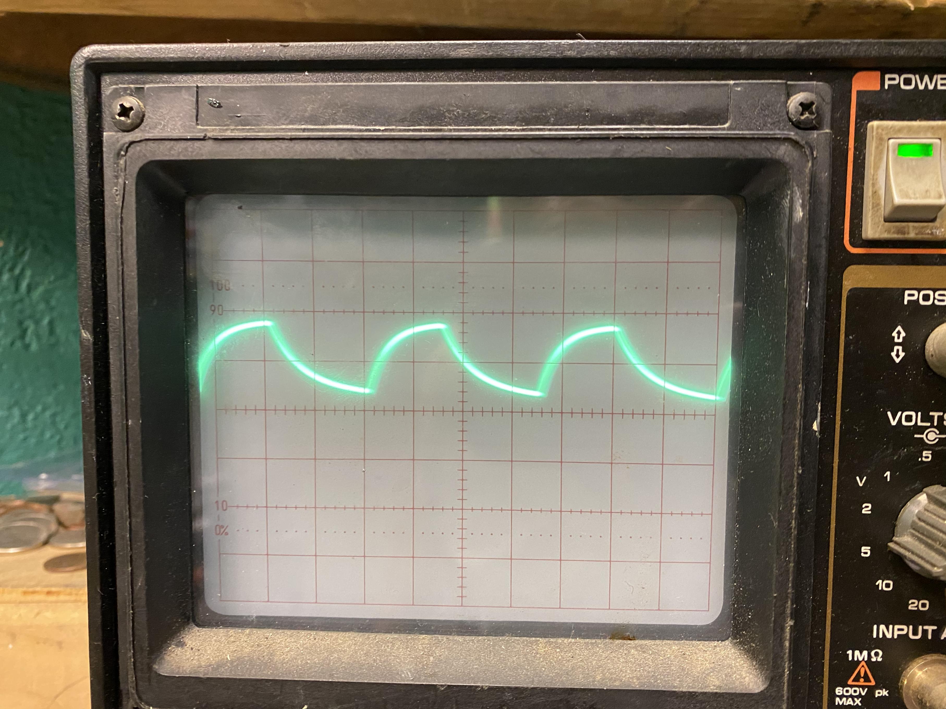

With all of the fets installed and the power supply board disconnected from the output board .
The fets still get warm and continue to heat out of the heatsink at idle . Not sure for his is normal or if I still have an issue .
Here is what I get on all of the banks of fets .
Scope set to 10us 5 volts/div
3 minutes to heat up isn't awful and could be normal.
That said, for all of the diagrams I have that use the 1405, all but one uses the 22 ohm gate resistors.
Replace all of the gate resistors for that transformer with 22 ohm, install all of the FETs for that transformer and confirm that they still run cool. If they heat up slightly more, install of the FETs for a transformer with 47 ohm resistors and see how much quicker they get hot.
