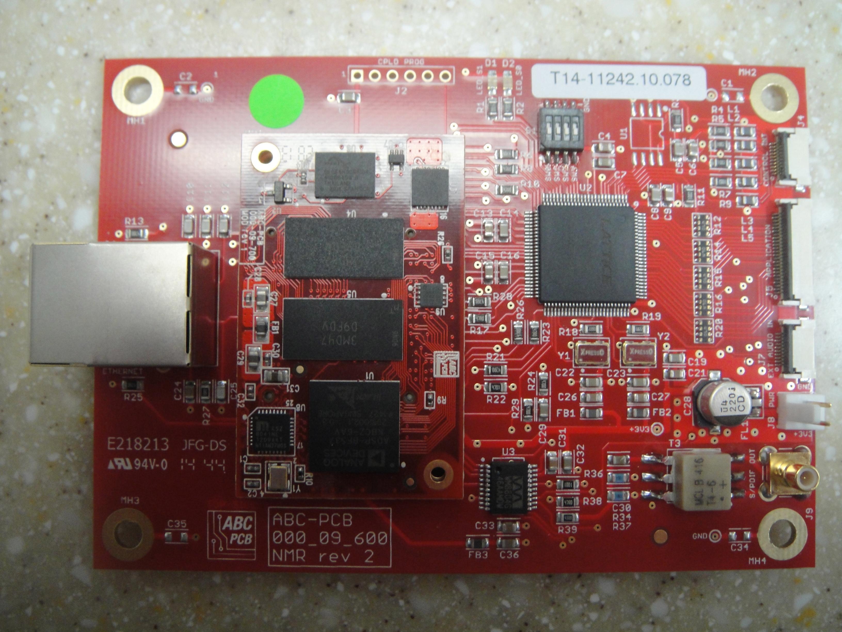

.... Thought CKSEL line is low for 44.1k and goes high for 48k- based frequencies. Please check the lines again for both settings.
Hi Acko,
With the inverted polarity in Miero's driver, when CKSEL is high X1 seems to be selected and 44.1kHz plays fine, when 48kHz file is played (CKSEL is low) mpd plays but I get no sound.
With the standard Miero driver value of 3 for a botic, mpd crashes on 44.1K (CKSEL is low), with 48kHz file plays but to slow.. (CKSEL is high)
In "all" 4 cases I have 1.6 volt at CK.
I've swapped the clocks out but same symptoms as before, so I suspect it's logic before the clocks, either U8 or Q2. What do you think?
One more thing, I noticed that when I touched earthtraces with a probe, sometimes the clock seemed to jump from x1 to x2, very strange.
.....In "all" 4 cases I have 1.6 volt at CK.
I am trying to figure out your problems. We know both Chanh's and Cyrils's build worked well with "option #3"
Can you please check the the Clock signal that is actually going into BBB, ie. the output at MCK of "Digital Inputs"

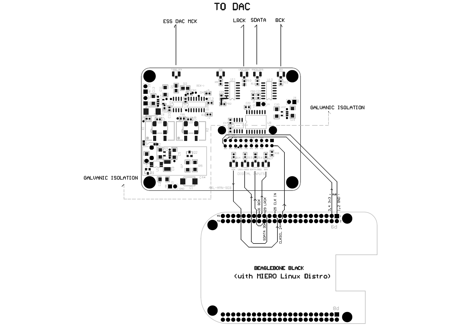

Hmmm... Can you please cut the black wire coming out from your CKSEL of the BBB-UFL board. You will only need a single (the "white") wire to S03 "sel" point on board as shown in the manual
Next check if this line/point (at the BBB-UFL board pin#24) switches correctly for different Fs. Expecting with Botic option#3, to go high (3.3V) when 48k file played and low when 44.1k played

Suspect: U8 input side may not be powered? Your header does not seem to pick one of the 3.3V pads. Both 3.3V pads need to be connected (or bridged). See wiring diagram.
Possible CKSEL signal when "HIGH" is weakly powering up the isolator with undesirable effects.
That explains the “monkey” behaviour. It never occured to me to jumper these pins, as most other builds I had close-ups of only used a single clock, they didn’t needed to power both pins.
Thanks a lot Acko for taking the time to investigate this issue
Everything is working fine now using Miero’s setting “3”.
