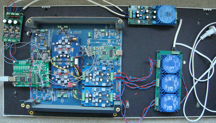

I have done some tests using the AKU384 which is a special build based on the S03 and Amanero underpinnings.
Using JPlay5(Mini-bare bones version) on Win7 with ASIO or Kernel Streaming for native files up to 192KHz. No native 352k or 384k material so I used HQPlayer to upsample 44.k to stream at 384k for the high Fs tests.
DAC system is AKD12P (9018) clocked by the AKU384 in 'Turbo" Sync mode
Here are the results:
1. DAC was able to lock at lowest DPLL BW all the way up to 384KHz. Sounds really great! Very stable, no dropouts, noise, crackles or other issues.
2. Still early stages but I seemed to like JPlay combo with all the settings for buffer adjustments etc. JPlay loads entire file from disc to RAM and steadies the audio stream so the possible reason for a more palpable effect. But some settings can upset the system with noise and crackles, full reboot needed- so yes, player can affect playback if not properly setup
3. Sync mode brings out the best with all the micro details.
Haven't tried DSD yet or tweaked with zero DPLL BW. Letting it burn in a bit more and will post results later
Hardware and prototype test bed as shown (any bids?🙂). Looks like a maze (mess) and unsafe but signals are carefully routed and I am pleased with the results!

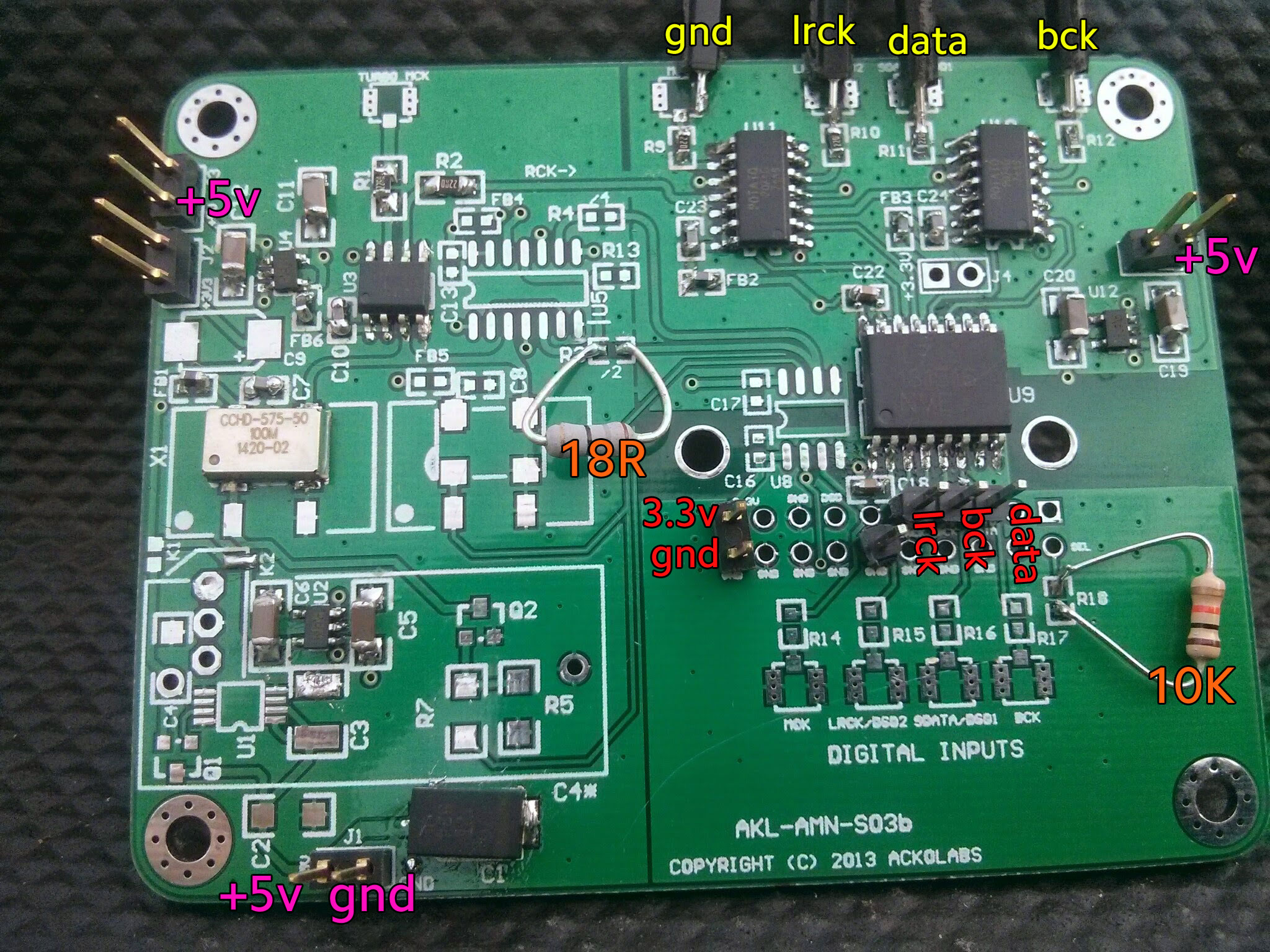

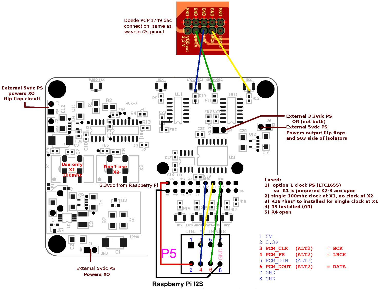

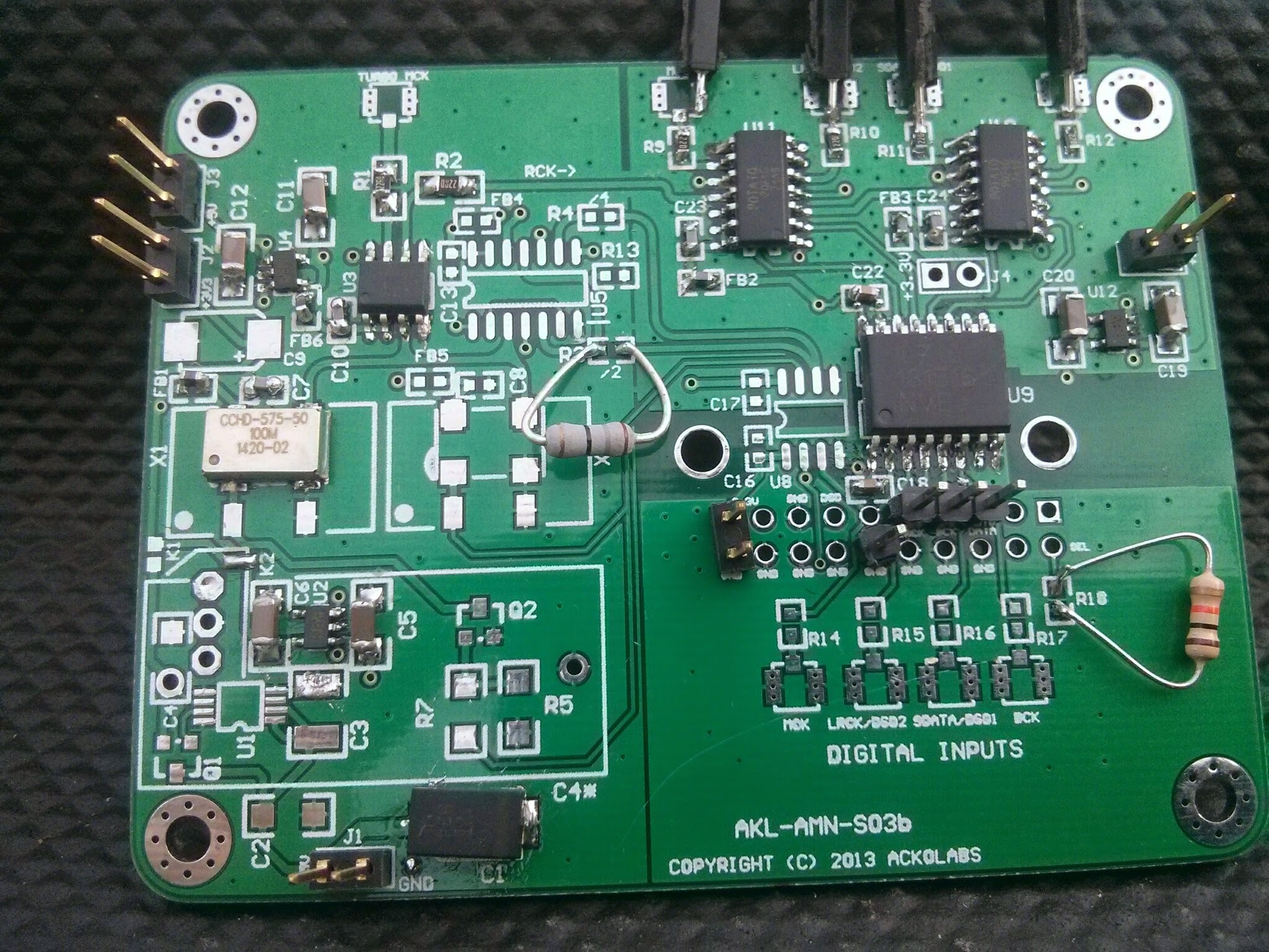

could someone sanity check my work please?
I have an S03 board, with a single 100mhz clock, to go inbetween a Raspberry Pi and a DDDAC 1974.
In the labelled picture, pink is for a 5v power supply, red goes to the Pi and Yellow goes to the DDDAC. Orange is to explain the extra resistors that I added in and didn't have smd ones. Now I look at the pictures, R3 doesn't seem to be doing a lot....
I was using the information from this post:
http://www.diyaudio.com/forums/group-buys/227502-amanero-isolator-reclocker-gb-98.html#post3916986
combined with the 'Isolated Connection with Re-clocking - ASYNC mode' instructions.
If I put this between my Pi and DDDAC, I get nothing. The Pi doesn't see the DDDAC. I'm clearly missing something, maybe a jumper or a component I need to run this way?
Please excuse the horrid soldering. It's ugly, but as far as I can tell, everything's connected properly....

Hi James,
you have the same configuration of mine S03 with rpi and the DDDAC.
I will give a look carefully to your pictures but I can quickly say you that the 2 resistors not SMD (R3 and R18) are not needed. I will let you know if I can see anything else from your pics.
What about the grounds? You have more than one Vin... maybe you miss some gnd connection?
Enrico
Hi James,
I actually have a DDDAC inspired DAC up and running with Acko Isolator board (and a custom made clock board) and it works quite fine. I understand that the SO3 is an integrated unit of the Amanero USB & Acko's XO board + isolator board. My setup works just fine except for the clicks between tracks that apparently is due to the Amanero board.
What I first notice is that you don't have a GND wire between the S03 and the DDDAC ... I would use some close to each of the data wires.
I'd also check the voltages on the S03 board to see if everything is as it should be.
Third, if it still doesn't play, I would try to track the data stream from the Pi towards the DDDAC with an oscilloscope. So as to see where there's no longer a signal.
Best regards,
Jesper

Thanks Enrico,
I added the resistors when I was looking for some reason it wasn't working.
With the grounds, I have gnd to my Pi and to my dddac, but I only included 1 gnd to the power supply as I noted that J1, J2, J3, J6 GND are all connected via the ground plane of the board

Thanks Jesper,
I do have a GND to the DDDAC, If you look at the left one of the top connectors, I have joined it to the outer pad of the ufl connector, not the inner, so it gets a gnd connection 🙂
I'll have a check for voltages. Are there obvious places to check without risking bridging chip contacts and blowing stuff?
Data stream's a funny one I think as my Pi won't contemplate playing anything unless it can see the dac, so I wouldn't be sure how to go about that one...

Hi James,
looking in the pics that you send I can't see any missing parts or jumpers and the connections are correct.
I suppose that you check all the various Vin including the 3,3V from the rPI ?
Can you check what you can read from the out of the XO (pin 2)?
If you back in this thread you will found my posts for the same problem with my S03 at the first trial.
After all the troubleshooting with Acko we discover that was the XO 🙁

I understood the R18 10k resistor was to force that only X1 is present?
As far as I can tell from the XO, I have:
Pin1 EN - not connected. goes to Q1 which is not present
pin2 GND - GND
Pin3 ck - 2.93v DC
Pin4 vcc - 3.3v DC

In my understanding the CKSEL circuit with U8, the R18 and the Q2 is required for the Amanero. You correctly don't install the U8 and the relevant Q2 so there is no reason to install the R18.
About the XO pins, I just measured mine that is playing now and I have 1,66V at the pin 3.
I am sorry but I think that you need to dismount (carefully) the XO and test it separately from the circuit to be sure that is working properly. If I remember correctly you should read half of the Vin (more or less 1,6V)
I will be happy to help you making others values cross check if you wish.
Maybe Acko have much better suggestion than mine?

Cool, thanks.
I just checked again and thankfully I'm actually getting 1.58v at pin 3.
I'm not sure how I measured that wrong by probing the X1 output pin directly 😕 but I got a clean measurement from the pin3 pad for X2, which is directly connected.
thanks,
James
Great! Your XO looks ok 🙂

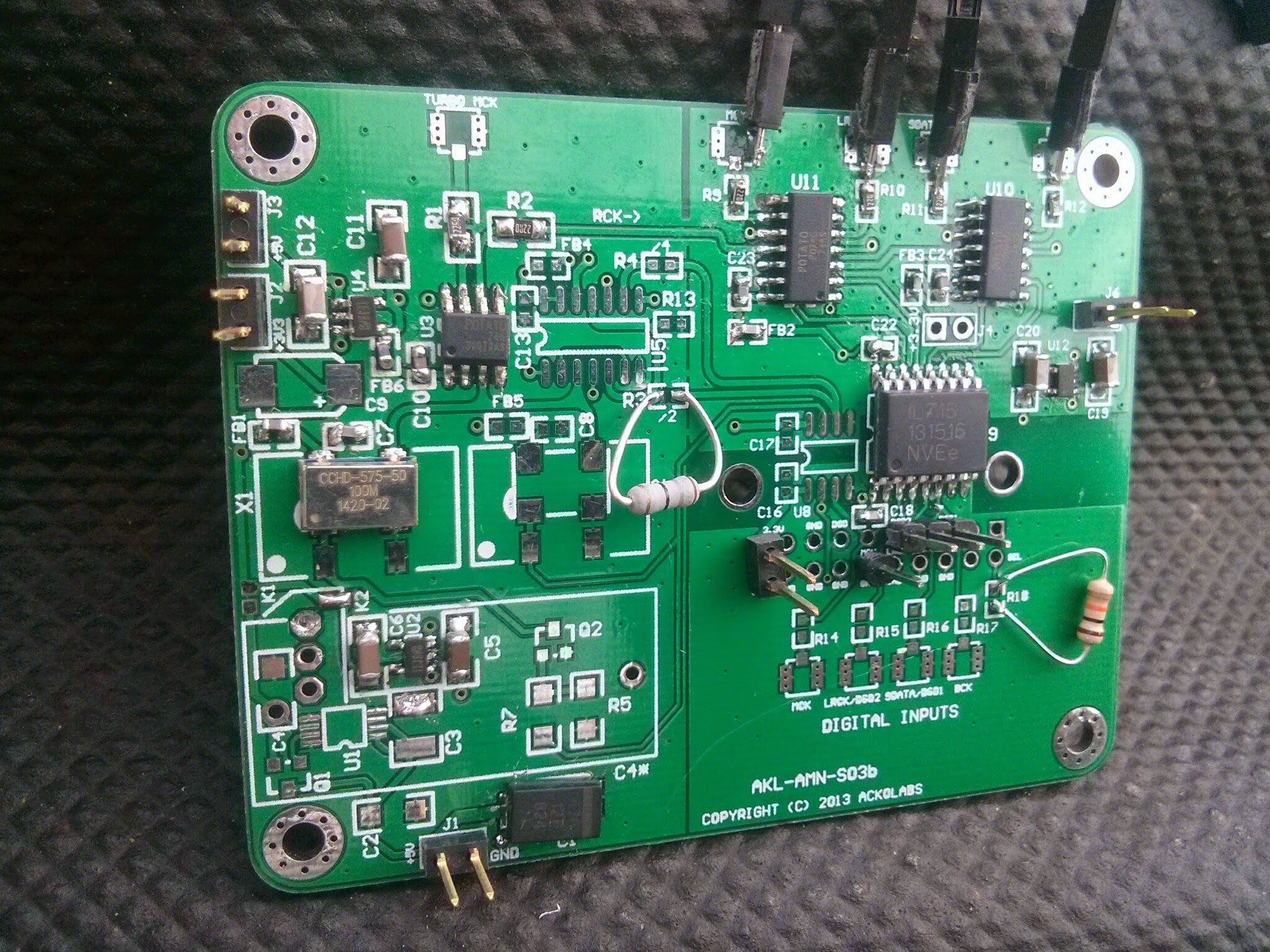

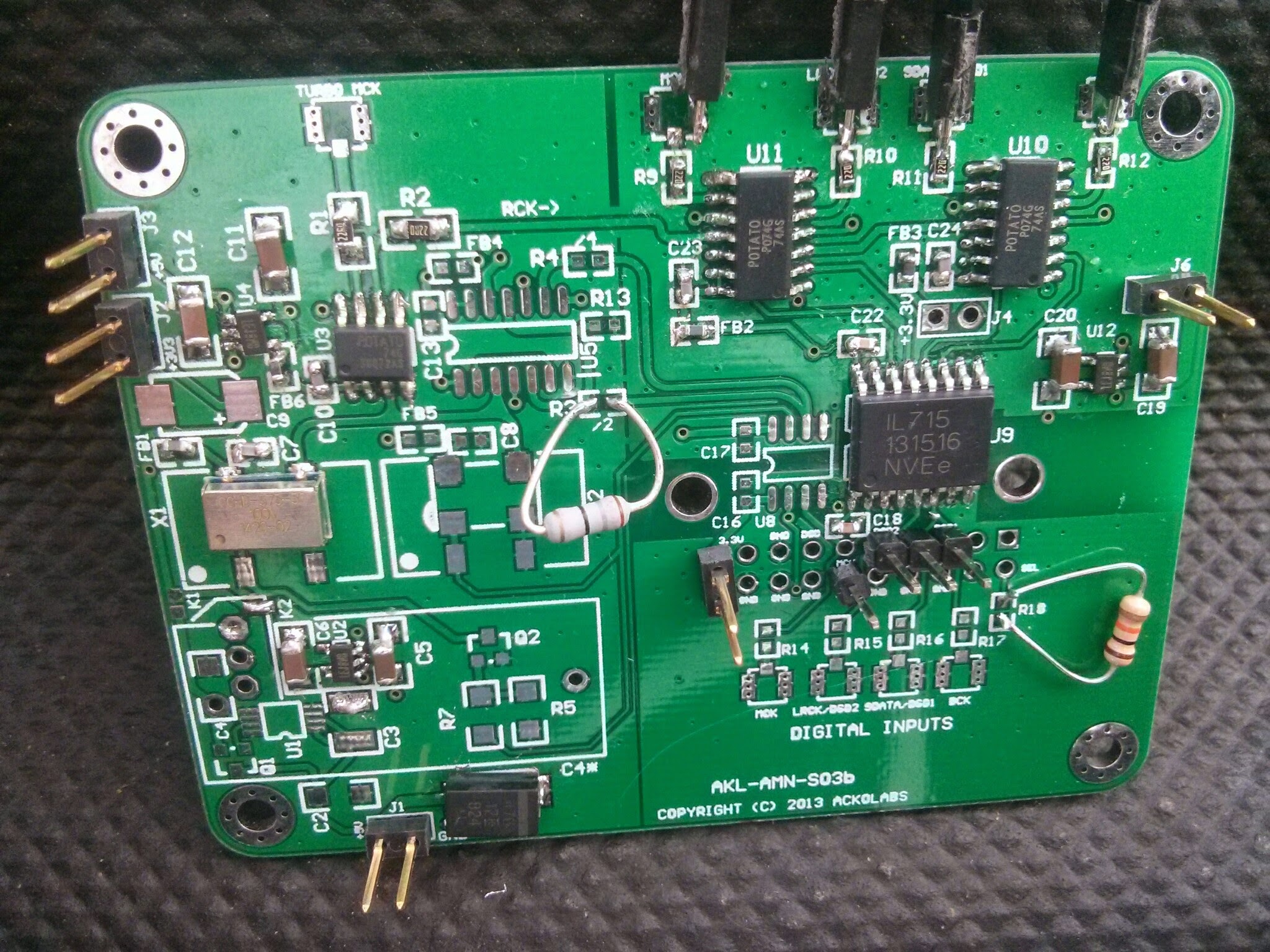

I can't see well from the pics... you check already that you don't have any bridges between the pins of the flipflop or others IC?
Ooooh, I've just been double checking that each side of each chip has power and ground and I think I have found it....
The 3.3v board print is sort of in between 2 holes. I've opted for the left one, but I'm now pretty sure it should be the one to the right...
