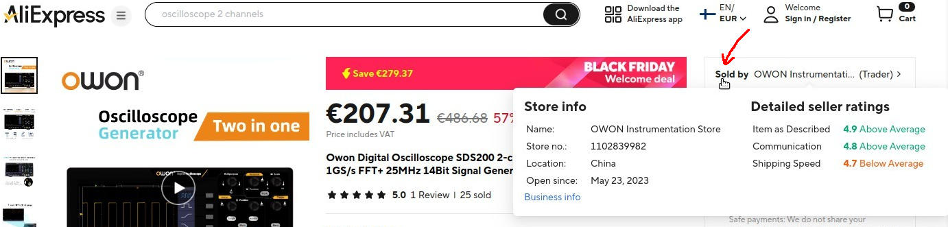

btw I just discovered by chance some more places where further store info is located on AliExpress, it's really a poor layout nowadays as the store info is spread out at 2 different places and each with their set of info.
One is on the item page, on the right side while hovering with the mouse over 'Sold by' on the upper-right side a drop-down window appears, pic below:
Click on 'Sold by' and it takes one to the stores homepage, there in the upper-left corner hover-over with mouse cursor on the store name and a drop-down window appears...
