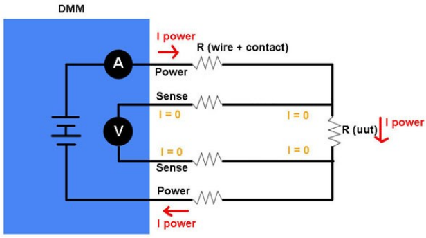

For small resistance values (<10ohms), I prefer to use higher current (100mA, 200mA,1A etc) from a DC power supply or even a battery.
Measure the current and the voltage directly in the resistor leads, then calculate the R=V/I.
This way you eliminate any cable or contact resistance from the measurement.
Generic multimeters uses very small current levels which generate very small voltages. That's why the measurements are not accurate for lower resistance values and are accurate for high resistance values.
In addition, multimeter includes the multimeter cables and contacts in your measurements.
Think if you need to measure 0.1ohm resistor. No generic multimeter can do it.
But if you inject 1A, you will get 100mV across the resistor.
1A and 100mV are easily and accuratelly measured by any multimeter.

Yes, what I sugested is in fact the 4-wire Kelvin connection, where we separate the current flow from the voltmeter wiring.
And this is interesting cause it is generic for any resistor range.
Imagine if you need to measure the resistance of a car alternator or starter coils, where the resistance can have extreme low values such as 0.01ohm.
With a two US$50.00 regular multimeter, you can measure it with good accuracy (0.5%).
Injecting 5A, you just need to read 50mV, which is easily done on the 0-200mV scale, for example.
