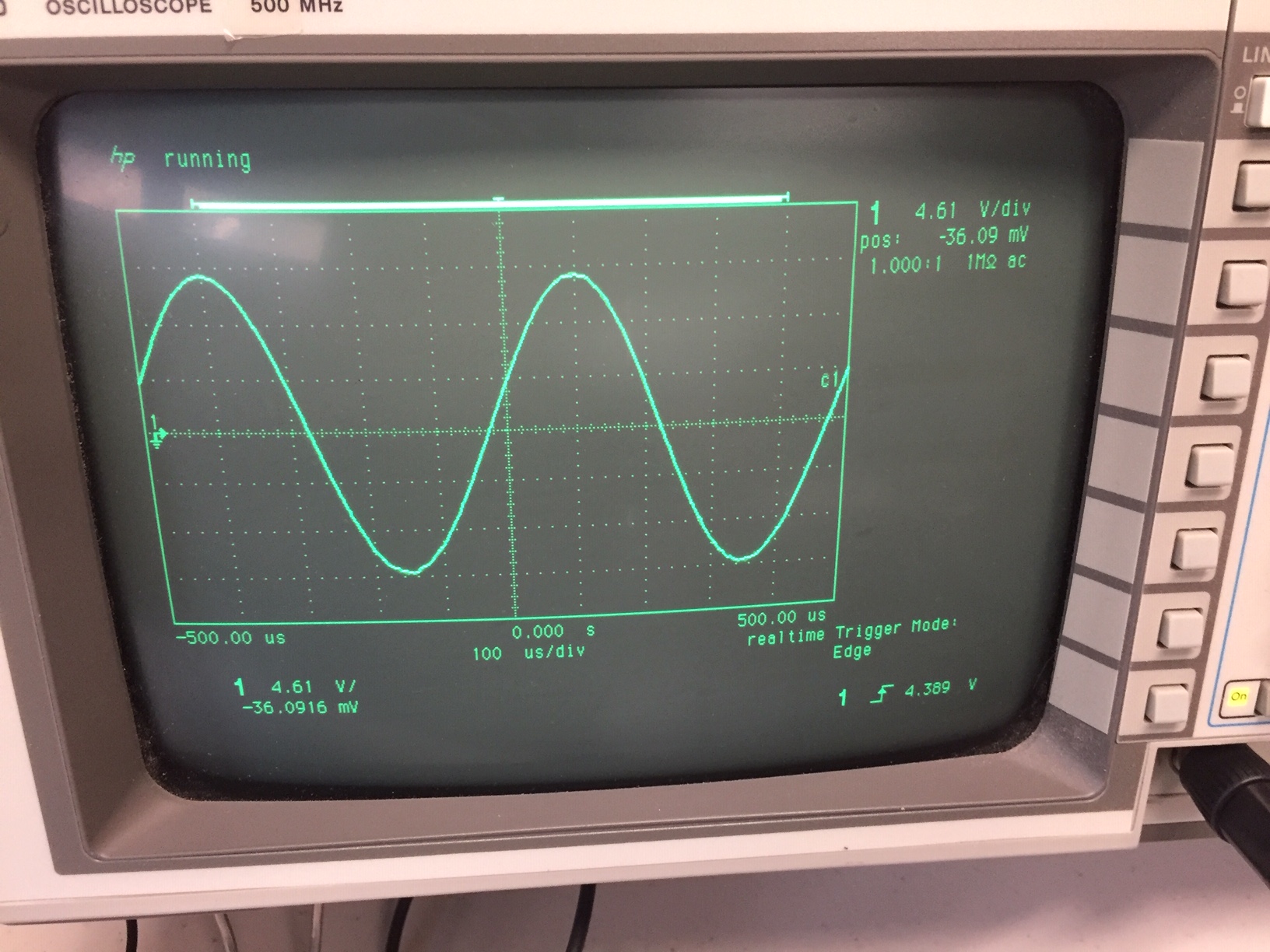

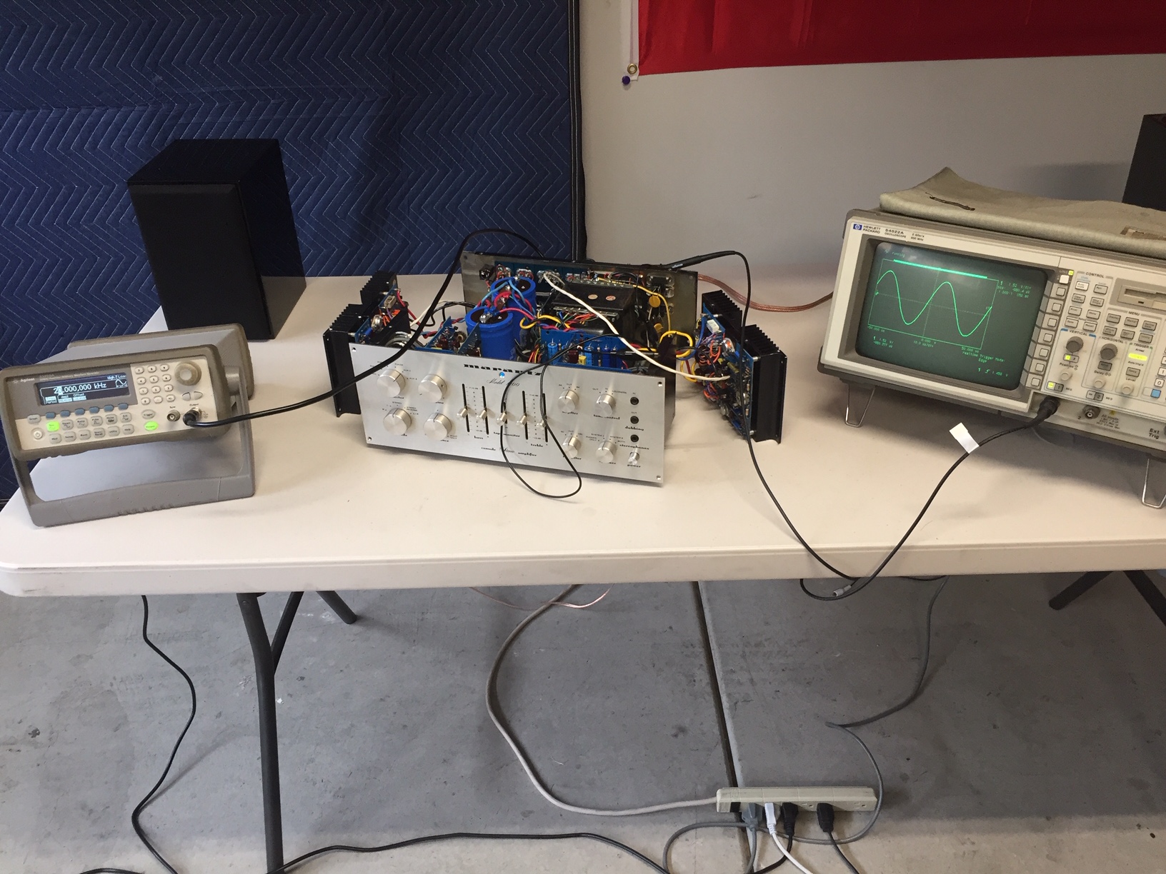

I borrowed a signal generator. Attached the o-scope and signal generator and the right channel is oscillating.
Now going to replace the components on the power amp board as recommend in the service manual (mostly pF capacitors), and retry. I should have done this long ago...

Following the service manual troubleshooting section pertaining to hum and oscillation, I replaced all the parts recommended and reflowed several suspect solder joints on the power amp boards, especially around the DC Offset and bias pots. Powered the amp on and set DC Offset and Bias. Watched them both for 30 minutes. Both remained stable.
Hooked up the signal generator, o-scope and dummy loads. Squirted a 20Hz, 2kHz and 20kHz signal into the amp and they all looked clean. Both channels looked like the attached o-scope photo from 20Hz - 20 kHz.
I'm going to play music through the amp for a few days while I'm "working" from home.
While I can't say which component(s) exactly caused the humming and oscillation, I'll be sure to follow the service manual first. It says something about Marantz gear- the amps are well documented and schematics/manuals/manual addendums are available, individual components can still be bought relatively inexpensively, and good advice and help is available from experienced people on this forum.
