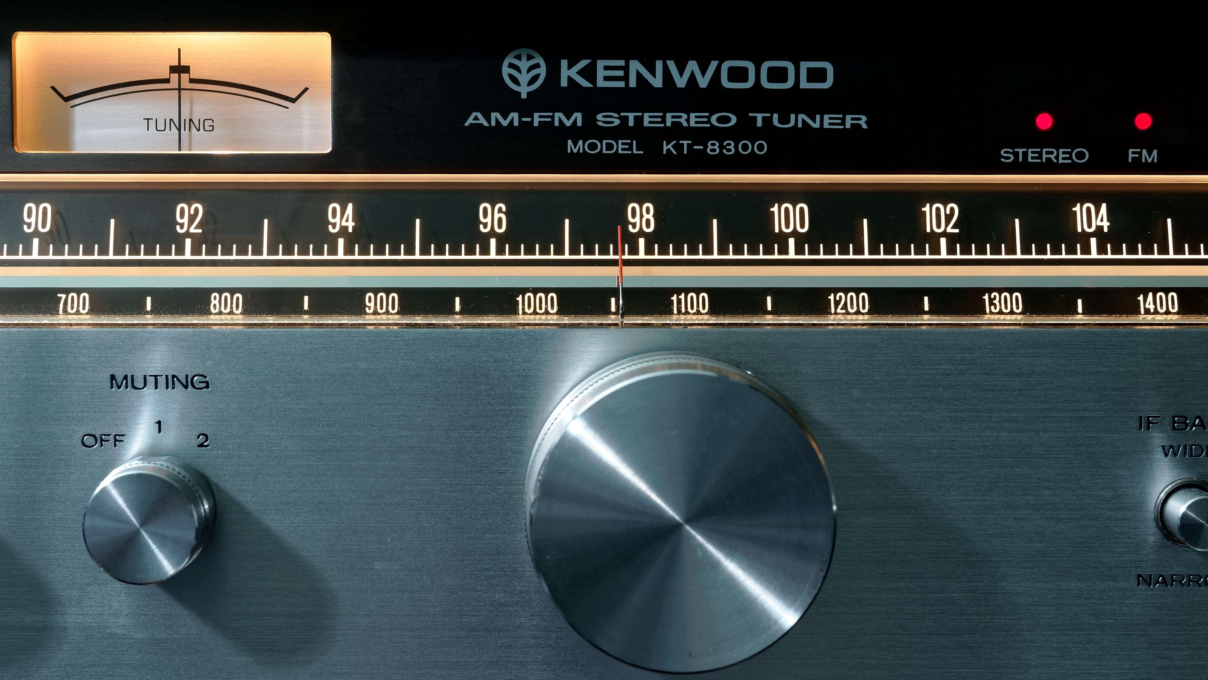

Today would be best to build a DSP based tuner.
Or start with a ready made module like the ones on ebay...if you don’t want deal with programming.
DSP & PLL Digital Stereo FM Radio Receiver Module 87-108MHz with Serial Control lots of these on ebay.
Or take the best front end from one vintage tuner with 5 or more gangs add the best IF section from another (wide and narrow IF) and then grab the decoder section from a late 80s tuner that has the LA3450 decoder and you might have a super tuner. Few tuners were great in all areas but you can find several good in one of these. The tuner you choose for the front end should be the chasis donor so you don’t need to deal with dial and tuning frequency. And I mean take entire sections of pcb/circuits as is. Make it an integration project of working sections.

Some parameters like Input IP3, adjacent and alternate channel selectivity and blocking sensitivity require some careful reading of the footnotes and test conditions.
Worse, most of these figures are not available publicly for the classical tuners for comparison. Review used to focus on just sensitivity and maybe distortion
The Si473x and Si474x series are low-end targetted products.
You can try to use the Si475x,Si476x and Si477x series instead.These products have a high sensitivity, -3.5dbuv(0.67uv)

Aren't home Hi-fi tuners generally designed a bit deafer anyways? They are expected to be wired to a properly designed and fixed rooftop aerial....
The FM spectrum is crowded, so the practical limitations are due to intermodulation and adjacent channel rather than raw sensitivity
An excellent alternative
To building from scratch. I fully get the DIY approach, along with the experimentation and learning. But sometimes when audio quality wants to be the priority, the existing vintage market can offer a lot of value. With a few good stations, I spend much less time listening to any other source.
