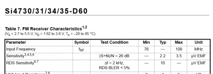

No need to get rude, I am a RF engineer and understand most of the specs immediately.You say that you do not understand the specs so how can they have any meaning to you? Your assertion of saying that a spec is poor is based on a number that you do not understand the meaning of?
Some parameters like Input IP3, adjacent and alternate channel selectivity and blocking sensitivity require some careful reading of the footnotes and test conditions.
Worse, most of these figures are not available publicly for the classical tuners for comparison. Review used to focus on just sensitivity and maybe distortion

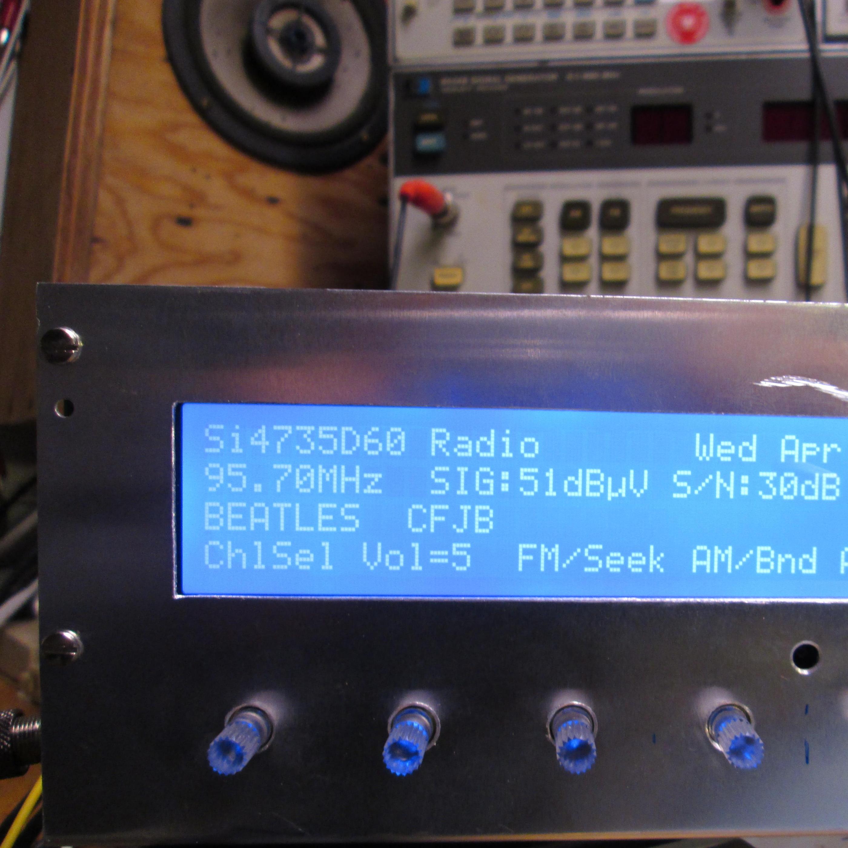

The Si473x and Si474x series are low-end targetted products.
You can try to use the Si475x,Si476x and Si477x series instead.These products have a high sensitivity, -3.5dbuv(0.67uv)
