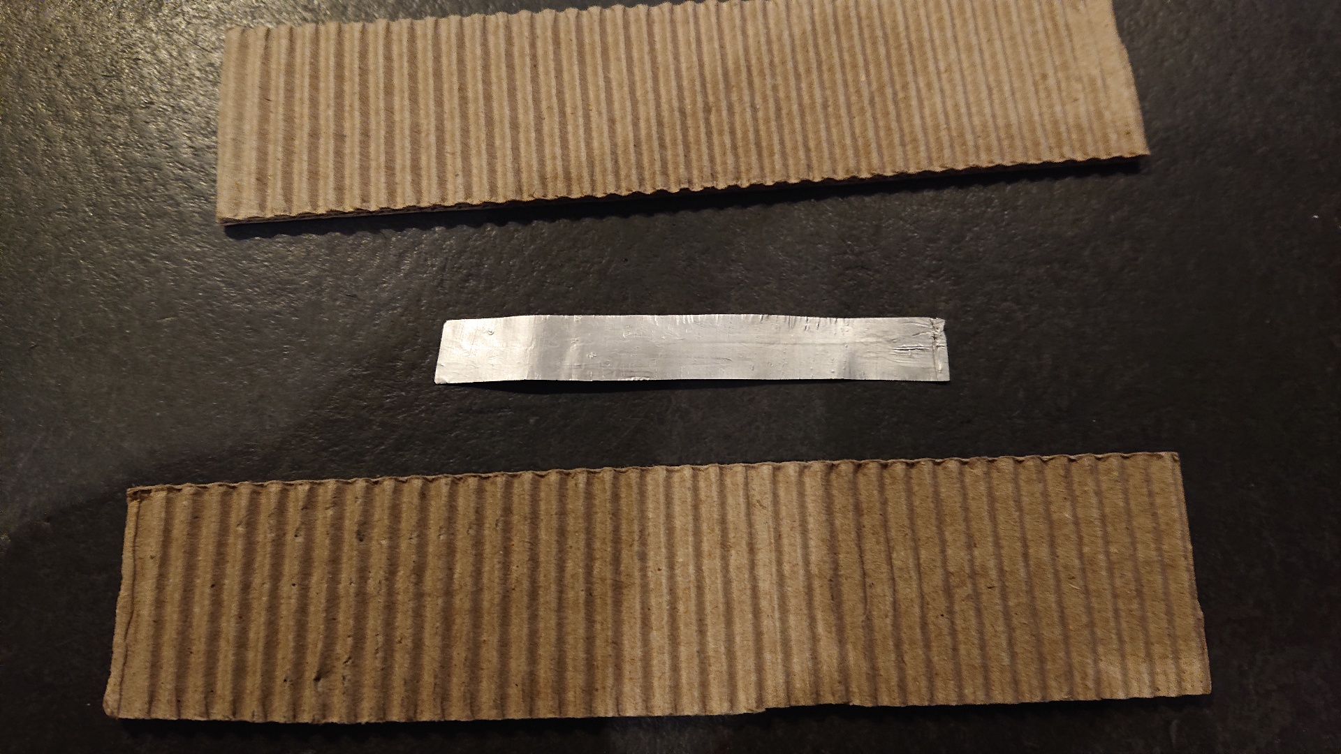

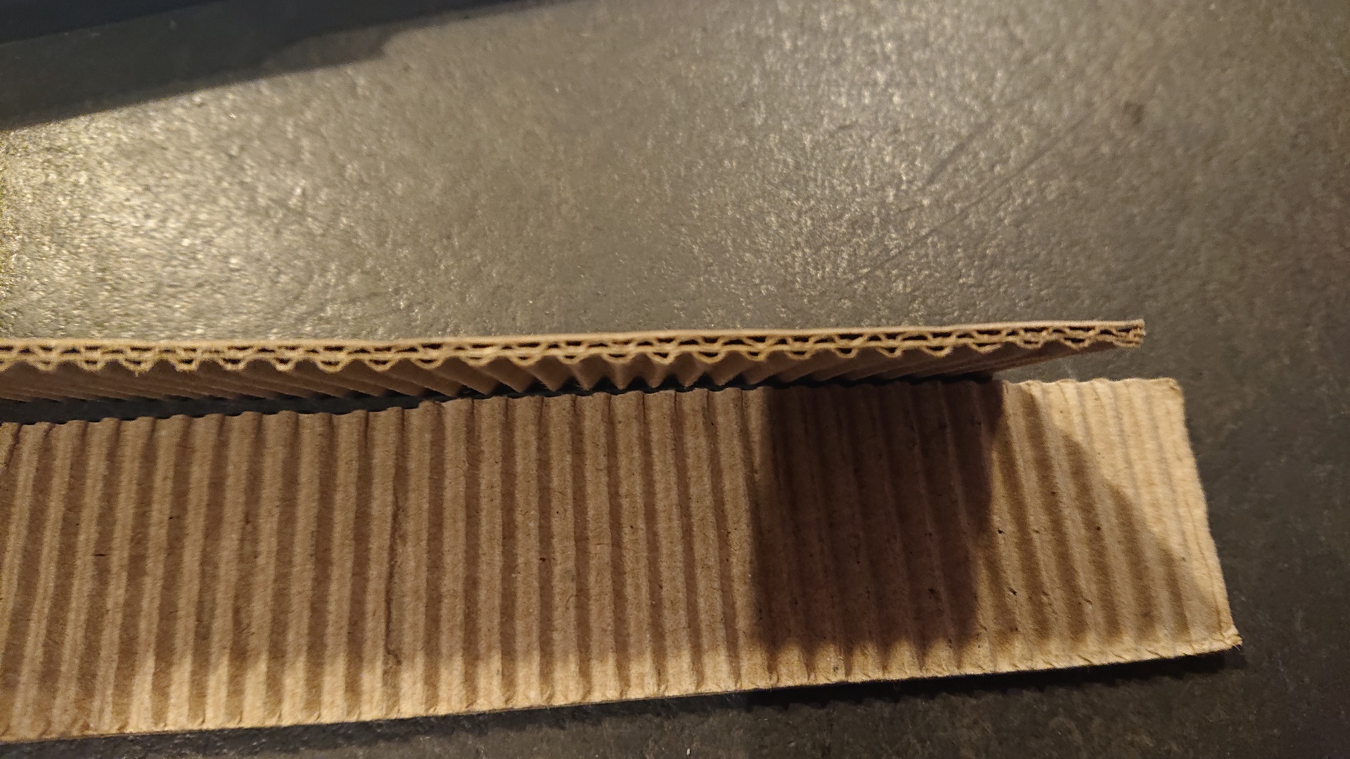

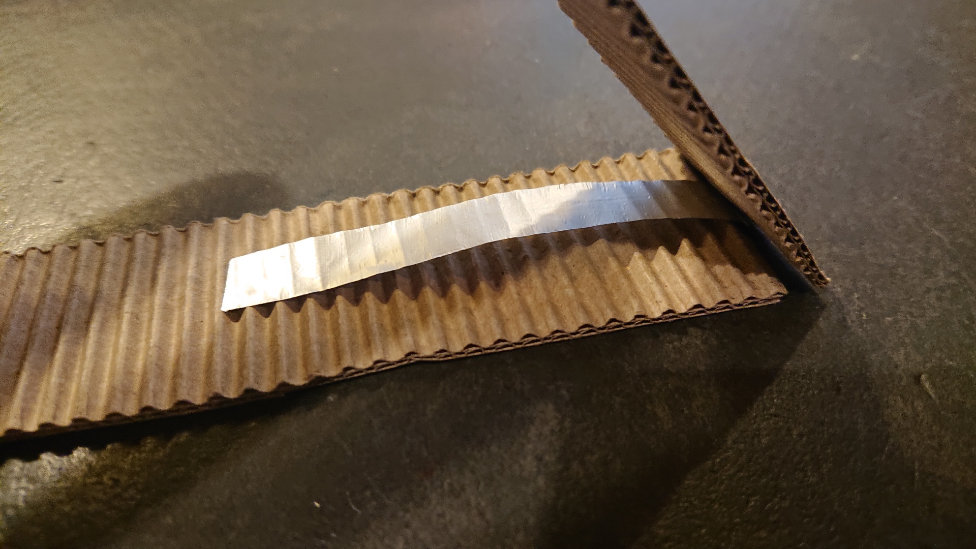

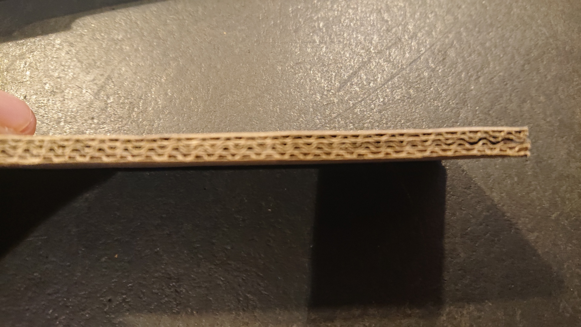

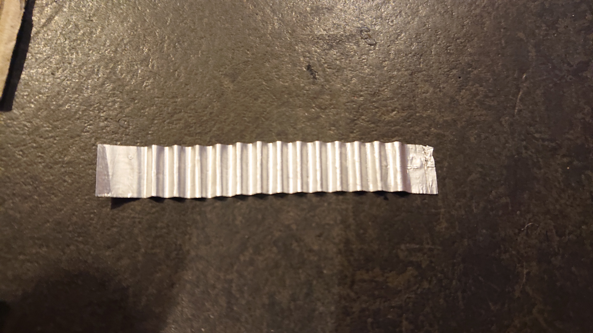

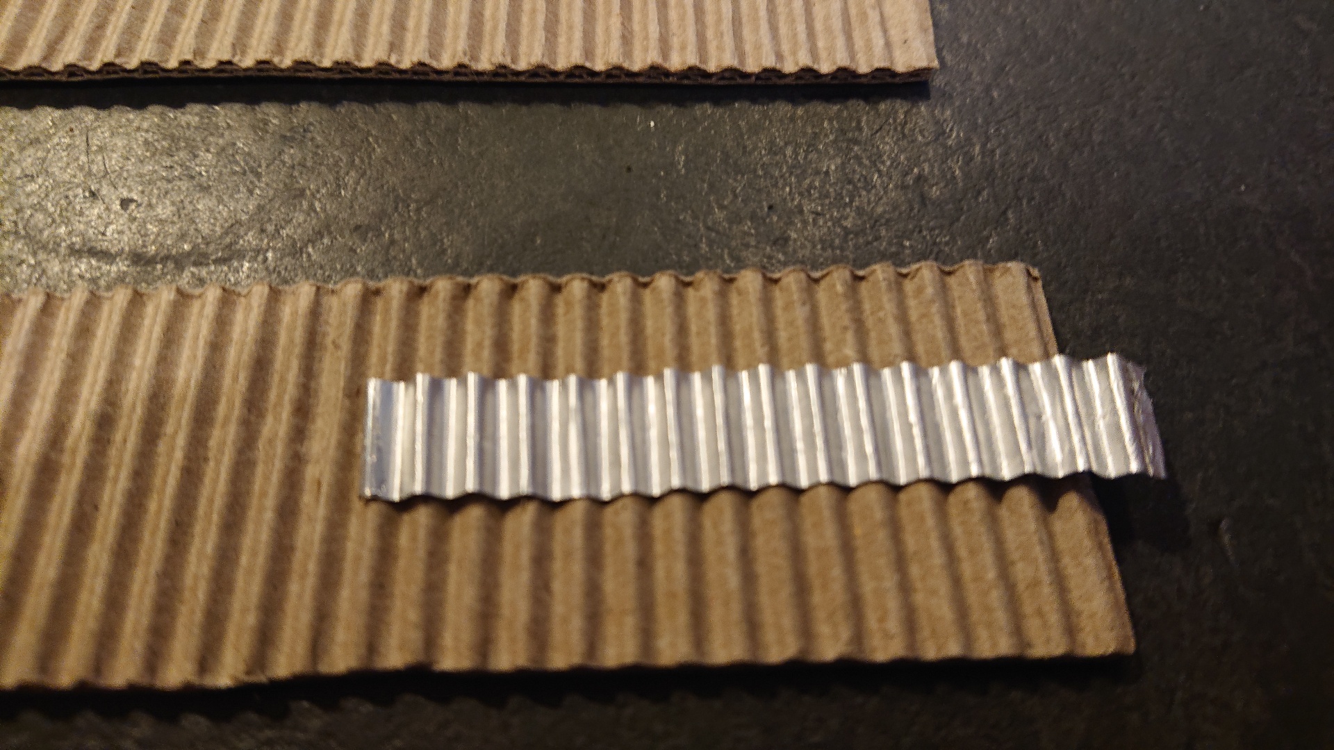

So I started to roll my own. It's quite easy, see pictures.
The final step is to cut the frame into two by drilling the nails that keep them together. All you have to do is align the new ribbon in the frame. First mark where the old ribbon was, remove it and insert the new one. some small pieces of tape will help. I have clamped the frame together with again with tape, it's going to be pressed together by assembling the driver anyway so no need to use nails.
Don't be afraid to try, you have got nothing to lose. I have done this a couple of times with ordinary household alu-foil of the thin kind. It took me 5 to 6 tries and a bit of frustration to get it right, but nowadays I can repair one in five minutes.
I have a pair of Decca London's, one has the original ribbon, one my with own repair. Apart from a 1,5dB difference in efficiency they do sound the same.
The pictures are just for example offcoarse. You can make much prettier ribbons this way by starting with a clean, flat piece of aluminium and some more care than I did in this 30sec example. It took more time to take the pictures then to cut the foil and roll the ribbon.

Hi Sjef, thank you for the details and the photos.
I will attempt to do my own ribbons
I was mainly worried about attaching the ribbons properly to the terminals.
That's the most delicate part indeed, but you'll figure it out. It's like baking pancakes, the first two always fail. One evening of a little frustration but then you have learned it for the next time(s). Alignment goes best with one half of the frame in the magnet assembly and some wooden or plastic tools.
