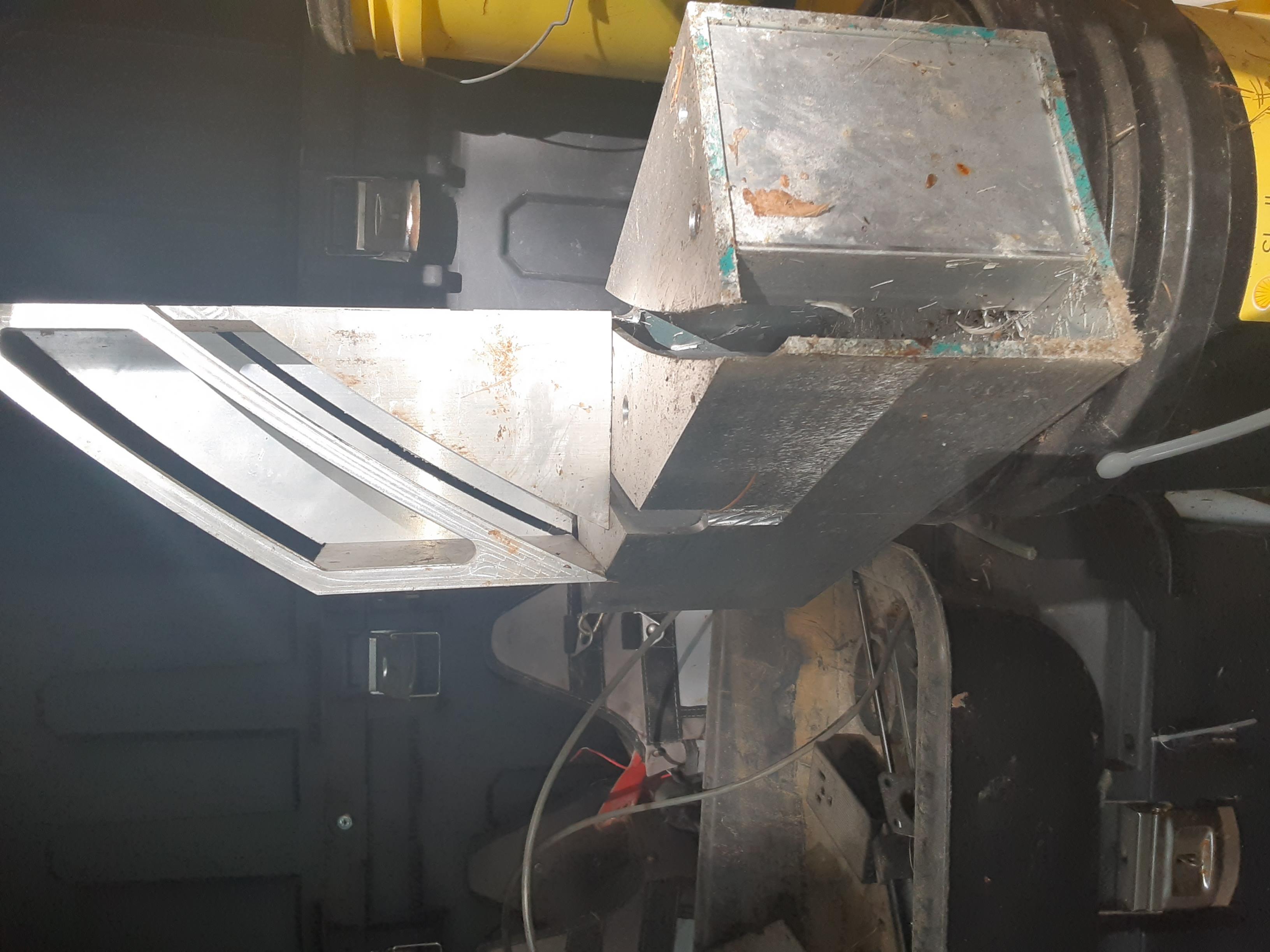

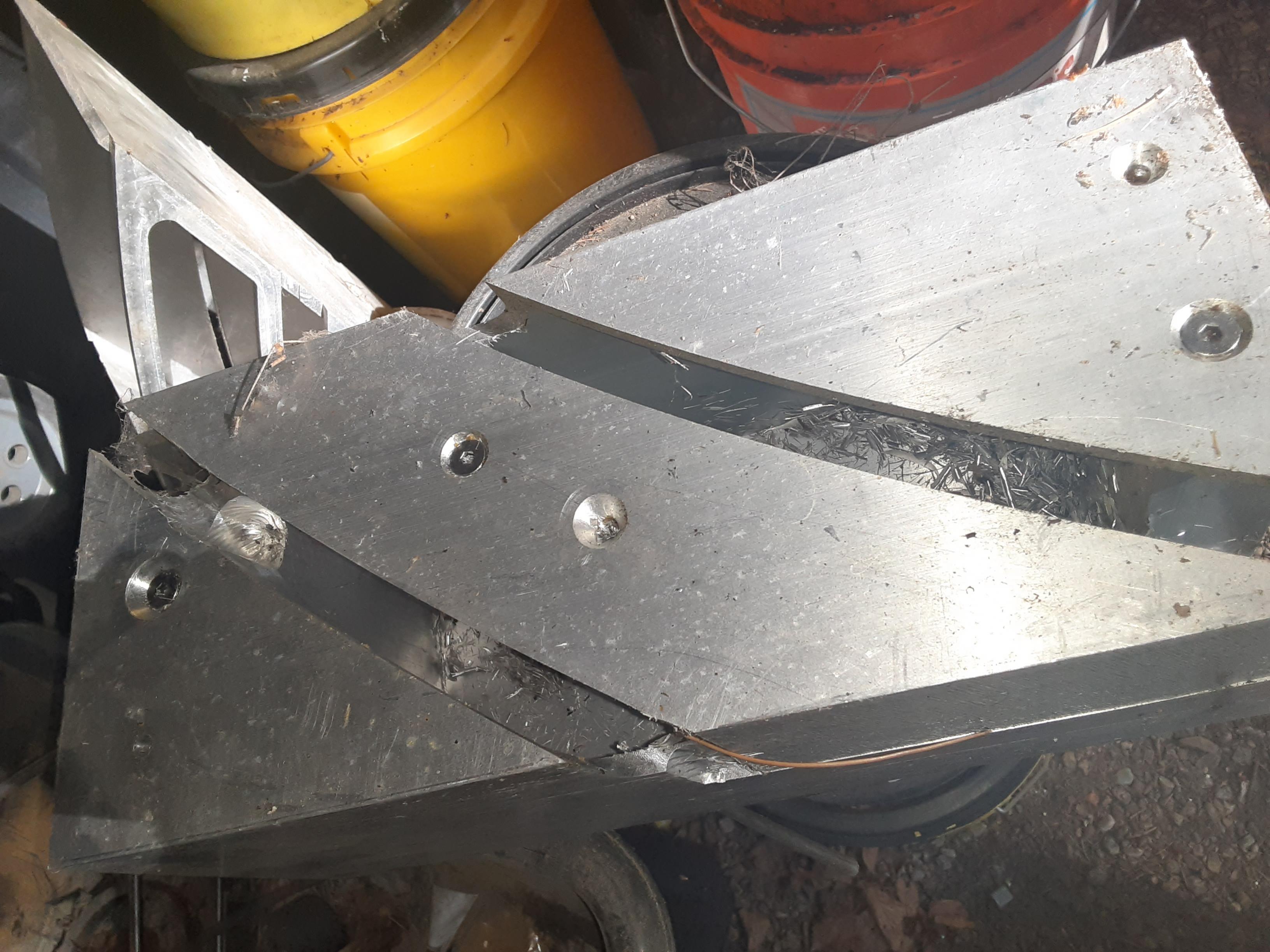

That looks like 1/8" wall on the square tube in the photo. Just food for thought; I milled some of that stuff with 1/4" sidewall and the resonance was so loud that I had to use double hearing protection to even be in the building during the cutting operation. Eventually I had to install internal bracing just to cut the stuff and I eventually scrapped the project.
You can see how bad the chatter was even after three massive blocks were fastened internally to stiffen it up.

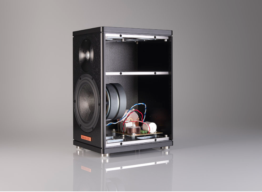

Right. I've studied the Magico A1 construction very thoroughly and can add some details about the Al cab. They used 3/8" plates for the sides, front and back. The top and bottom are much beefier approx. 1" thick plates (this is how they conceal any fasteners, very clever). Finally there is an additional internal baffle between the drivers.
This is a very economical construction and much easier to deal with than tubing. When dealing in aluminum, 3/8" is probably the minimum thickness you would want to work with. 1/2 or 3/4 would be a lot better. Also, flat Al plate is much more economical, so you can get 1/2", or whatever, plate off ebay and bolt it together, minus the fastener concealment trickery of the Magicos.
Edit: If thicker material creates tooling problems you could use whatever thickness your tools will handle and make a honeycomb laminate, again using 1/2" thick nomex or Al honeycomb core (just like the Magico Q).

I machine stuff that is VERY prone to chatter, adding a blob of blutac ( and ear defenders - I value my hearing! ) makes a world of difference. If I were to machine square alloy extrusion, I'd be tempted to wedge some wood inside.

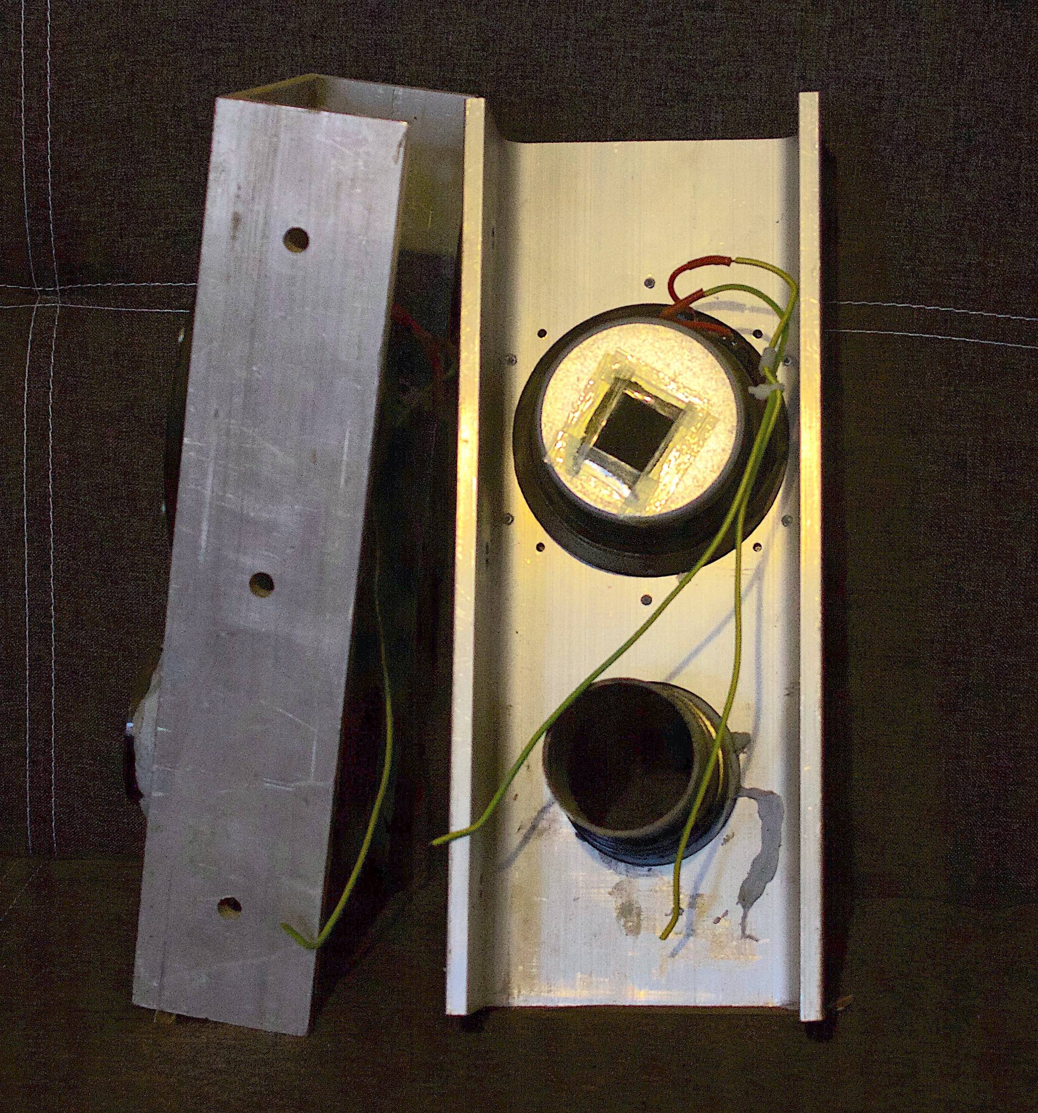

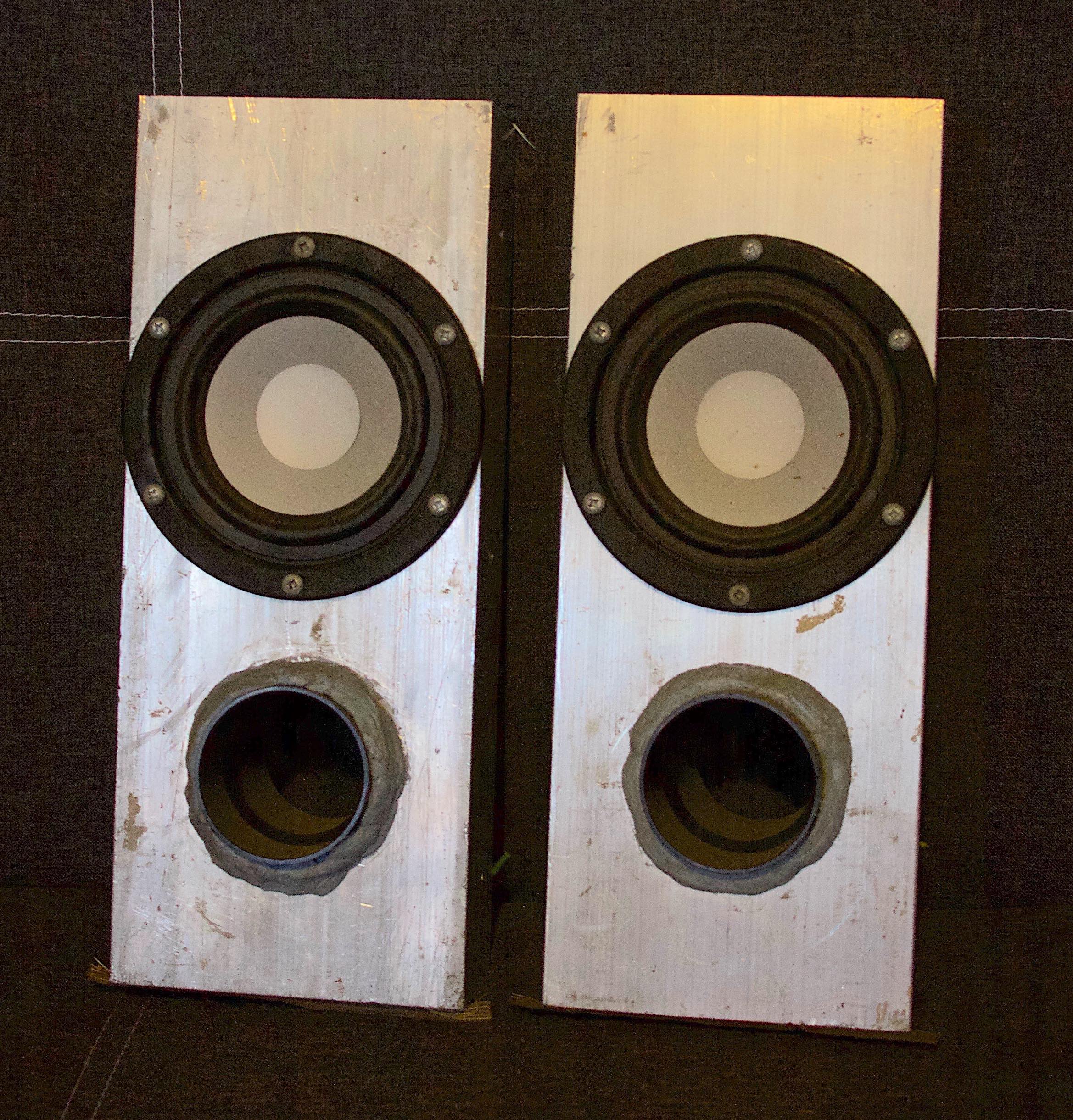

This is a real step forward. I have another 2 pieces of aluminium I can make into cabinets. These are fronts only, but thicker. Front is 8mm, sides are 10mm. I was wondering about making the back and sides from wood, but I could use aluminium. I have some braces that would work well to screw it together. Width is 155mm, height 380mm.
