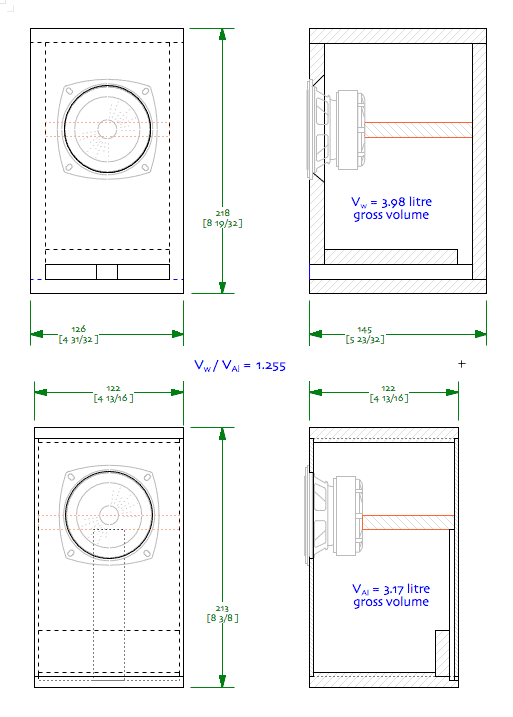

I have an aluminum boxed project in the works, still need to decide on some of the detail. The 3-4mm Al makes for a significantly smaller box then with the 12mm ply we usually use -- it is for a 3" FR.

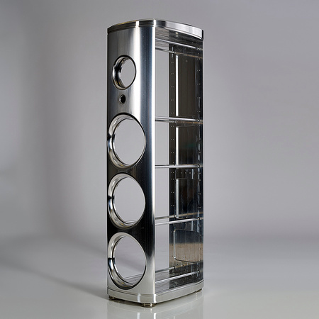

To give an idea about the Magico enclosure:

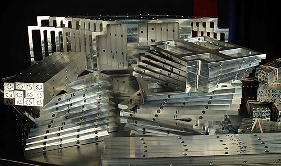

A couple of Q5 parts...
attachment.php
attachment.php

Crazy huh? :D I wonder how many bolts and pieces are in there...

Aluminium won't be the easiest material to use, just look at what Magico does to "control" their resonances...

Not significantly.
Most you can gain is (12-3)*2=18 mm for any dimension (L/H/W)
Can´t imagine a room so small that saving 18mm on cabinet size makes it usable or unusable :confused:
By the way, IF such a small room existed, I doubt the listener himself could get inside.

In this case the room is a breifcase, so the 25% savings in volume is significant.
attachment.php
The aluminum comes in the form of a cyclinder (w rounded rectangular base / 4mm walls) recycled from an external RAID case. Top & bottom will be plywood.
dave
