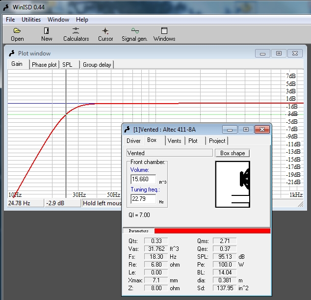

Does the subwoofer have to be OB? The lowest Altec in a vented box is the 411-8A but it requires a HUGE 15+ c.f. cabinet - see attached. I have a pair I need to try sometime.
I like the Eminence Alpha 15A in an H-Frame per MJK for OB. Some don't like the small magnet and opt for the Beta 15.
