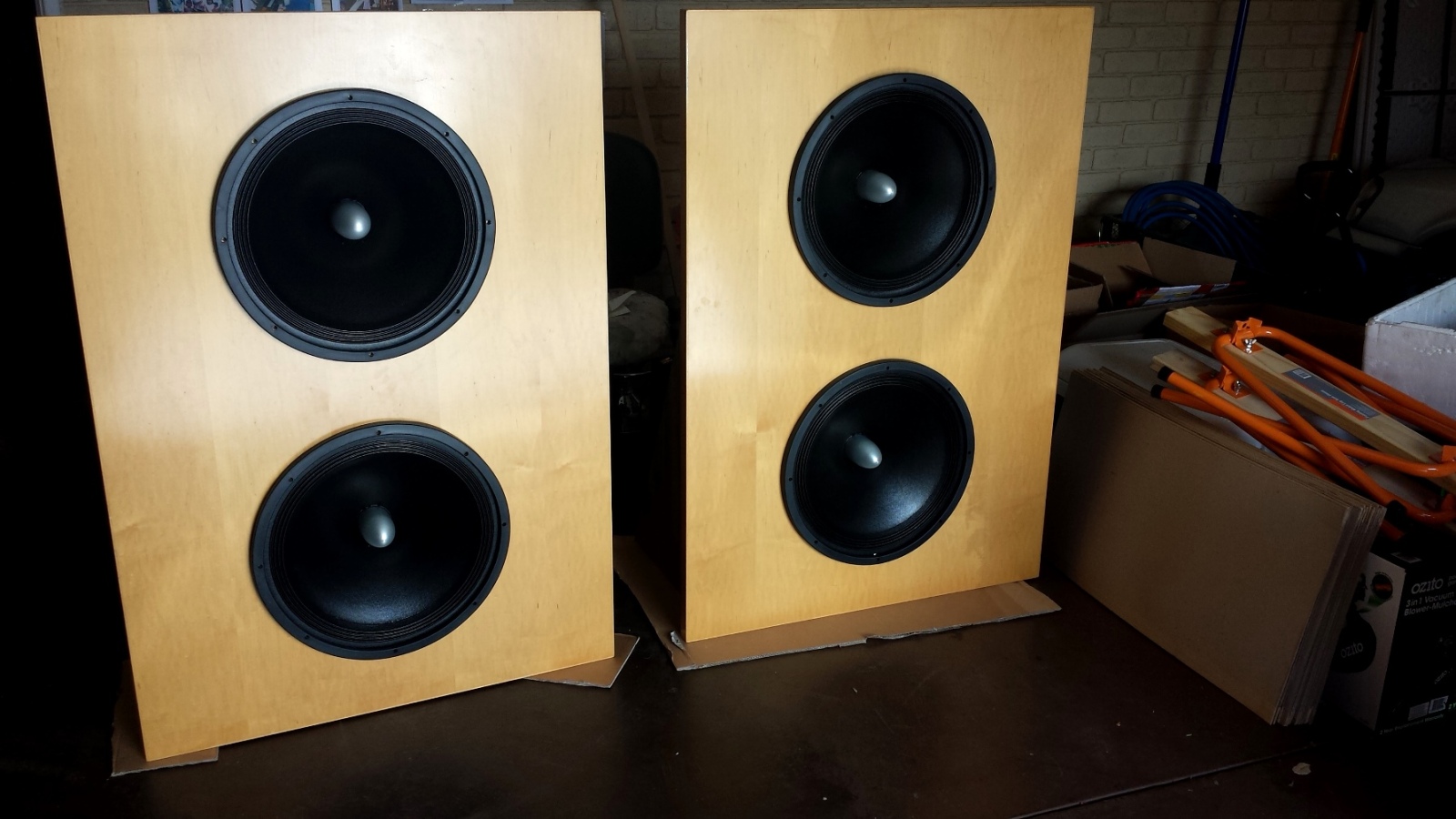

I am using Altec 416B original vintage drivers as bass drivers in 3 way open baffles. The crossover frequency is 90-100Hz.
Despite using a 1000W ICE amp and mini DSP to drive just the bass drivers, I remain disappointed by the bass output in terms of impact. Am I wasting effort on this vintage drive to deliver the goods and what would you recommend I switch to?

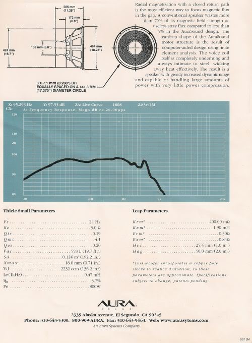

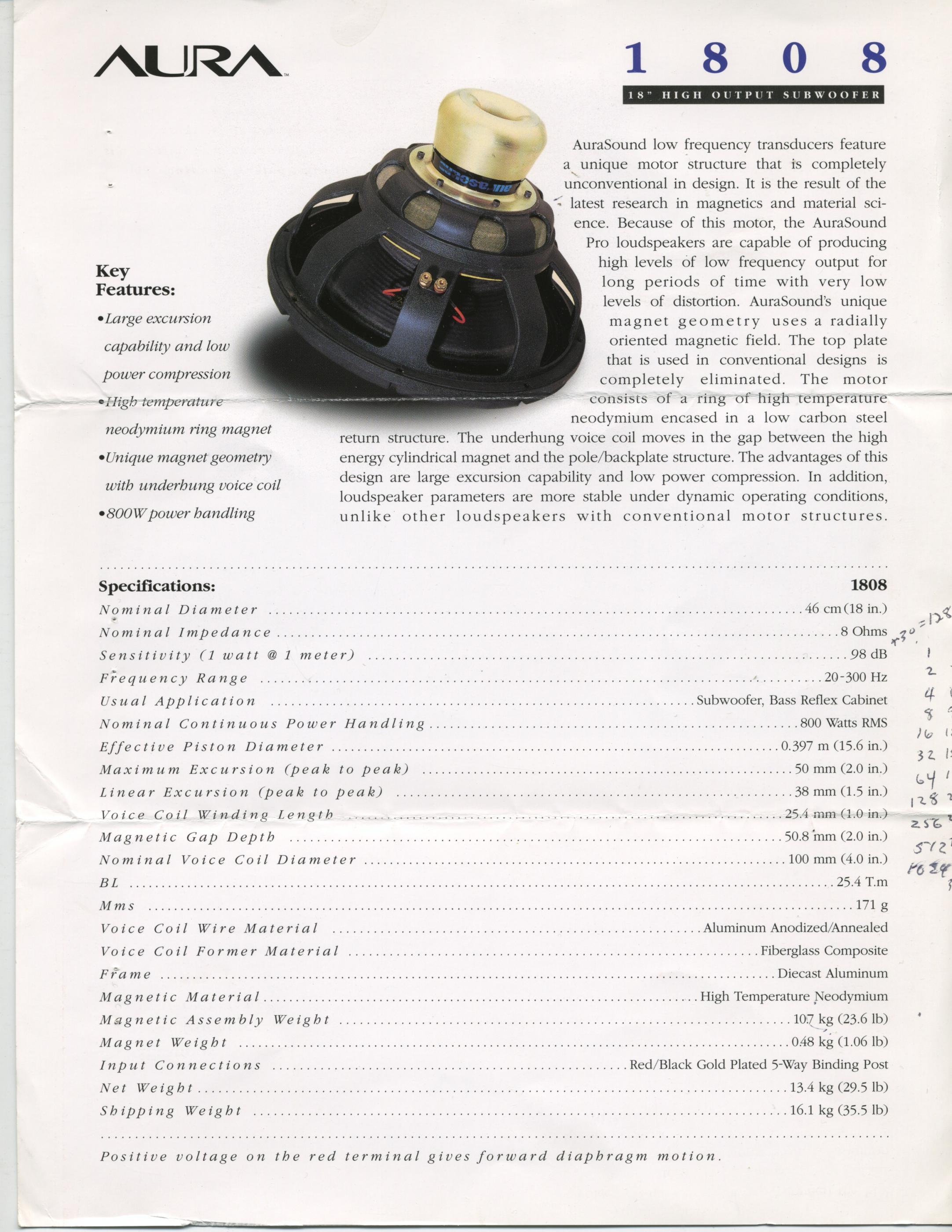

If you can find/afford some: https://www.diyaudio.com/forums/att...te-bass-horn-design-question-aura-1808-p1-jpg

Qts is pretty low (0.19) for OB

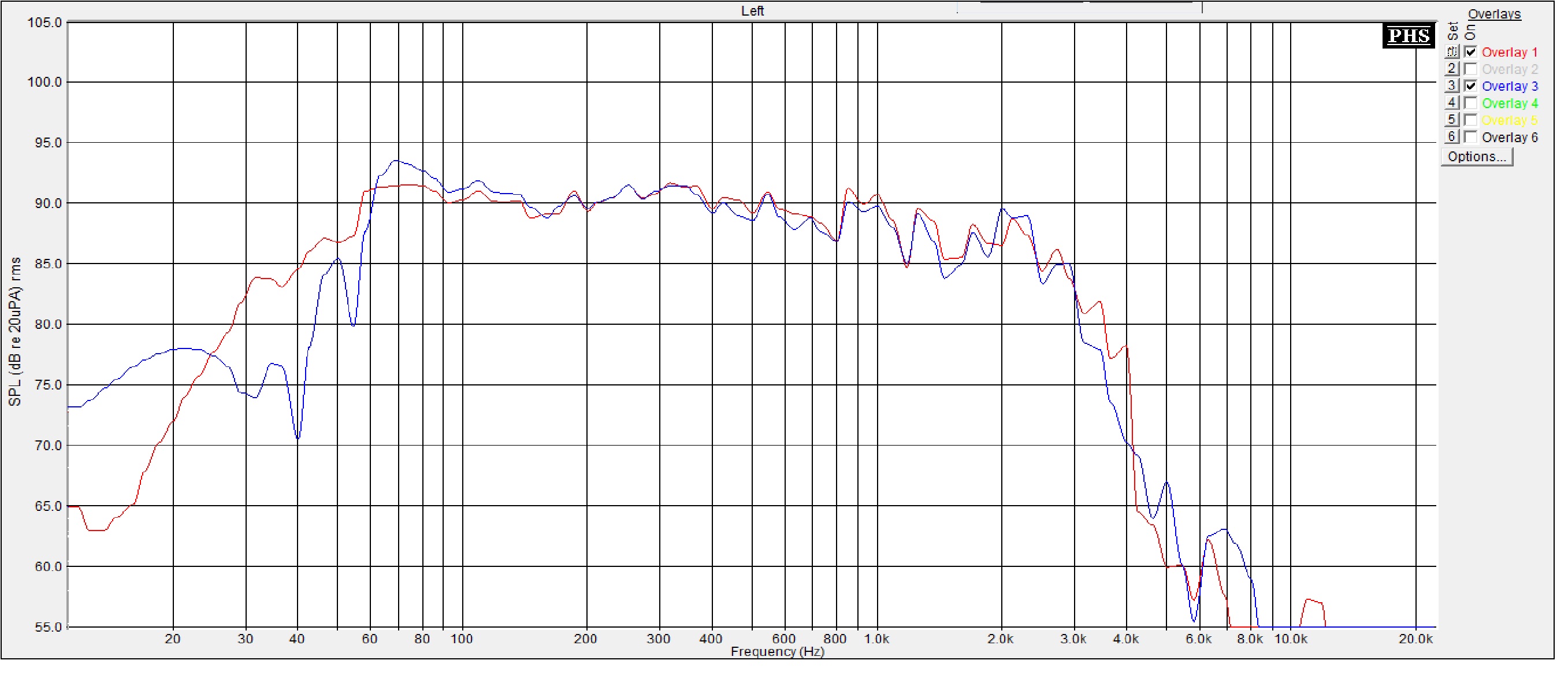

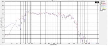

Very bad, you made a lot of mistakes.I am using Altec 416B original vintage drivers as bass drivers in 3 way open baffles. The crossover frequency is 90-100Hz.
Below is the measurement of Altec-416-8A, which I put in a ported box = 180 liters. The red curve - the port is closed, the blue - open. A-416 needs a high-quality amplifier of small power and a cross-section frequency of 700-800 Hz.

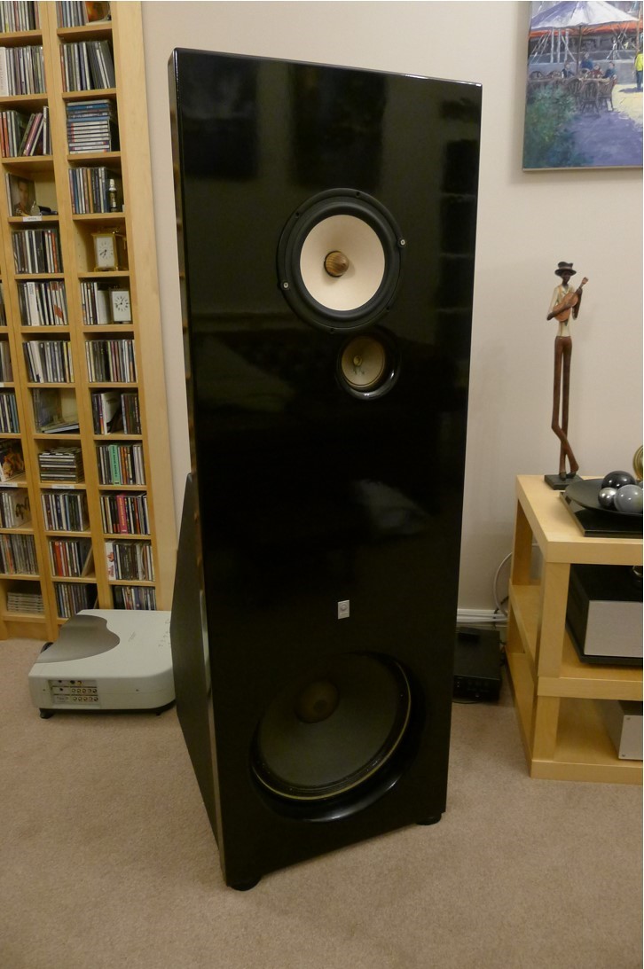

1. What is your baffle size and type? U, H, W, no baffle?
2. How close is your woofer to the floor and also to the front wall? Is there a gap btw baffle and floor?
3. Altec is great for hf extension; not much point in using it under 100hz... Subwoofer territory.... I would go for a woofer with higher xmax.
4. There might be sth wrong if the cone is not moving with 1000w... Be careful you can damage the drivers...
5. What is your dsp setting for bass boost if any?

Front panel 4ft by 2ft as photo.

The OBs originally had Saba Greencone mid-rangers which are relatively limited in SQ in the bass region. They were crossed over at 600 Hz and thereby made good use of the vintage Altecs.
In a process of improvement the Sabas have been replaced by SEAS Exotic W8 drivers which easily out perform the Sabas and are quite happy to sing down to 100Hz. So the 15" bass drivers are only called upon to work below 100Hz and hence my question.

This has always intrigued me. No matter what music I play I have never seen the cone on my Altecs move (and yes it is connected). Is this normal for 15" drivers in OBs?
No! Especially such a low Xmax driver as the ~5 mm 416/515 series, so either you're not playing it loud enough to move it or not low enough BW or it's just plain broke.
FWIW, even with corner loading, my dual 20 Hz Fs 515Bs tuned to ~14 Hz will move a good ~ 3/8" p-p on DSOTM, so a single driver will move up to 4x more for a given power out in the room.
My SWAG then is the baffle's way too small combined with too far out in the room and maybe even you and/or it is positioned in a room null [an all too common a problem IME].
