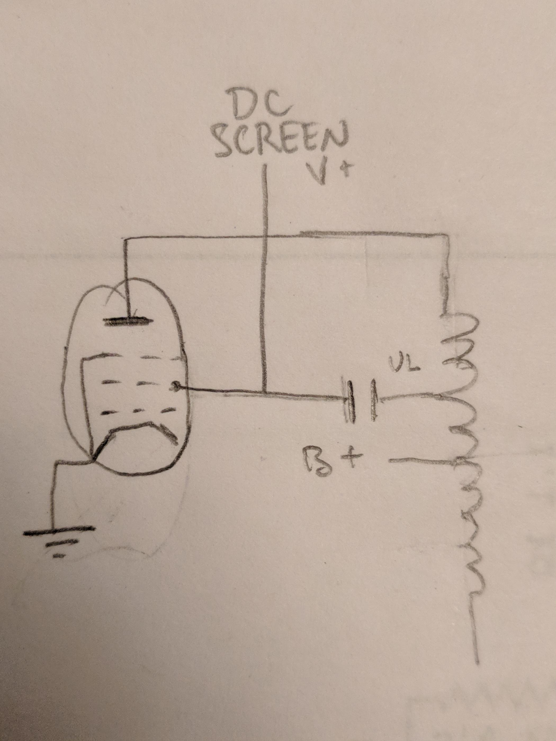

AC-coupling ultra-linear transformer (capacitor?)
Another question concerning an ultra-linear push-pull output stage.
Suppose we have a tube with a screen grid voltage rating lower than its plate voltage rating by 0 to 40%. In order to operate the tube near its maximum plate voltage, we would normally use a transformer with a separate ultra-linear winding rather than a tap on the primary (such as the Acrosound TO-350). This way, the ultra-linear winding only acts as negative feedback (AC-coupled to the screen), and the DC screen voltage is provided by a separate DC supply.
I am wondering, given a standard ultra-linear transformer (one primary winding with 40% voltage tap), could one simply use a coupling capacitor in series with the screen grid, connecting a separate screen DC supply after the capacitor? If not, why not?

You proposal is an headhace not necessary 🙂
It is not necessary if you have a transformer like the TO-350, but I am wondering if it will work since I will be using an Edcor transformer.
For example, 6146 or 6QD6 with 600V B+ and 250V screen would require AC-coupling on the screen for ultra-linear operation.

@ahanuban - you can try, but it may have issue with the screen voltage getting dragged down too much by the AC-coupled screen feedback voltage, which means very low output.
I'm a little confused what you mean by that (the screen voltage would be lowered by the feedback). How would the effect of capacitor coupling be different than using a separate transformer winding?

Walter, I'm really looking for an answer to the question about capacitor coupling. At this time I am not interested in purchasing new output transformers from Sowter ($$$). 🙁
It wouldn't drag down the DC voltage. I think what he meant was that the (presumed) DC feed resistor to the screen grid is effectively in parallel with part of the transformer winding, i.e. it reduces the overall anode and screen load impedances, compared with 'ordinary' UL. However, this could be made negligible or 'designed in', so your idea is sound in principle, at least for class-A where average currents remain substantially constant.I'm a little confused what you mean by that (the screen voltage would be lowered by the feedback). How would the effect of capacitor coupling be different than using a separate transformer winding?
EDIT: And as Jazbo points out below, the down-going swing, when added to the DC screen voltage, could drop too low or even go negative. But of course, we assume you would choose a tapping point that did not go too far (this would normally qualify as distributed loading rather than ultra-linear).
What are the swings of the plate winding and the screen winding if B+ is 600V? Since screen grids are fed by a separate low B+ (250V in your example), what is the net voltage seen at the screen when the screen tap of the OPT swings to -250V...I'm a little confused what you mean by that (the screen voltage would be lowered by the feedback). How would the effect of capacitor coupling be different than using a separate transformer winding?
Another fact, looking on schematic.
The ac signals from cap goes to ground because the C on power supply of +dc screen is a short circuit in ac !!
