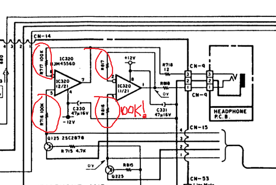

I know.You are the first one i saw talking about lm833 benefits in the past and there must be a reason why Philips used it extensively after ithe DAC in their cd-players instead of ne5532.I have a friend who looked at improving some of his cd players and in the end he realized that lm833 sounds very well and there was no need to change them although he's hearing very well up to 17500kz.I can only hear 13800hz...One other thing that is really interesting with lm833 is that he's louder with the same feedback network and input than every other op-amp i tried as i/v converter.
you might find this Nakamichi headphones amp used in NAK Cr-4 really interesting.Actually is the only headpnones amp that sounds well in all nakamichi cassette players as they used class b output in all the others:
Wow, in the year of the lord 1988, I heard the CR-4 over headphones with my test cassette and thought that it sounded very good but was convinced that the drive mechanics were not responsible cos it was not really better than the old ones.
Thank you clearing up an old mystery for me.
