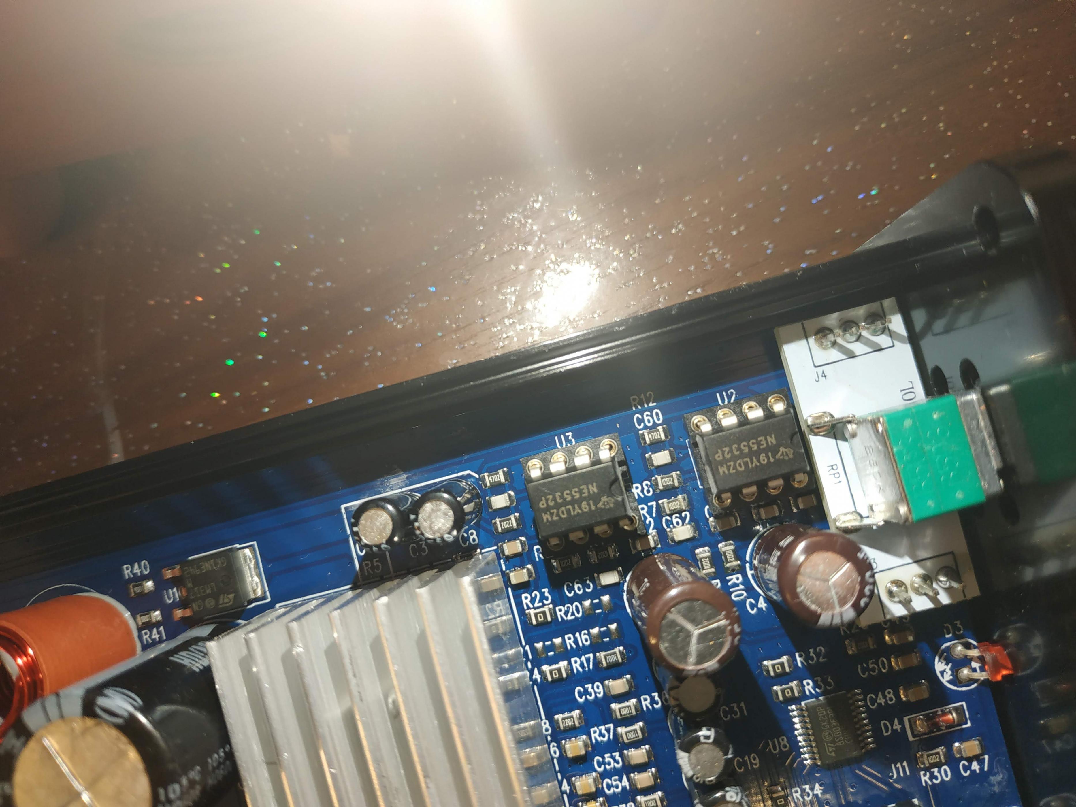

I've attached a pic of my amplifier, must say the 5532 seems like the original...

At first I was like you, hoping that they were real...
If you pull out your china NE5532's and compare them to real Mouser or Digi-Key bought NE5532's or any other real Texas Instruments Op Amps you'll see that the Ti Logo is different under high magnification when compared to the china Op Amps.
