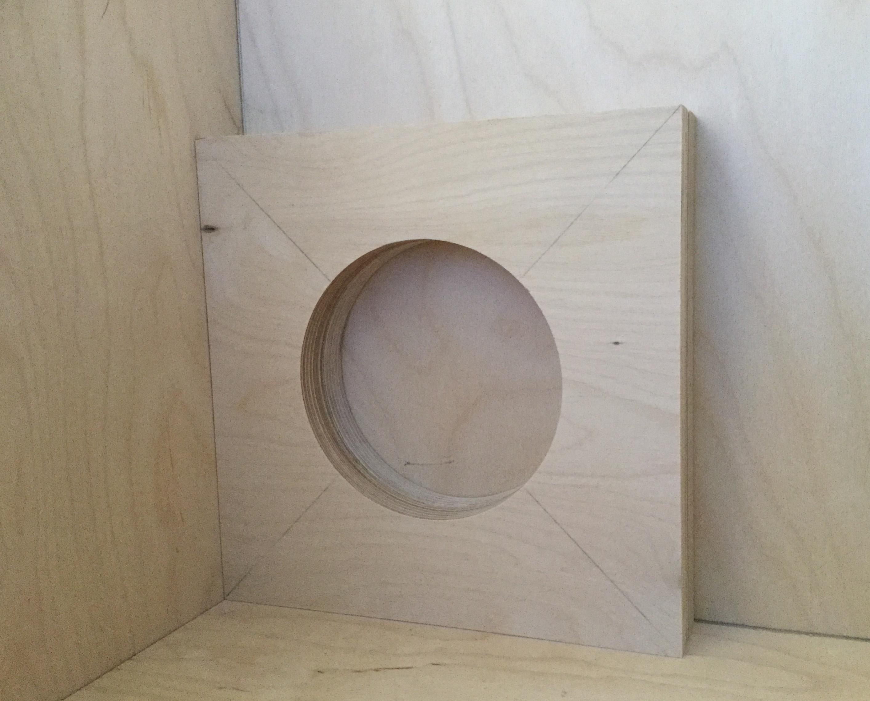

Make an MDF template (see, it is good for something 😀) and rough cut with jig saw, then clean up with pattern following bit . I find that works much better with BB plywood than plunging by hand - unless using a massive router such as the Porter Cable 7519. If you want to get really fussy, the radiused inside corners can be squared up with a Douzuki draw saw .
Great advice. Going to try to get this going for the weekend. That should give me time to make some practice cuts first. Hopefully the home store has what I need.

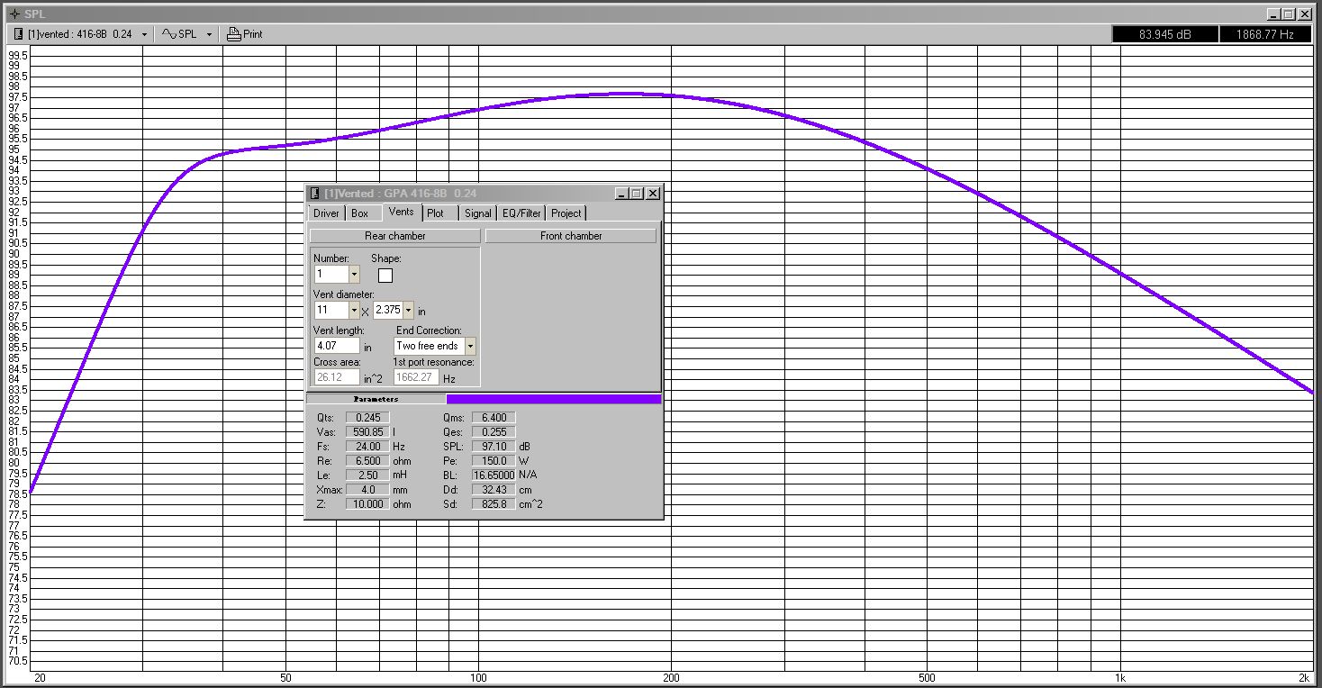

WinISD sims calculate that a rectangle port of 11" * 2.375" must be 3.4" - 4" deep to pass the modern Thiele/Small ported box math. .....MUCH DEEPER than 0.75" plywood.
So,
Do you trust old school Altec?
Do you trust 40 years of Thiele math successful designs?

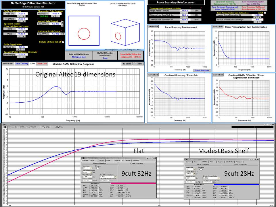

THE BIG PICTURE: For low frequencies up to about 200Hz, room interaction from the floor and walls will have a significant affect on the bass SPL shape. Hence, the flatest in-room SPL often comes from a "bass-shelf" cabinet alignment where the cabinet+port are tuned for a downward sloping SPL which complements the rising wall gain. For the GPA 416-8B, a port tuning from 32Hz for a flat SPL, down to 28Hz from a longer port bass shelf could be optimum for your room. Diffraction and Boundary Simulator is a free tool you can use to optimize speaker-room placement and bass port tuning.
Two 4" diameter ports 4.45" long provide F3~32Hz in 9cuft cabinet volume still looks like a good generic tuning.

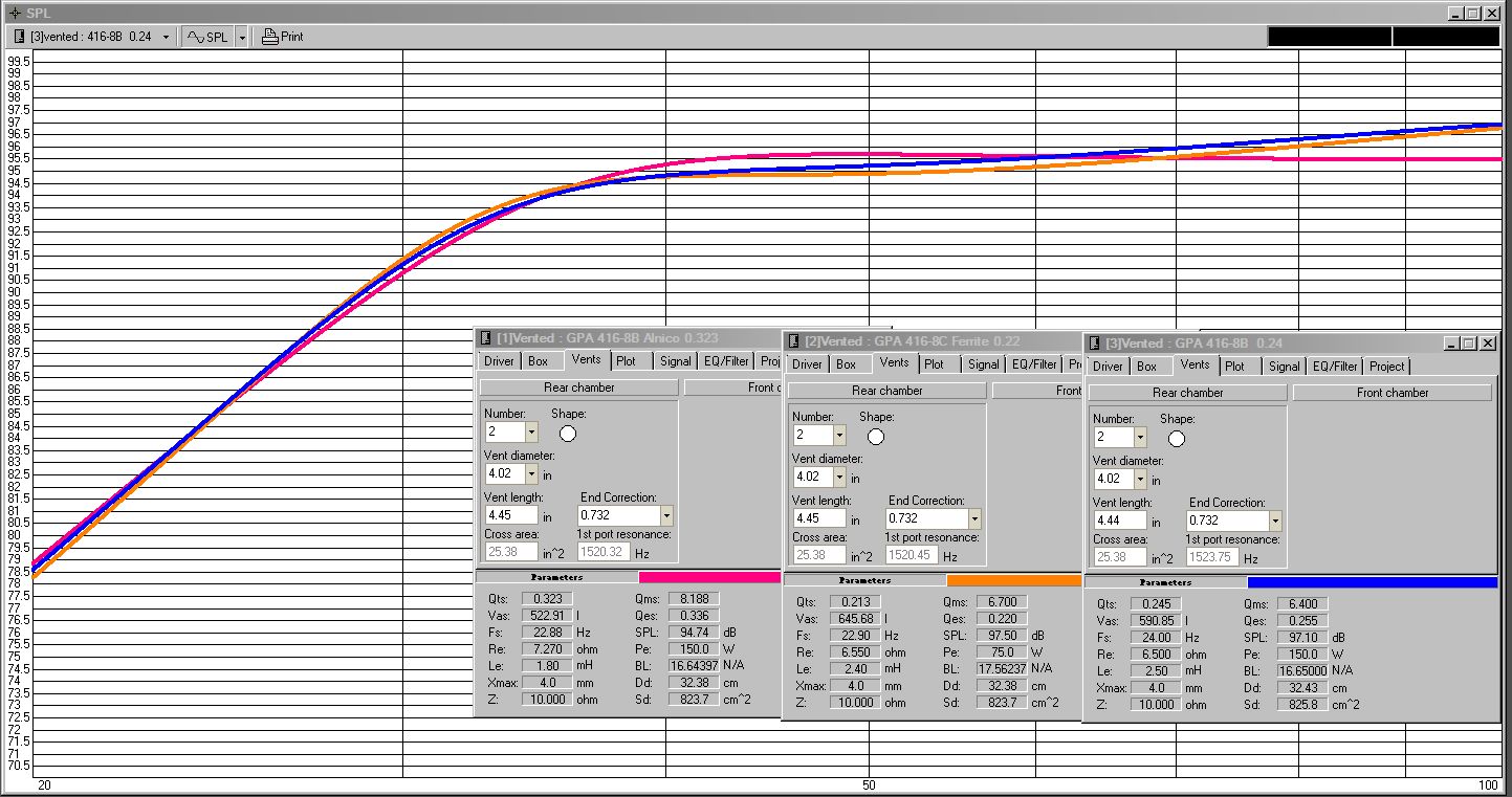

FROM GPA DATASHEETS:
--GPA 416-8B has has an Alnico motor with Qts ~0.336
--GPA 416-8C has a Ferrite magnet with Qts~0.22
I could not find a 416-8A in the GPA products. Did GPA re-cone an old Altec driver?
If you own the GPA 416-8B:
--two 4" diameter ports 4.45" long provide F3~32Hz in 9cuft cabinet volume.
--two 4" diameter ports 4.93" long provide F3~31Hz in 9cuft cabinet volume.
--two 4" diameter ports 5.47" long provide F3~30Hz in 9cuft cabinet volume.
---from the simulation, F3 ~ 31-32Hz has the flattest SPL
for a 0.75" plywood only port....11" x 2.35" x 0.75" has F3 ~39.7Hz port tuning for 9cuft volume 9396Hz resonance
If you own the GPA-415-8C, then
--two 4" diameter ports 3.24" long provide F3~35Hz in 9cuft cabinet volume.
--two 4" diameter ports 3.61 long provide F3~34Hz in 9cuft cabinet volume.
--two 4" diameter ports 4.01" long provide F3~33Hz in 9cuft cabinet volume.
---from the simulation, F3 ~ 35 has the flattest SPL
for a 0.75" plywood only port...11" x 2.35" x 0.75" has F3 ~39.4Hz port tuning for 9cuft volume 9664Hz resonance

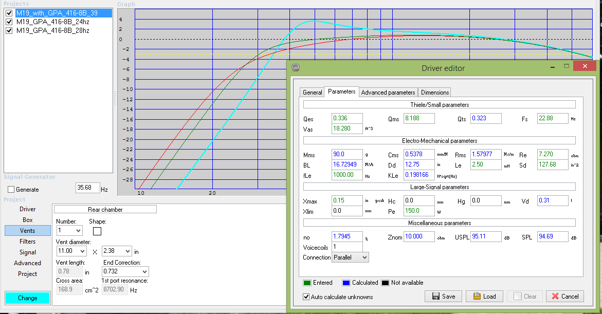

EarlK, thank you for the sims, and no, I would not want the 3+ db bass hum at 48Hz, even though I live on the west coast ; )
So my latest thought of going with a slot port reveals it does not sim as nicely as the 2 round ports discussed earlier.
Thank you LineSourece. I'm comfortable with the 4 inch diameter round ports tuned to 31-32 Hz with 1st resonance higher than crossover.
The cabinets will be placed in music room in corners near boundary wall. Using 2 ports I can adjust in room using Zilch plugs (it worked for me before).
I realize my approach is rudimentary, especially compared to others on this site. It is DIY though, and I appreciate everyone's input.

Just out of curiosity, for those with the simulators, what size port do you end up with if the depth is locked to 0.75"? If tuned to flat or mile bass shelf. Thanks!
For a 4" diameter port, some cabinet builders glue a second 8" wide plywood strip centered in back of the port hole for both bracing, and to allow routing a quarter-round flare into the front panel. You might consider a full-width bottom brace board which also provides double-width support for both of your bottom ports. You might find a clever way to integrate this port support panel with your internal bracing.
I have glued two plywood strips to create a 2.25" thick stack behind the port hole. This allows routing a quarter-round flare into the front panel, PLUS for infrequent port length changes, you can drill a measured set of holes into the plastic pipe which match pre-tapped wood screw holes in this 3-thick wood, and use a ratchet handle screw bit.

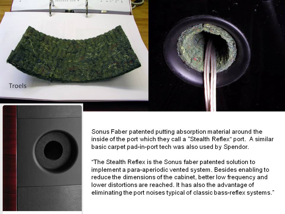

Sonus Faber patented putting absorption material around the inside of the port which they call a "Stealth Reflex“ port. A similar basic carpet pad-in-port tech called "linear flow ports" was also used by Spendor. Troels puts carpet-pad-in-port when the burst air speed is high. A bass tune option which does not require port length change.
Pano: For GPA 416-8B Alnico with Qts= 0.323, a 3" x 3.8" x 0.75" deep port has flat 31Hz tune for 9cuft volume with 8901Hz first resonance. A modest bass-shelf would require a slightly smaller area like 2.6" x 4" x 0.75" for 30Hz tuning frequency. Thats alot of air to move through one small slot. I suspect the old School Altec 11" x 2.375" x 0.75" baffle port which tuned a 9cuft volume to 40Hz produced reasonably flat and dynamic bass when the cabinet was placed against the rear wall, and a few feet from the side walls. Perhaps the Altec engineers desired to avoid small room BOOM BASS when the owner would never adjust the porting.
Thanks Linesource.
That is a surprisingly small port area. I'm not sure why, but I've always ended up with somewhere around 50-70% of cone surface for the port. It's what worked best in room with big boxes and light cones.
