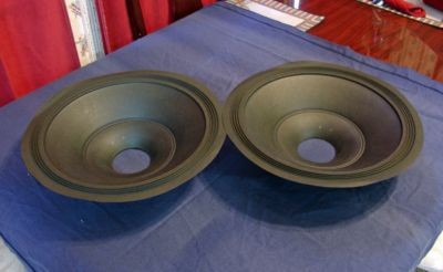

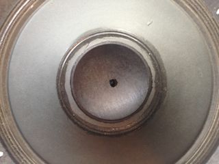

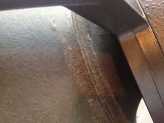

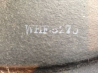

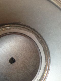

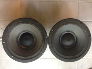

These 416-8B's sound fine and came from a discerning friend who had them in 8cu.ft sealed. They had been re-coned by a very experienced speaker guy, in the business 50years. At first I thought they were spliced and now I wonder if he used 420A Biflex cones. There is a marking, WHF-5270 on both cones. The marking is up near the spider on one and near the surround on the other. It would be nice to know what this is about. But empirically, they sound fine in home use. I have a Dayton WTF-3 and just ran the drivers. The serial numbers, #07862 and #38650, don't seem close and the T/S are enough apart that I wonder if the inside volumes of the cabs will be different. But that is what old hard back books are for and I have enclosures that are time capsules with magazines from 30 years ago I am discovering (and in awe of what a $ used to buy).
I will try and attach the tables and a few pics. I appreciate your taking the time and value the experience you bring to the table.
View attachment 416-8B #07862.txt
View attachment 416-8B #38650.txt
Ok. Wishful thinking about these being re-coned with 420A Biflex. I think I am onto the WHF-5270 as Waldom cones. The 5270 appears to be the Waldom 5270 duplex 3voice coil. So, is this a Frankenstein patched duplex? Maybe I got the number wrong, it is hard to make out on the cone. Well, they sound fine, regardless.
Bruce, if those are not altec or GPA replacement cones and voice coils, then it's anyone's guess what the resulting speaker parameters are. This makes designing or choosing an enclosure very difficult. The alnico baskets deserve a proper cone, and would recommend changing them. Helps resale value and looks too.

The actual and measured T/S for these mongrels are in the .txt files uploaded. They sound fine. Civilization as we know it is safe.

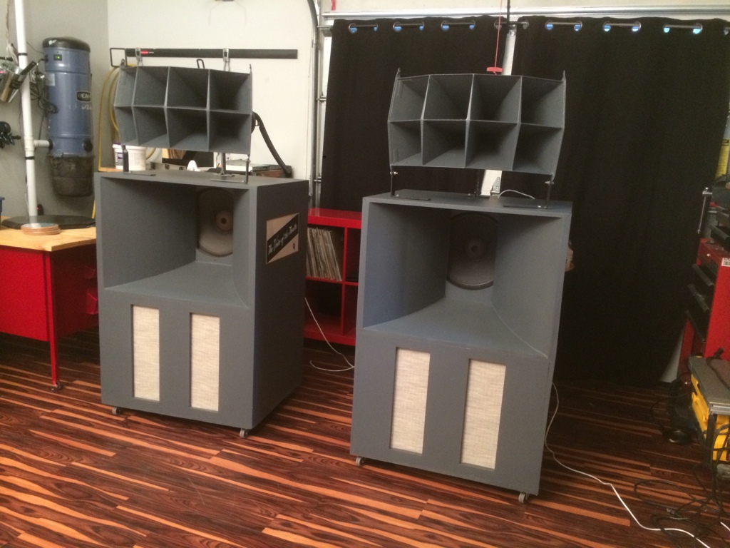

The best thing that I have done to my 828 cabinets was to inject foam within the cabinet in the area surrounding the horn flare. Doing that sealed a leaky box and damped vibrations that were coloring the sound. I was really surprised at the improvement!
FWIW, I've heard mixed results with foam and read about folks deforming and outright blowing out the horn flares when they got carried away filling them, so glad it wasn't an option AFAIK when I filled mine with oil dry [AKA kitty litter] to truly make them 'dead' once the horn's top and bottom were double layered with some scrap 12 ga galvanized steel 'filler'. Significant bracing, damping of the rest of the cab is required also of course as well as getting a good seal on the driver access cover.
Cal's right about getting a driver that best suits the needs of the app while still retaining the proper HF breakup modes BW the 800 series cab requires, so probably best to ask Bill @ GPA as he may need to custom tailor them same as Altec used to do and one reason there's so many 'different' 416, 515, etc., drivers around to confound folks.

Before I foamed mine I tried lining the backside of the horns with fiberglass. That helped seal the leaks but the flares still had (albeit different) resonances. I then bought a case of Great Stuff 'gaps & cracks' foam filler when it was on sale at the local big box hardware store. That did the trick.
