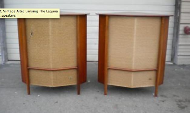

Laguna
I would actually give a limb for a pair of those Laguna's ! 😀

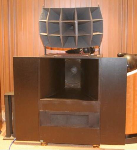

Dear friends. Please can anyone clarify for me what is the difference between Altec VOTT cabinets 825 and 828? I do have a plan of "named" 825 cabinet wich has a baffle width of 18inches, which did not achieve all the speakers width itself. Also I found at the web some DIY project which "has" the baffle width matching the internal cabinet dimension... I assume that the narrow baffle increases cabinet volume, so lower frequency shall be achieved...Please let me hear your thoughts and experiences on Altec VOTT, since I am planning to build a pair for me...Cheers. Marco - Brazil
Ignoring the various detail changes, the main changes are plywood Vs MDF construction, though some early 828s were plywood also; and the 828's reduced net volume [Vb] to accommodate the differing specs of later versions of the 416 and 515 due to the switch from relatively high output impedance, low power systems to vanishingly low output impedance, high power systems.
Since the cabs are tuned the same except for the earliest higher tuned dual slot vent 825s, both can be made to perform close enough to an identical frequency response when the appropriate drivers, etc. are matched to them.

Dear friends. Thanks for the explanation, but my doubt regarding the baffle itself still remains. Which project should I consider? The one with "full width" or the other with only 18" speaker baffle width? Thanks!
You're welcome!
Again, it depends based on the driver/amp/XO combination and any other added series resistance that may be in the circuit. Also, the intended application [app], i.e. prosound, HIFI, HT, room acoustics, etc..
Personally, the single pair of cabs I built were 825 except using marine grade 3/4" and much better braced simply because the better braced 828 was 6-7 yrs away yet. Later, I blocked off the horn cavities [these act as crude band-stop filters BTW] and filled them with Oil Dry/Kitty Litter to stiffen, damp them and re-tuned the cab to a much lower Fb [~32 Hz]. These were for HIFI/HT and used 416A [16 ohm] originally and later, 416-8B. After selling them to my then next door neighbor, the 411-8A was introduced and we converted them to a two way: sealed off compression horn and the rest of the cab's net Vb as a sealed alignment for a 411.
All things considered though, the consensus AFAIK is build the 828 using at least a 3/4" thick void free plywood [Baltic Birch, Apple-ply or similar and with as many laminations as you can get/afford], stiffen/damp the horn cavities and all surfaces larger than [>] ~144"^2. For HIFI/HT apps, use a ~75"^2 port opening and adjust it as required for best overall performance in your room, etc..
If you have the space, adding 10"-15" wide [or wider] side 'wings' is a good plan as is adding a 15"-20" high top 'wing' to span the full width to create a false wall baffle large enough to lower the system F3 down to at least 70 Hz.

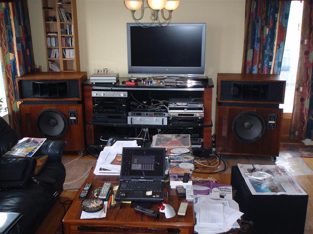

Always wanted to try, and now, they are here!
Sounds great, but far from my previous 816/515GHP & Mantaray/299 combo
Arne K
Nice Arne!
I regret not buying the model 19's when I worked at Altec - I just didn't have the extra $$$. I think they were around $500 a pair for the employees. A co-worker friend of mine did in fact buy a pair and I helped him set them up.
Any pics of your Mantaray setup Arne?
Nice Arne indeed. It is so long since I heard a pair it would be like a new experience. And yes I know they would (edit not) sound like the 825 boxes but probably still a real joy.
Previous setup: double 816 boxes (and a hidden sub)
Arne K
