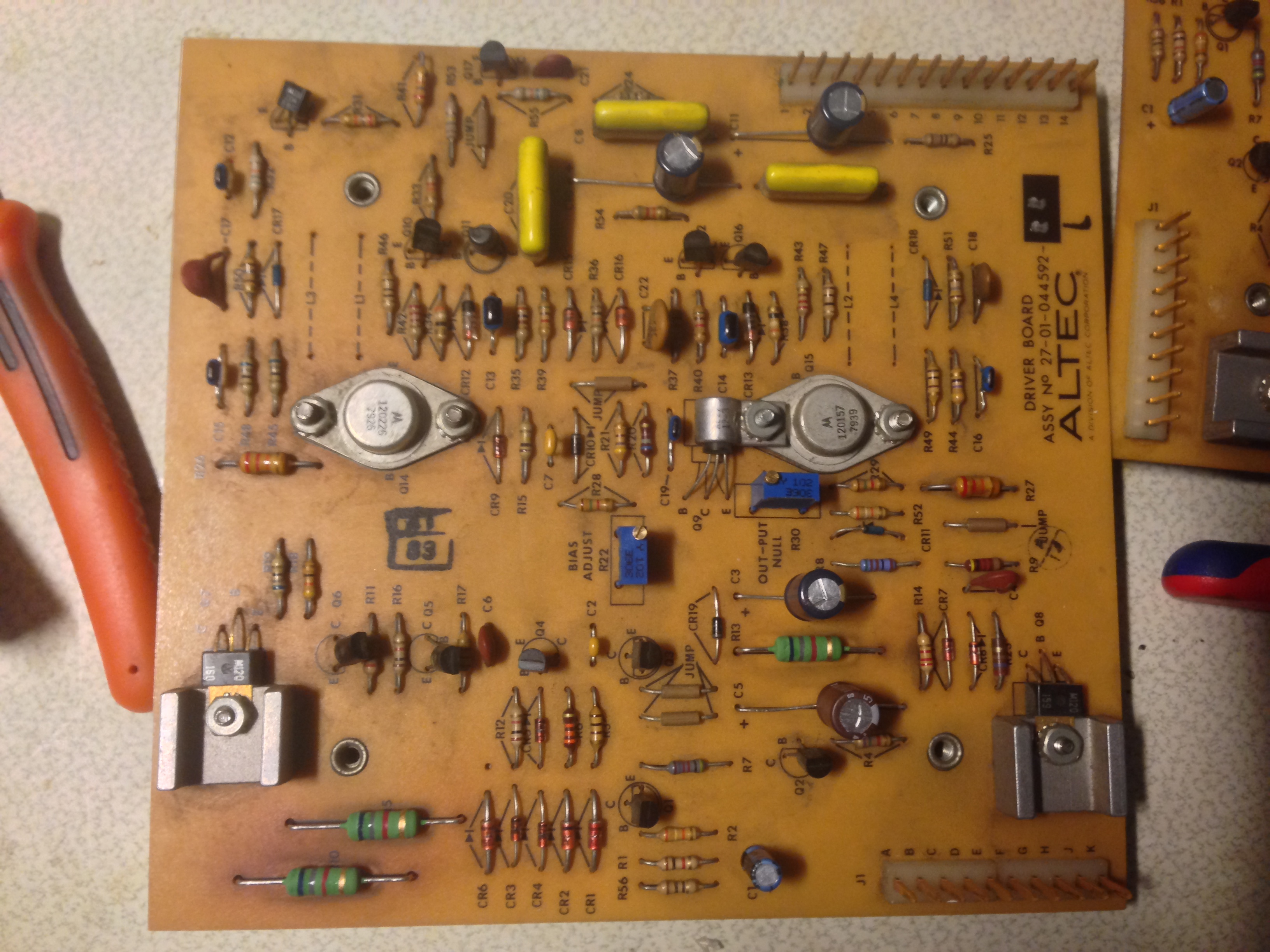

I recaped a 9440A - i replaced all electrolytic capacitors in the amp as well as some of the ceramic types on the driver board. I also installed new trim pots on the driver board.
i followed the advice of djk and increased C10 & C11 to 22uf, i also put 100nf film types parallel to C1 and C3.
the problem i have now is that the amplifier sounds very distorted, and like a hp filter is inserted in the signal path. it was possible to trim the bias on ch2 to the correct value, but on channel 1 there was no reaction when i turn the trim pot, the bias current stays at the incorrect value at about 30ma.
channel one also sounds more distorted than channel two.
do you guy's have any suggestion what the fault could be?
i would really appreciate some help - i spended a lot of money and time i this project, and now i'm really frustrated.
thanks & regards,
george

The fact the amp worked OK before means this is a problem caused by the rebuild/mods.
Although logical fault-finding is still the answer it becomes so much more difficult because we could be looking for incorrect values and/or problems with accidental shorts (solder blobs) and so on.
i don't think that the problems are caused by incorrect values. when i recap something i unsolder the old component and solder in the new component - always one by one. i think this is the best way to exclude faults. i double check every print before mounting.
it wasn't possible to find the exact same value for all caps, but the deviation is minimal. for instance 15 uF instead of 16uF regarding the NP Caps on the controller board. or 4.7uF instead 5uF (input coupling cap).

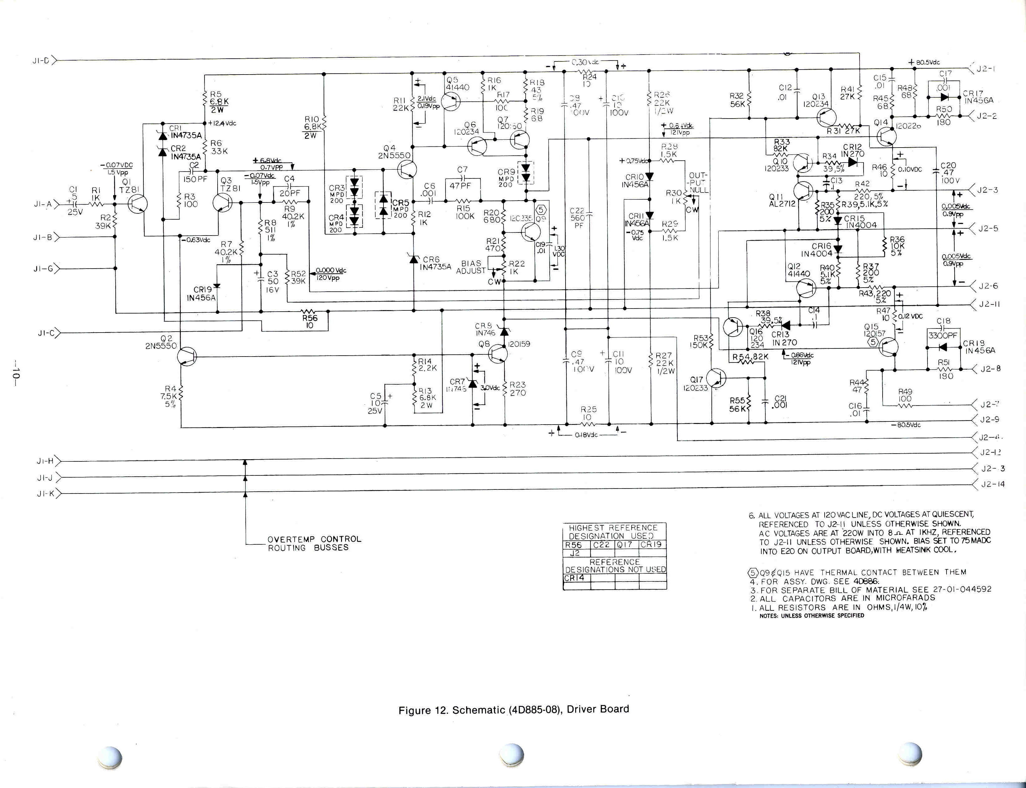

thanks for posting the output board schematics djk - but i don't think that the fault is there - i didn't touched this board.
anyway: i'll change the driver boards against original ones today to see if the fault is on this print.
regards,
george
i found the problem. it was my mistake: i used a wrong value for C2 on the driver board. this caused the distortion.
but the another interesting thing was that also the 100nf film type in parallel to the input coupling cap caused distortion. i found it out during the recap of the 2nd amp. i tested the driver board after every new component i soldered in.
very strange failure, because this mod seems to work for the other guys on this board which recapped this amp.

Searched for stb 567 and it seems to be a zener-type with 1,6 Vf, 400mW.
Should'nt be to hard to find I guess.
About the bulbs - what type did you put in there ?
If you look in the schematic ther's a bunch of Components in the light Circuit.

The test-solution may be two diodes in series with a suitable resistor. Ex: 2 pc with 0,8 Vf, or 1 pc 1 Vf and 1 pc 0,6 Vf.
Pull up the voltage to the specified 10mA and measure voltage drop.
