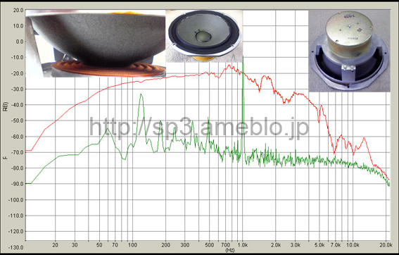

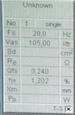

OK, got my memory refreshed and the 406 is a 10" variant of the 12" 414B, i.e. has a 414 motor with Y = no pot, C = pot and a [NLA] special two stage curvilinear diaphragm; factor in that it's designed to drive a heavy phase inverter [AKA passive radiator] in the Bolero it seems reasonable that Fs, Qts will be similar and once again 'lucking up' in a quick Google image search found this to be true.
Response and basic T/S measurements of a 406-Y:
GM

Thank you very much for this information.
Fs = 28
Qts = .24
Vas = 105
(Is the Vas in litres or inches?)

Well, T/S specs says too low a Qts [< 0.312] for optimal venting, hence the PR, unless driven with a high output impedance to raise it [Qts'], so ideally would be in a large compression horn.
OB will work of course, though needs a helper woofer to fill in below its upper mass corner [fhm].
fhm = 2*Fs/Qts'
Qts' = Qts + any added series resistance: http://www.mh-audio.nl/newqts.asp
What I do, recommend for these type specs is a mass loaded [vented] TL = MLTL where net volume [Vb] = Vas, tuning [Fb] = Fs, which uses a TL to mass load the vent, improving the mid-bass some and allowing extension down to Fs, a real plus if driven with a high output impedance, so......
What are you going to use up high and assuming these will be used in a HIFI app, your average seated hear height or whatever height you want the HF at and I'll come up with a cab design.
