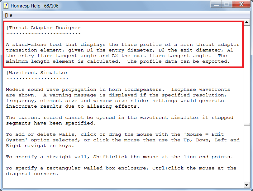

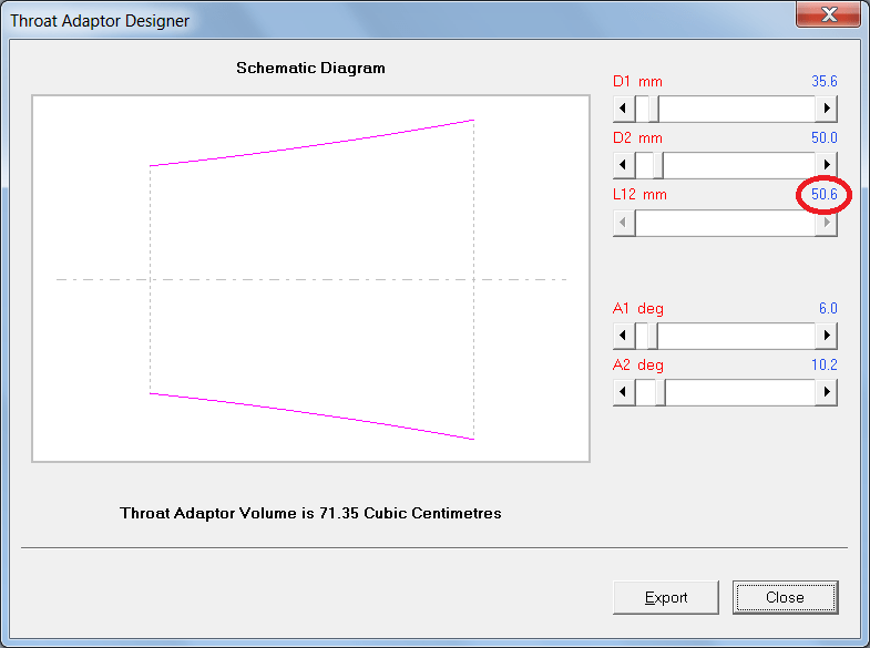

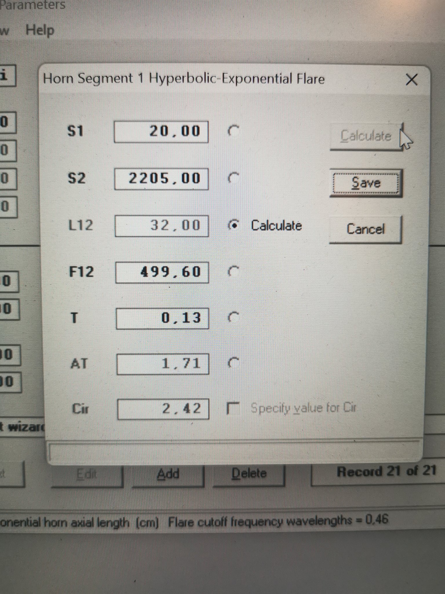

Just to clarify, is this correct;?
Yes.
The flare tangent angle (Fta) at the beginning of the adaptor curve is 6 degrees, and the Fta at the end is 10.2 degrees.
Then we have assumed that the Altec Lansing 299/8 has 6 degrees at the exit.
However, I have received the following from others;
The neck angle for the 288 is calculated at 3.6 degrees. From the center out to the side. 7.2 degrees across. Not sure if the 299 has the same angle, but it probably does.
Interesting. I never measured my 288s or 290s. Not sure I ever had 299s.

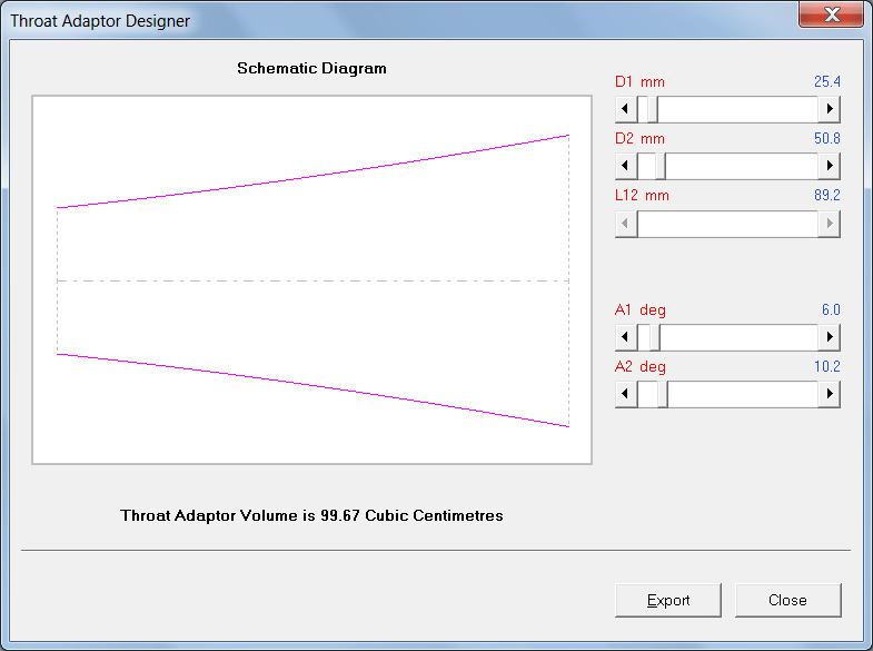

Just out of curiosity, here is a comparison of 3 throat adapters with the only change being the input angle. 6, 6.6 and 7.2 degrees. The 6 degree is the longest. The all have the same exit angle and entrance and exit diameters.
It would be interesting to check the angle in the Jabo kh55. How is this measured physically and what is used to measure it with?Interesting. I never measured my 288s or 290s. Not sure I ever had 299s.
Just a few mm. The graphic demonstrates how little difference there is between the angles.What is the length difference between these?
