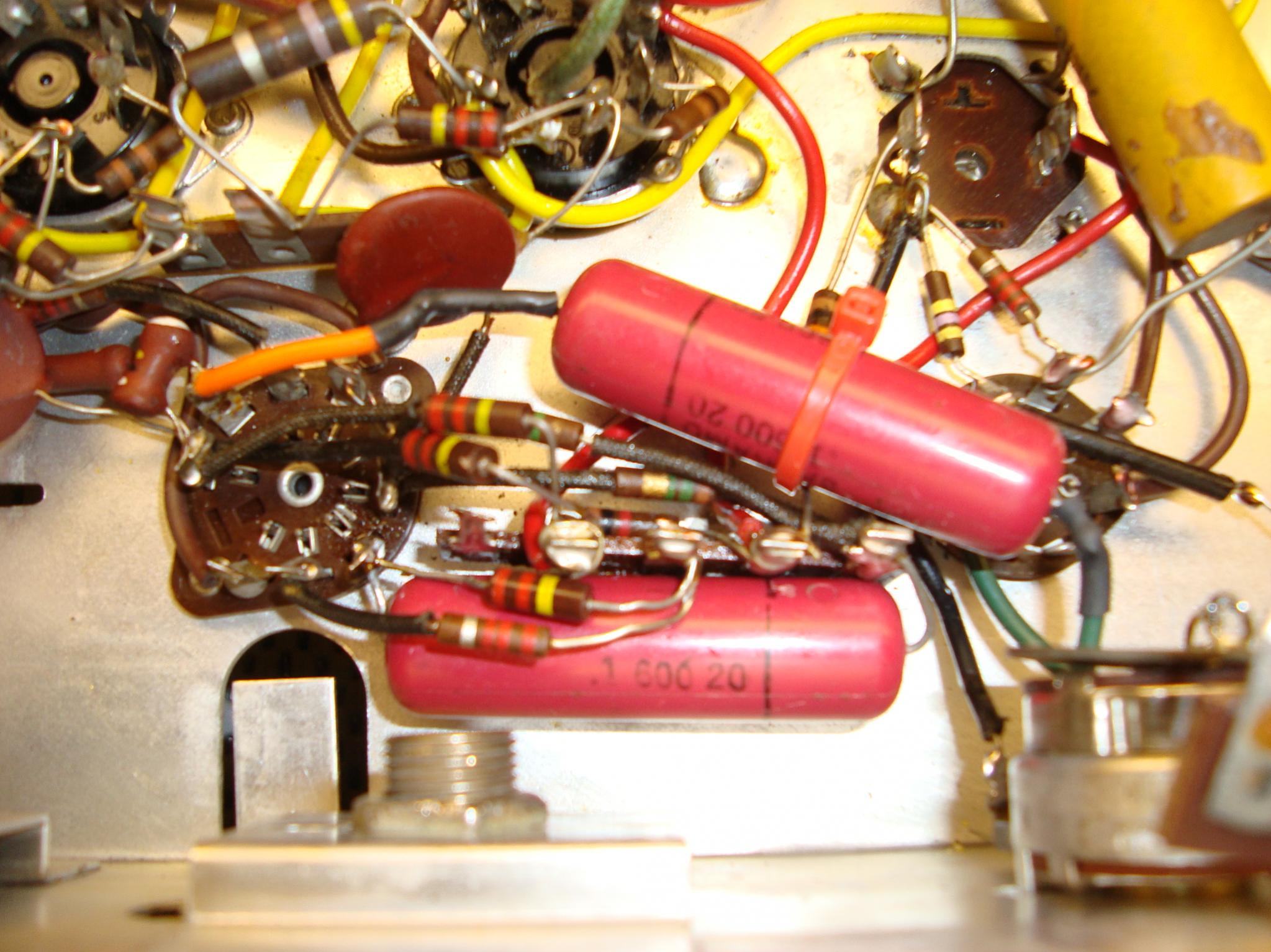

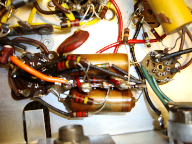

It was I good day. Below are a couple of pics of the coupling caps I swapped out of the inverter stage. I replaced the greasy "Plastiseal" .047 600V, with some Sangamo .1 600V. Again, I will be getting new caps when I'm done tinkering.
I also had the wrong 5Y3 in there, I put the original 5-pin back in.
I rolled a couple of 12AT7's that I salvaged from the Heathkit Ham. The 12AT7's sounded nice, a little more open. They really did not lack very much distortion vs the 12AX7.
