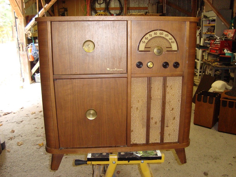

Well I think I may have finally found some parts to tackle a tube amp project.
The donor is a 50's? Rogers-Majestic console. I can't find specific info on it.
It has the following tubes.
7Q7 Pentagrid
7A7 Vacuum Pentode RF/IF-Stage
7B6 Double Diode-Triode Audio
6v6GT beam power tetrode
5Y3GT Full Wave Power Rectifier
So I'm thinking I need the last 3. I also have a 6AU6 and a 6J5 if needed.
I guess it will be more of a scavenge then a conversion, that's fine.
I know I have hours of research ahead of me, but any input/advice/links are appreciated.

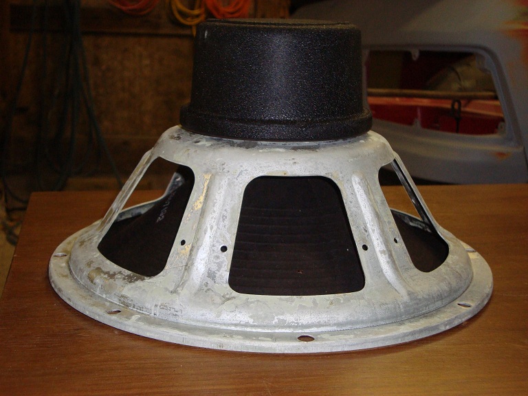

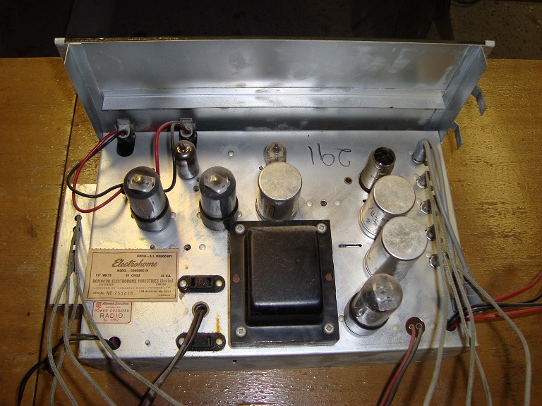

Now were talking. If you noticed in the multi way forum I posted speakers and such that I got from a flea market.
Any how check this out, it's got :
12AX7
12AT7
6AV6
2 x 6V6GT
5Y3GT Rect.- I also have one of these in the other amp.
I am think I might have something doable here.
I wonder would this thread be better in the TUBE/VALVE section???
Feel free to move it.
It also came with a nice vintage Jensen alnico speaker. I think this may sound nice with a guitar as most woofers do. I don't know if you would call it a driver or woofer? It had a basscoil in front of it for LPF, but in reality could just be a driver. I'm confused. lol

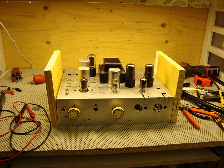

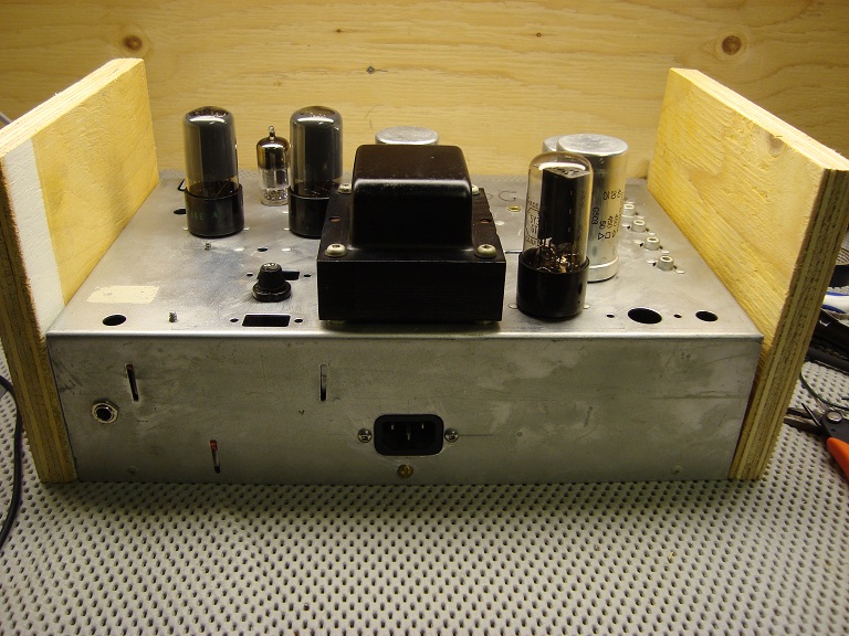

Ok making some progress I suppose.
First I wired up a 3 prong power cord, 2.5A SloBlo fuse and a regular power switch.
I also installed the speaker and input jacks.
I removed the tone controls and lights etc, trying not to disturb too much.
When I first got the amp I plugged it in, it hummed. However I should have plugged in an audio source first to see if it actually works.
I wired up some gain stages, with no luck. I plug in my guitar and it just faintly hums a bit like before. Oh boy.
The preamp is loosely based on Mesa/soldano. I also used the layout posted by stalker above as a bit of a guideline.
I was hoping to make some progress on my own with out asking for too much help, but now I'm stumped.
I understand its probably a bad cap(s) maybe a tube. Probably my wiring as well.
I was hoping to at least get some noise. Wah. I don't mind spending the money on some new caps etc, I'm just not sure on values yet. I do however have more old parts I could use.
Any tips or tests would be appreciated. In the meantime I'll keep on reading. I can post better/zoomed in pics of anything.

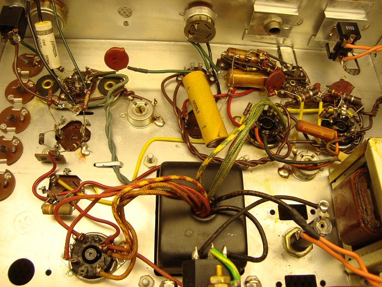

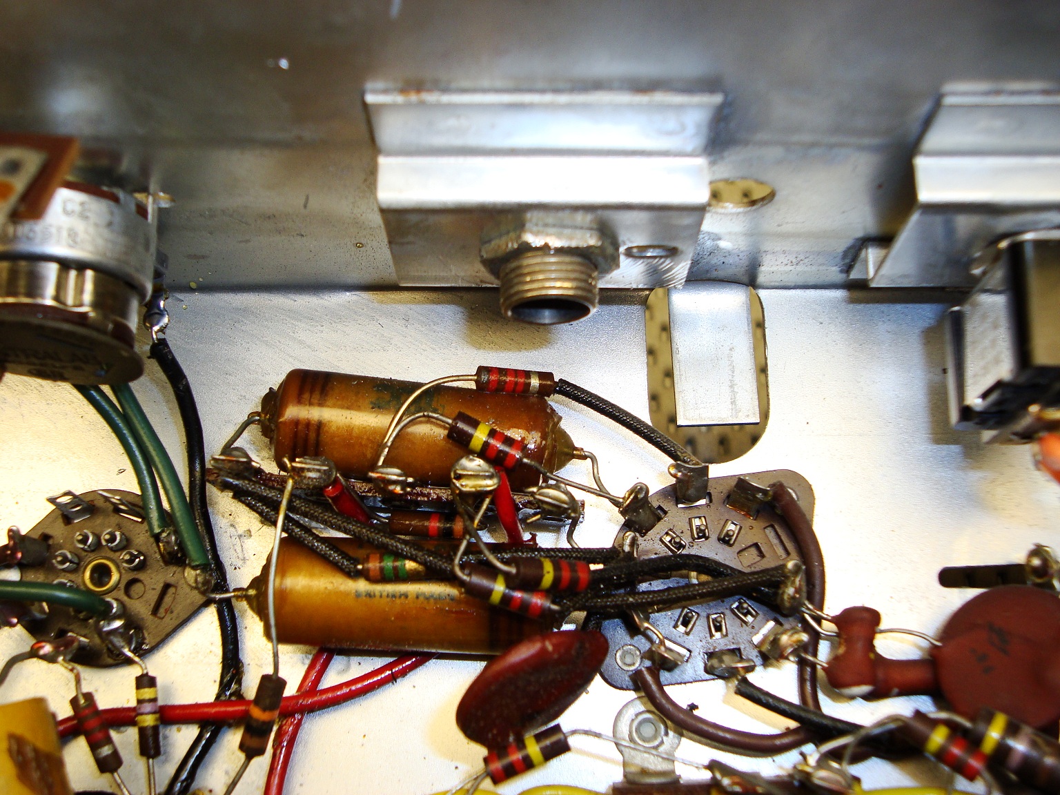

Ok so I performed the first test. When I applied the probe t the 6v6 grids I did get an audible crackle, through my 2x12 cabinet.
As soon as I sat down I noticed an area where I think the problem is. It's at a 47 cap before it enters the 12AU7. I need to get this sorted. My understanding is this tube takes the signal and distributes it to the PP tubes.
I am still going to do the preamp test. If/when I get it working, I'll ebay some caps and replace them all. I understand there will be some risk untill then.
Here is the area in question. It's the lower of the 2 yellowish bar-shaped caps. The signal comes in from the 1m pot, then goes nowhere. It's the last terminal on the right.
