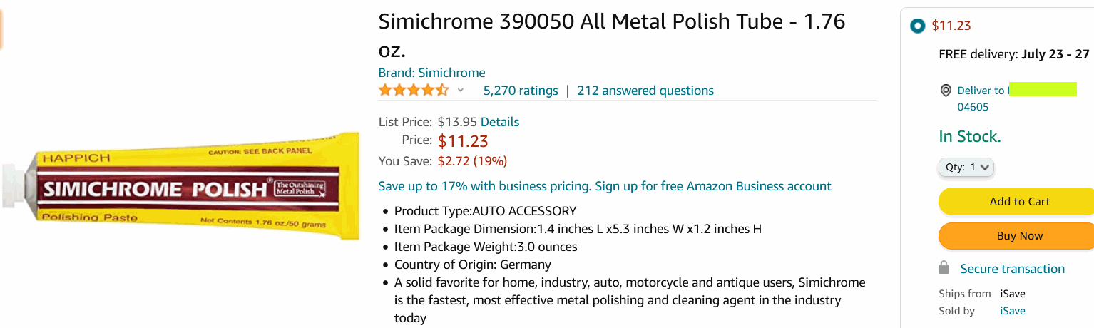

If 6 mm axles and the specific bushings are used things should work out OK. I never needed to polish 6 mm axles so are you sure you used the right bushings? Maybe things mix up with the hand/feet/thumb/finger unit system and good old metric? Please show a picture of the bushing.
Normally the materials of the axle and the bushing are adapted to each other. Some materials don't like each other. Stainless steel axles go well with plated brass bushings. Aluminium axles go well with nylon bushings. Zinc plated steel axles don't go well at all and I don't use them.
Thanks for the pointer
I saw the MSDS for Simichrome...
Finely levigated alumina (rounded grains, not sharp) in an oily base with a bit of a surfactant.
Abrasive (tooth whitening) toothpaste has the same ingredients in a water base.
During last year's lock down I got locally made silver polish, it worked, only about 80 cents for 50 ml...
Here a Chinese substitute is also available it seems, in Bombay, 400 km away.
It is $24 on Amazon here, and as usual Amazon is only the trading platform, they are not responsible if the seller sells fakes.
$32 from traders in Bombay (Mumbai now) and some others may offer from other places.
It seems Flitz is a similar product.
I use these as the final cleaner/polish after the 1 micron abrasive stage in polishing.
The substitutes need a little more effort at times, but 3 minutes in place of 2 is no big deal.
The other problem is fakes, my regular supplier died, and I am not taking a risk with fake stuff corroding my moulds.
