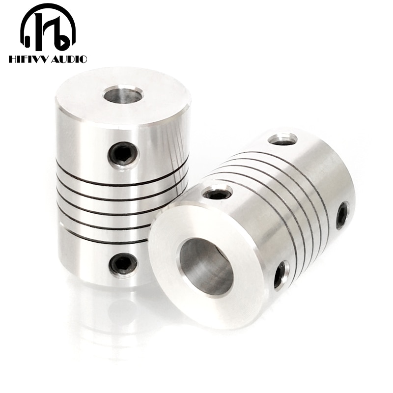

Is the extension shaft steel or aluminum?
Aluminum is better, lighter.
And there has to be some adjustable (sideways/up-down) way to center the rear bushing with the front, to eliminate any friction.
