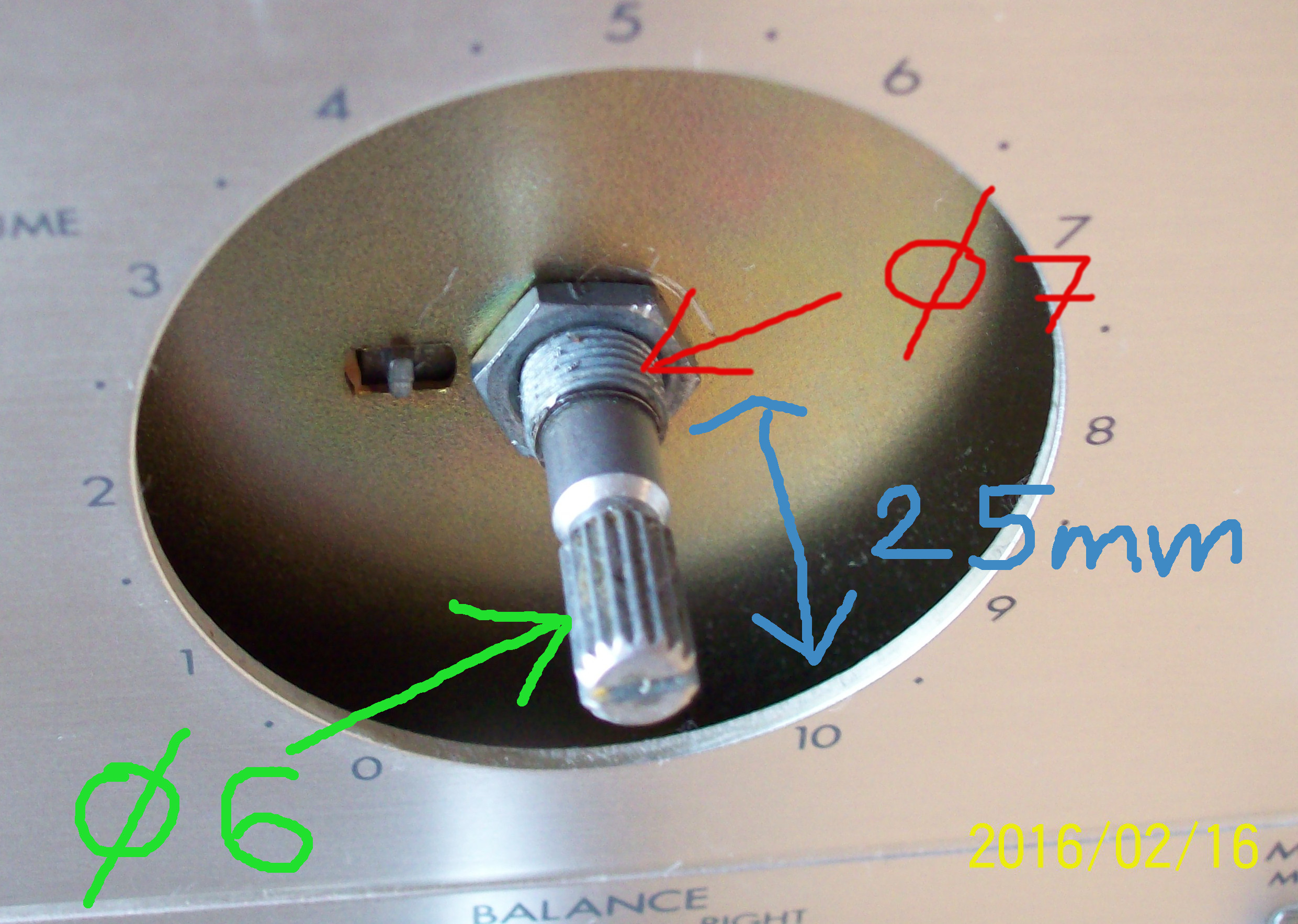

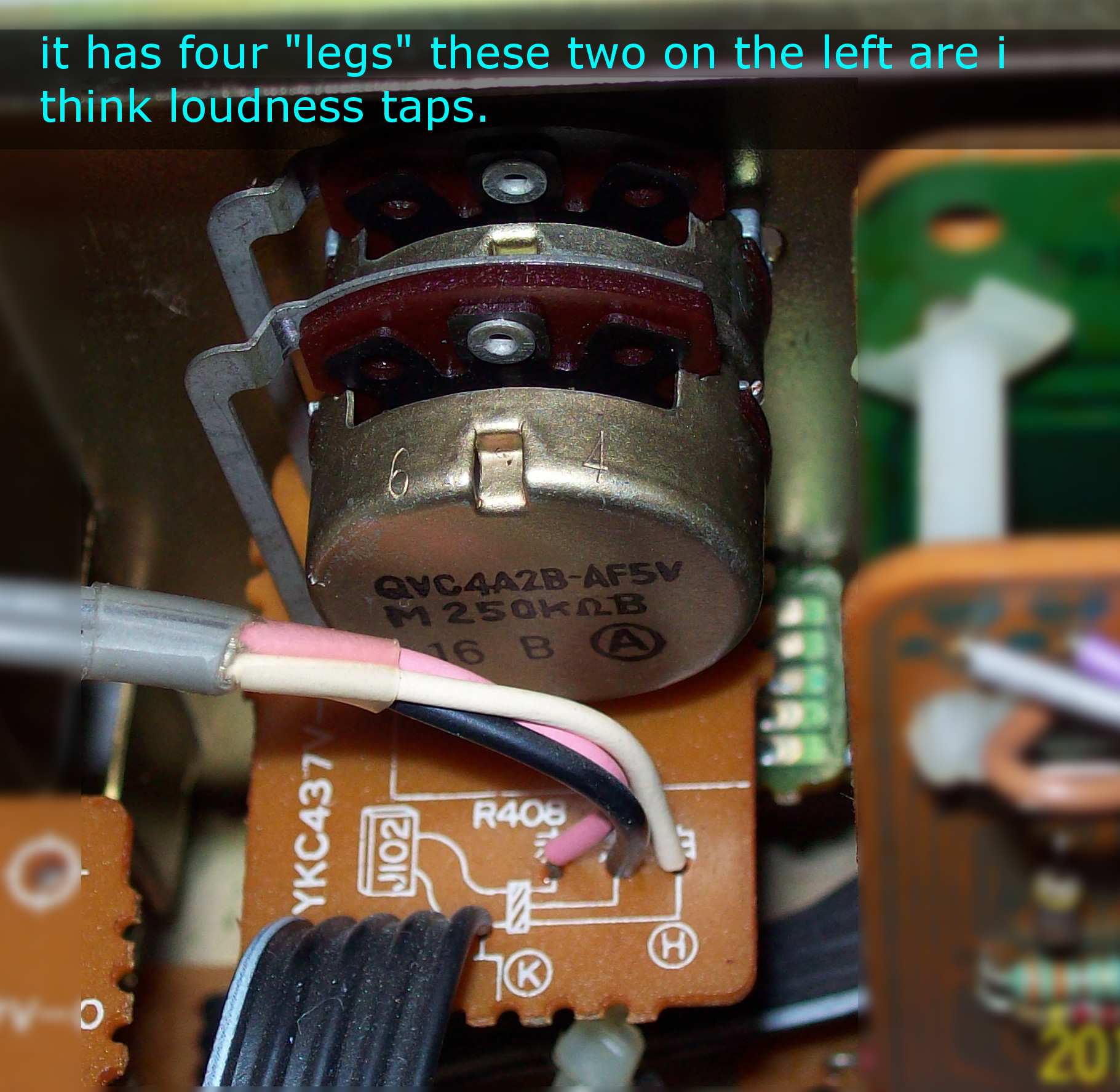

Hello,
i need replacement for volume pot in my JVC A-X2.
Pot is 250 kOhm, has four legs - i think loudness taps.
I have attached the images of it.
Also i'd need 100kOhm Alps, linear.
Whats the cost of shipping to Croatia?

And why u need replacement?If the pot is making crackling sounds when u move the viper then u need disassemble and clean the one.
At first it was cracking badly, and sound dissapearing. It was cleaned thoroughly, although without disassembling.
After that it's tracking wasn't ideal, so i took another session of good "bath" in cleaner. But...
...one of the sliders inside is damaged - accidentally moved volume knob while tip of cleaner spray was "inside" pot, so i bent the slider.
Managed to semi-fix it. Result is now it's tracking inconsistently - on some parts of scale one channel is louder, on other parts of scale opposite happens.
So instead of just tracking badly, now it's tracking audibly varies across full range 🙂
