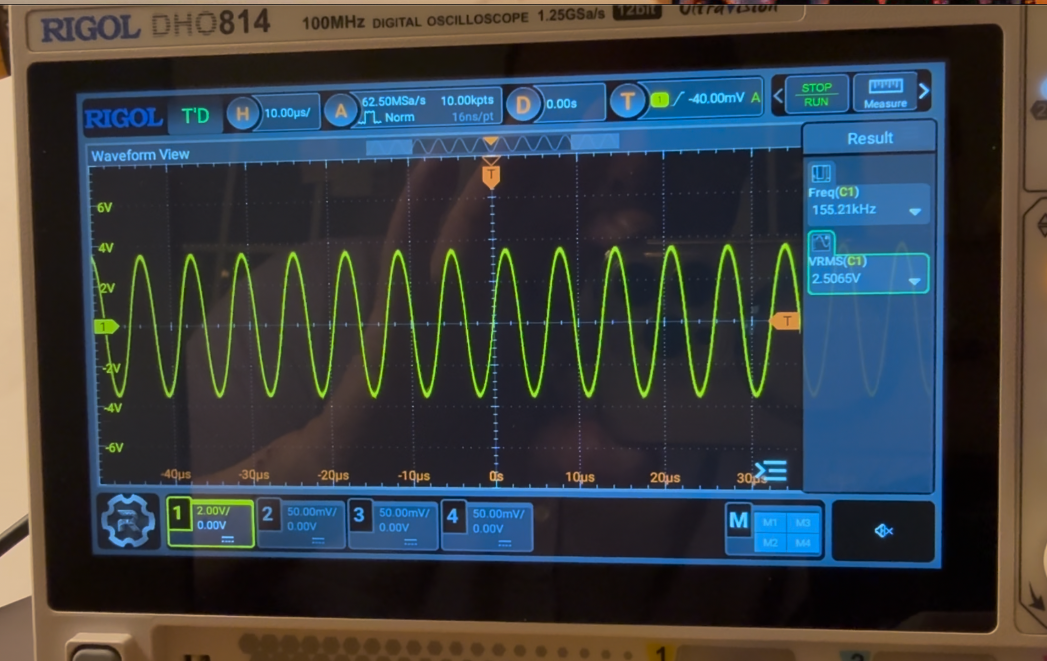

I just spent a couple hours testing again and at this point, I am scratching my bald head.🙂 I borrowed a Rigol portable 12 bit scope from a friend and looked at the waveforms coming out of the Quant Asylum analyzer while I ran the distortion and THD tests on each channel.
First I tried a simpler test by just feeding a 1kHz sine wave into each channel with only the scope connected. All 4 channels had a fairly clean sine wave output. With this 12 bit scope, I can see the switching frequency of the Alpine riding on the sine wave which is kind of cool.
Here is the part I can’t understand. When I connect the Quant Asylum analyzer and ran the distortion tests, once again 2 channels looked good and 2 didn’t with very high noise floor. I then looked at channel 4 with no signal but the QA403 still connected. I have attached a screenshot of what I measured. It is an approximately 2.5 Volt RMS sine wave at 154-155 kHz. When I disconnected the QA403, this signal disappeared and the Channel 4 output only showed a very low amplitude sine wave at the Alpine switching frequency.
I can’t see any reason why 2 channels would be showing this ~2.5 volt RMS signal with QA403 connected but no signal coming out of it and 2 channels do not show this signal that is obviously the cause of the high noise floor on the channels I am calling bad. I am using shielded BNC coax cables with RCA adapter on the amplifier end.
One last thing. The 2.5 volt signal I am calling noise is with the gain set at the mid point on the Alpine. The amplitude of this signal varies with the gain setting.

The PDX already has what look very much like bypass caps and RC networks that I assume are filters on the input buffers. I have the service manual and can see this on the schematic. This 155 kHz signal is being amplified when the QA403 is connected to the input so I am thinking this carrier is coming from the QA403 or something in the environment.

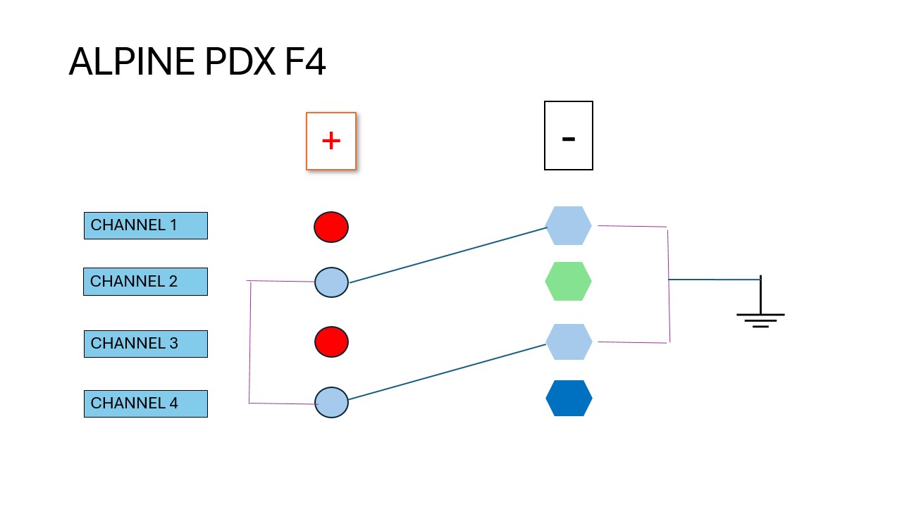

I circled back to something you said related to how the speaker level outputs are bridged. I am still trying to figure out how this noise is coupling in on channels 2 and 4 and not on channels 1 and 3. I used an ohm meter to figure out what is connected to what.
Channel 1 negative, Channel 2 positive, Channel 3 negative, and Channel 4 positive are all at same potential and connected to the 12 VDC input to the power supply. Still not clear to me why the noise is coupling in but I am still thinking on this.

Thinking out loud here. Only channels 2 and 4 appear to amplify the noise signal along with the sine wave test signal. Those channels positive connections are tied to ground. If the noise is coupling on the amplifier ground, could this be why those 2 channels exhibit this behavior?

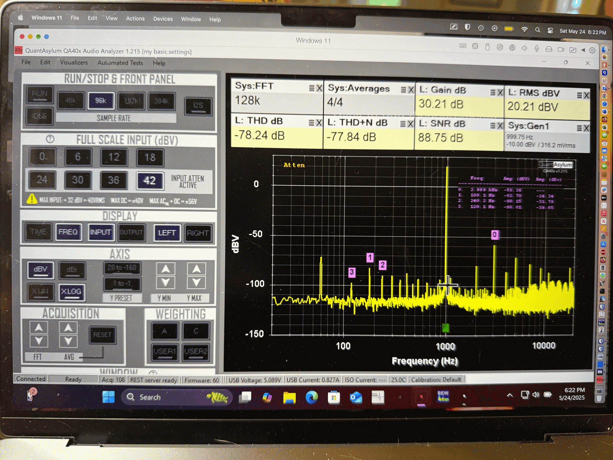

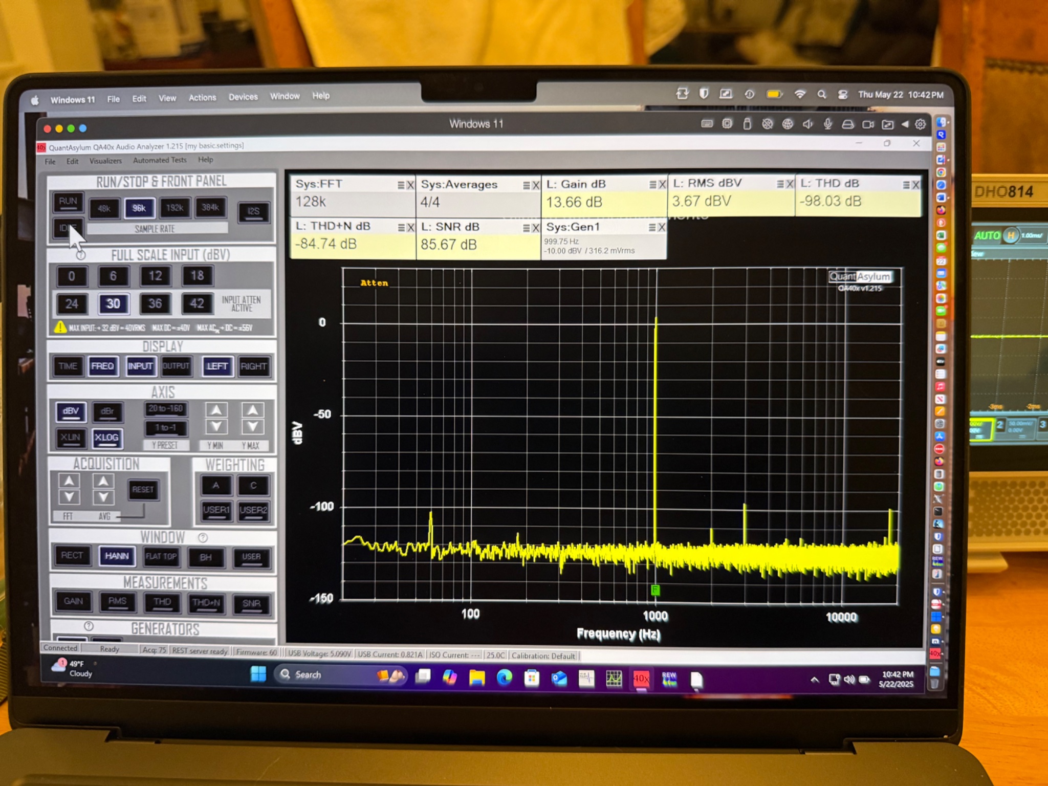

I did just try something that had an interesting result. The QA403 has ability to test single ended or differential output and input. I ran the distortion test with differential I/O and the high frequency noise is gone. I also tested each channel with a 1 kHz sine wave and the scope traces looked good for each channel.
The test was not all good. There is much more prominent AC powerline noise in the FFT running in differential mode. Picture is attached. First one is with differential i/O. All 4 channels looked like this with differential test.. Second is single ended on channel 1 from earlier test for comparison.
Bottom line is it appears the amps are OK. Now I have to figure out the 60 Hz but I believe that is due to how sensitive the QA403 is and my jury rigged test cables.

I measured the other PDX F4 and got the same results. With single ended connection between channels 2 and 4 speaker outputs and QA403, I had tons of noise and distortion, With differential connection, the noise is gone and distortion measurements match channels 1 and 3. 1 and 3 measure good even with single ended connection. This has to be related to the fact that Channels 2 and 4 positive speaker output is at the amplifier ground potential.
From what I remember about electrical design, an RC filter shunts high frequency noise to ground because the RC network is lower resistance to the higher frequencies. Channels 1 and 3 are shunting the high frequency noise to amplifier ground. Channels 2 and 4 are not - at least in my measurement setup. Perry, i think this goes back to something you suggested early on - try reversing the + and - lines going to the analyzer for channels 2 and 4. I thought simply flipping the PDX speaker connectors would do that but it doesn’t. No matter how you plug them in, The positive and negative speaker connections stay the same. It works the same way as a circular power plug where + is almost always the inside center connection.
The noise signals are way above 100 KHz and above human hearing but they do distort the output measurement and — in the case of channels 2 and 4, they come back in through their preamp inputs with my initial single ended measurement setup.
