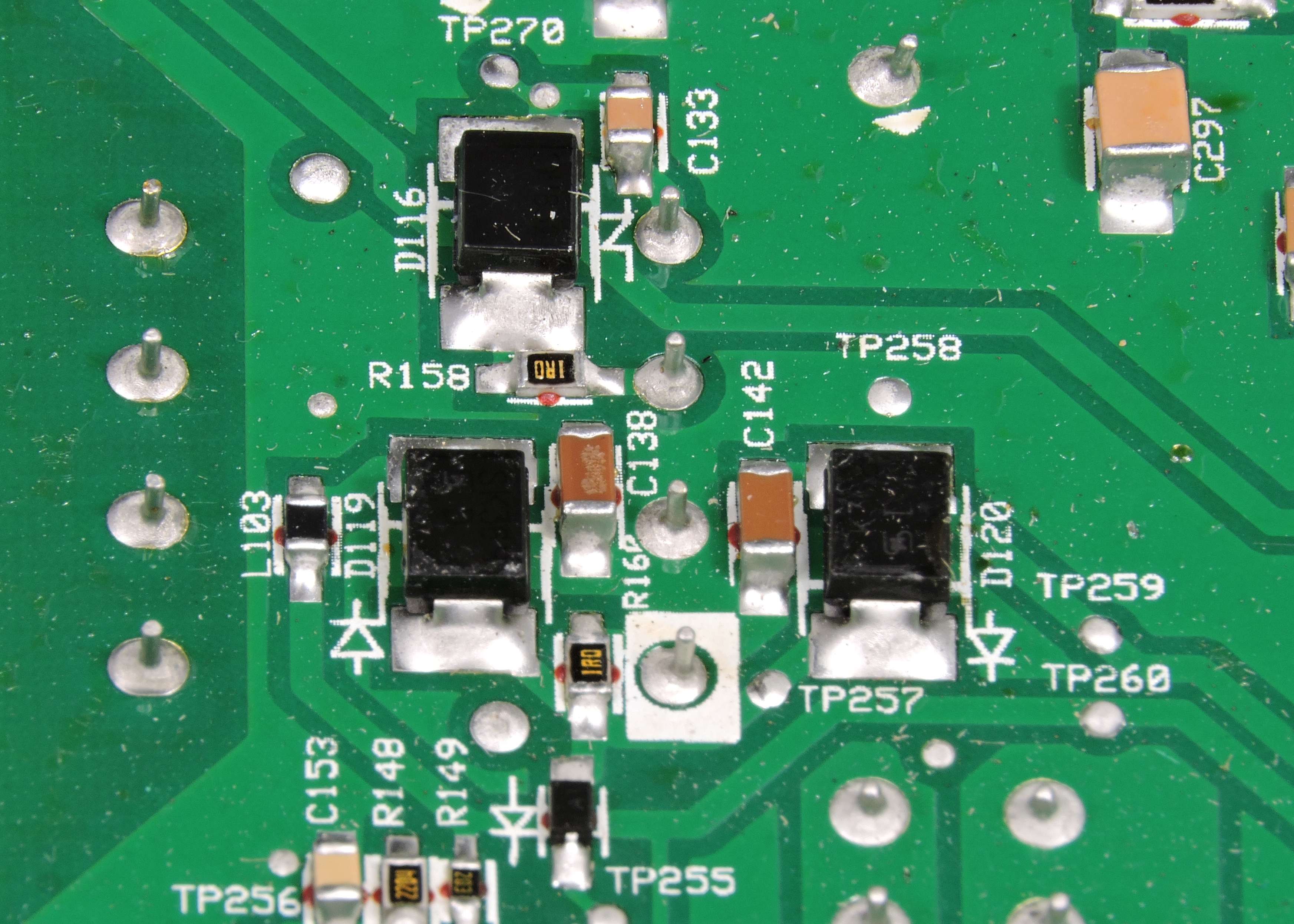

ok, the side which had blown output fets which has
ic305 reads:
pin 5,6,8, complete short between them.
pin 7 has 3M ohms between it and pins 5,6,8
ic301 reads: ( this side didn't have blown fets)
between pins 5 & 6 =2k ohm
5 & 7 = 480k ohm
5 & 8 = 1 ohm
We calling it ? it that ic? 🙂
Wow, that was a challenge, they are also glued underneath.
This is the readings:
*Chip (ic305) OUT of the board reads:
between pin 5 and 6 = 3.5k ohm
between pin 5 and 7 = OL
between pin 5 and 8 = 1.7k ohm
ic305- pads:
between pin 5 and 6 = 0 ohms (there is a trace between them)
between pin 5 and 7 = OL (one way) 500k (the other way)
between pin 5 and 8 = 1 ohm
ic301- chip on board:
between 5 and 6 = 0 ohm (trace between them as well)
between pin 5 and 7 = 555k ohm
Pads/traces of ic305
