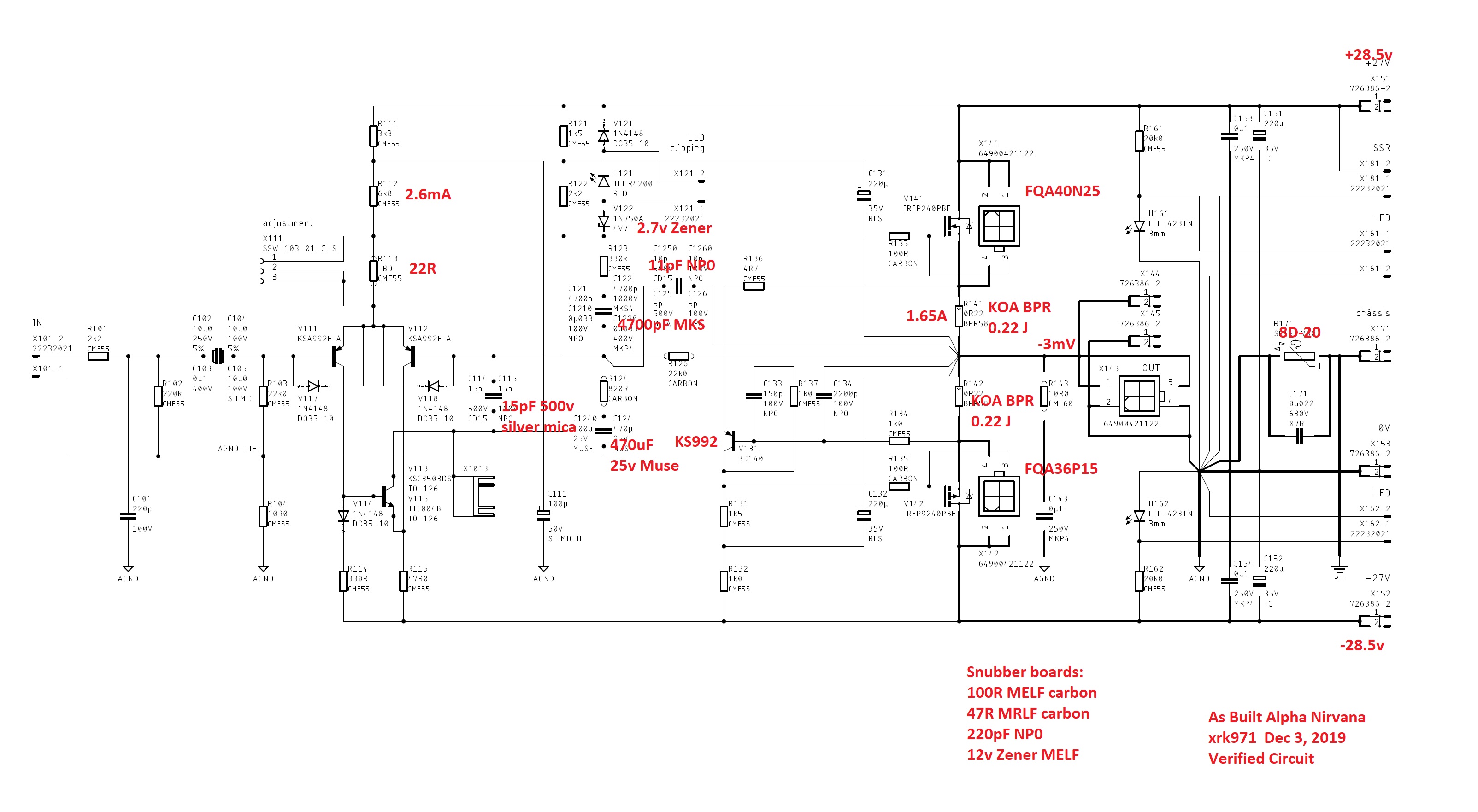

On the snubber boards, you have notes at the bottom of the print of what you used, but the print also has R133 on the gate and then the snubber has R101 which would be another 100R on the gate? We have to populate R101 or there will be no connection to the gate, so do we need both, or do we short the board one. I guess, I'm asking if all the parts on the print for the main are installed and all the parts on the snubber too.
Snubber
R101 = 100R
R102 =47R
C102 = 220pF
V101= 12v Zener
Then I want to confirm the flying lead connections. Thanks for labeling the snubber GDS, that is helpful for us new guys. The connections to the main board are a little harder to figure out. THe stuffing guide and they print have pin 1 located in different positions. That only matter with respect to talking about lead numbers as if I say pin 1 on stuffer or Pin 1 on schematic.
So I will attach a picture in and schematic in a few minutes to make sure we are on the same page.
So ignoring the stuffing guide and looking at the schematic, for N channel we have.
Pin 1 or 2 going to the source
Pin 3 going to the gate
Pin 4 going to the drain
Is that correct?
Snubber
R101 = 100R
R102 =47R
C102 = 220pF
V101= 12v Zener
Is that correct?
Pin 4 goes to Source according to the schematic. Source is the pin connected to the arrow on the MOSFET pin diagram. The one without the arrow is the Drain. In general, on an N channel (arrow points into the flat) the Drain goes to +ve rail, on a P channel (arrow points away from the flat) the pin connected to the arrow is the Drain. Despite the schematic, I always check the wiring and traces in the PCB to make sure it’s correct.

Thanks X that explains it perfectly, my problem was looking at the source as VE. I still have a lot of work to do understanding schematics and parts. I'll get there, I'm a persistent mofo... in the mean time thanks to all that help. I would rather ask than smoke something. Hell, I still may smoke something, but it isn't going to be because I didn't ask the question when in doubt.

Okay then if we are looking at the P channel on the schematic. The arrow that connects to pin 4 and is the drain. It looks like Pin 3 goes back and connects to the gate, so that means the source goes to the - rail?
Pins on P channel still the same GDS. Negative rail goes to Drain pins 1 and 2 on connector. Note that connector pins are consistent between N and P channel, just like the GDS pins.
I think my confusion was reading this: "on a P channel (arrow points away from the flat) the pin connected to the arrow is the Drain"
Sorry, my mistake. The pin connected to the arrow is always the Source. On P channel, arrow points towards pin and away from flat line.
