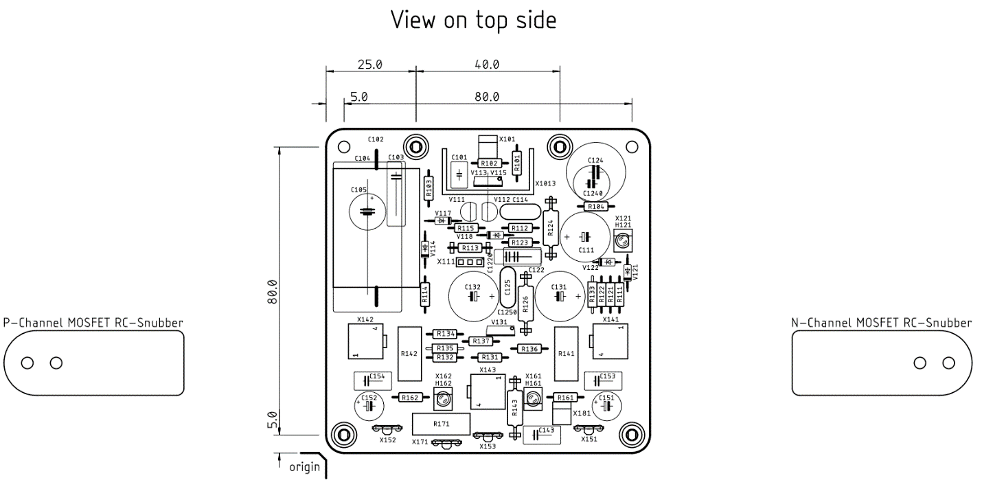

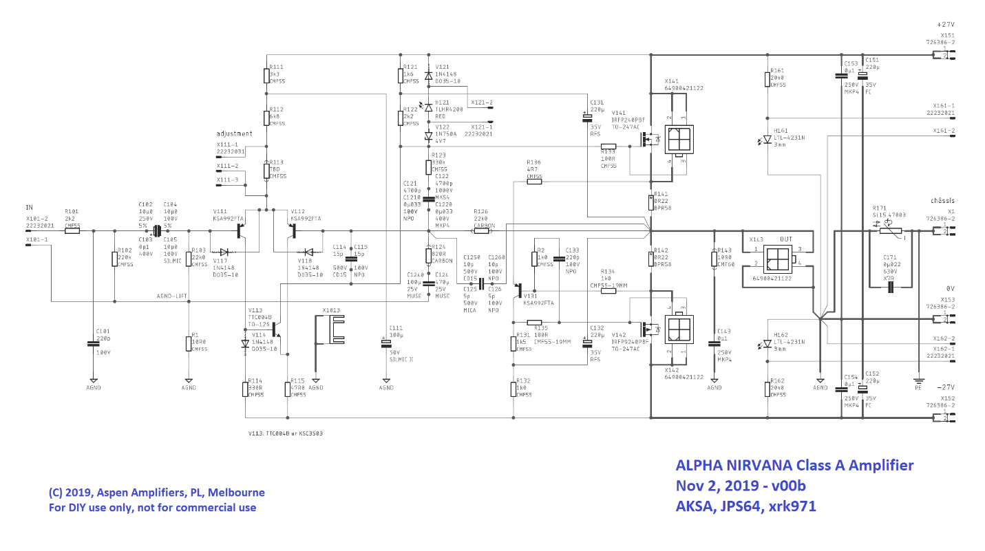

Hi X, AKSA, other builders,
I was racking my brain looking at the stuffing guide and the AN schematic, and pics of the transistor bolted to the heat sink. I think I finally figured out that I was not looking at the KSC3503, but probably a SA992 or other. The pics showed the small taper of the transistor against the heatsink, which was backwards to how I think the KSC3503 should be mounted.
From the stuffing guide attached and the schematic attached, I believe that I am correct in my reading that the emitter of the KSC3503 is the little dot under the V115 label, which corresponds to the emitter on the schematic which travels through the SA992 and ends up at R115.

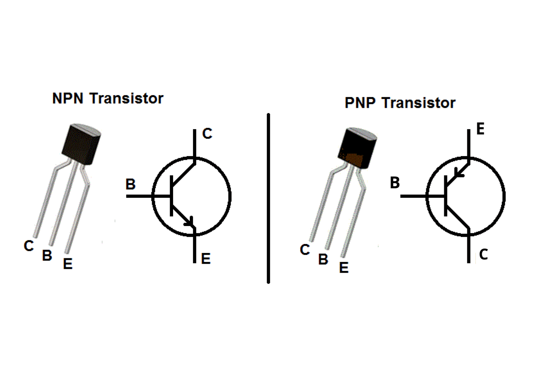

Using the most current schematic is important for this build, without it, things can get confusing. V113 here is the KSC3503. V115 is the functional equivalent (TTC004B) so you can use that if KSC3503’s are unavailable. V112 is a KSA992.
The KSC3503 is an NPN transistor. The KSA 992 is a PNP transistor.
In schematic convention, the pointy part of the arrow on an NPN transistor is the emitter. For a PNP transistor, the other side of the arrow is the emitter (and the pointy part faces the base). As such the other pin on a PNP transistor is the collector. If you are at all confused while building, always use a transistor tester to verify.
Now, getting back to the Alpha Nirvana:
The emitter of the KSC3503 (V113) connects to the collector of the KSA 992 (V112) and also to one end of R115 resistor. Once you know that then you can just user your multimeter and verify.
Yes the back of the KSC3503 faces the heatsink. But you already knew that AND if you have a KSC3503 in front of you, you can immediately verify with a transistor tester and therefore verify which is front and which is back (See attachments below).
If you do it this way, then you don’t need a ‘stuffing guide’ because you are literally verifying things against the schematic. Stuffing guides are fine, but like all things human they are also subject to errors.

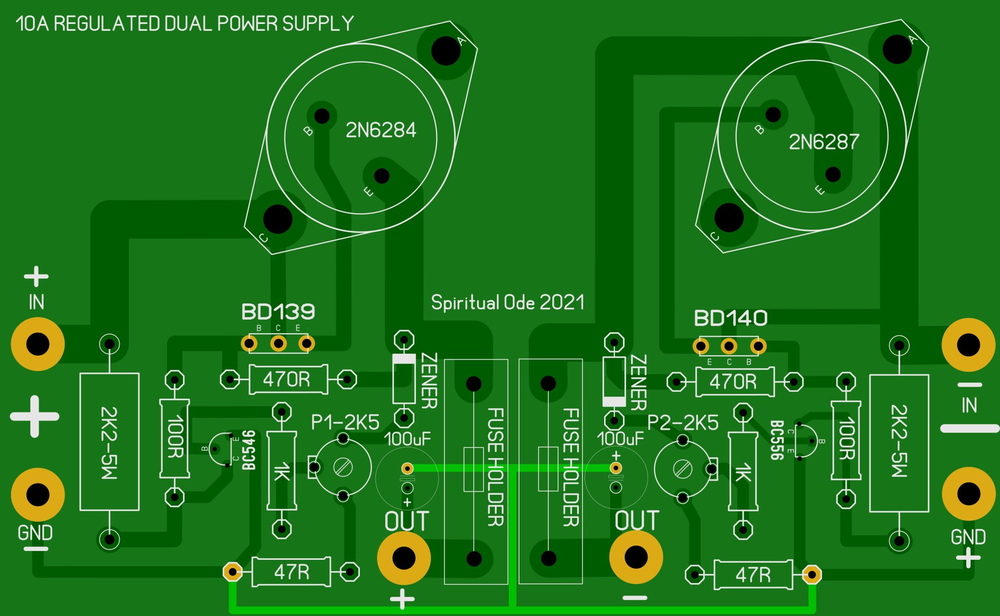

I have used that pcbs in 2 class A amp projects and my Fluke indicates 0.02mV at 28VDC. I have used the same pcbs with a stabilization circuit using 2N6284 & 2N6287 for positive and negative rail( see image) with the same result. I always build a dual mono configuration with 1 trafo per channel.Sure. The SLB provides about 1mV ripple under load. The ripple on a standard CRC is closer to 100mV. It will work but the background noise with SLB will be more quiet.
Hi Morten,
The diodes and zener are correctly installed on the schematic.
They fire ONLY when the voltage at the gate of the upper mosfet exceeds the positive rail, that is (4.7V + 1.6V + 0.65) = 5.95V above the rail.
At this point, the amplifier is clipping since the source of the nmos is almost at the rail itself, the nmos is in saturation (Vds is minimized) and the red led fires demonstrating this event. This flash of red light lasts only an instant, but the eye has latency and will hold this image for 1/24 second. If the waveform is higher than 24Hz, the red led will give an impression of steady state intensity.
You can eschew this diode/zener array if you wish since it only lights up if the amp is clipping on the positive half cycle.
It is a nicety on the design, nothing more.
