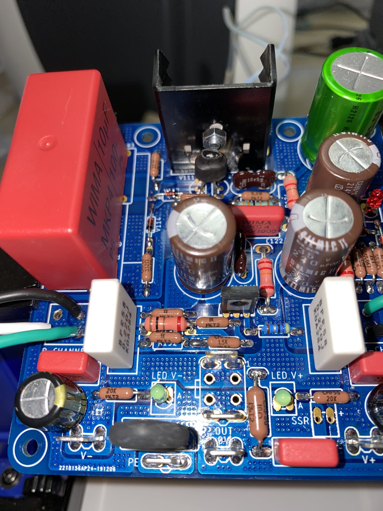

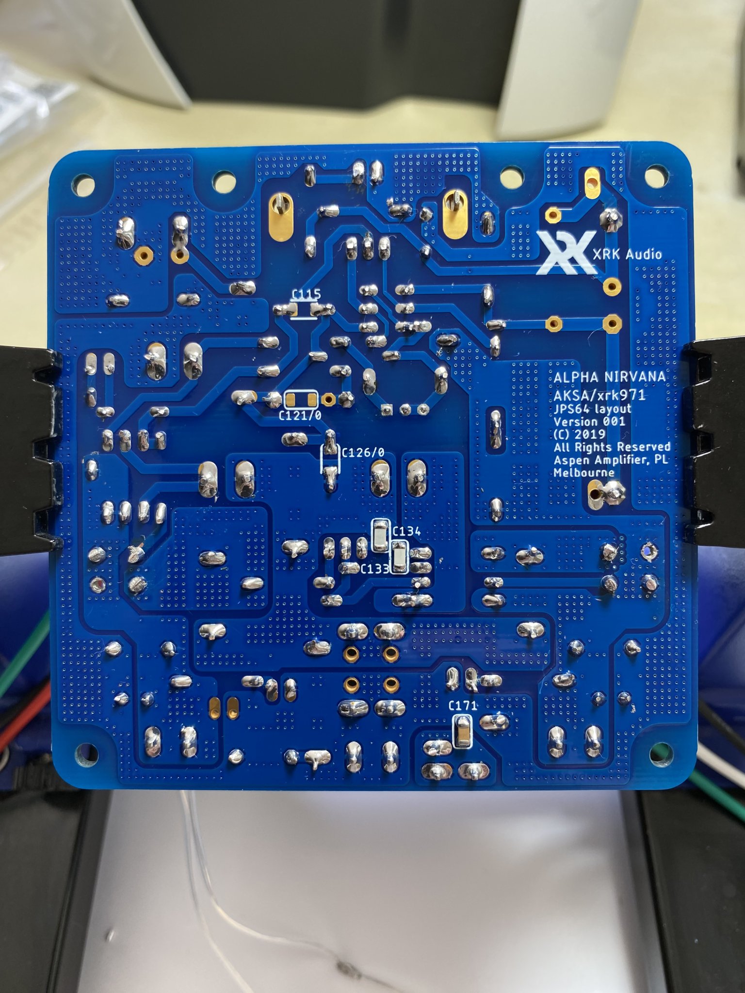

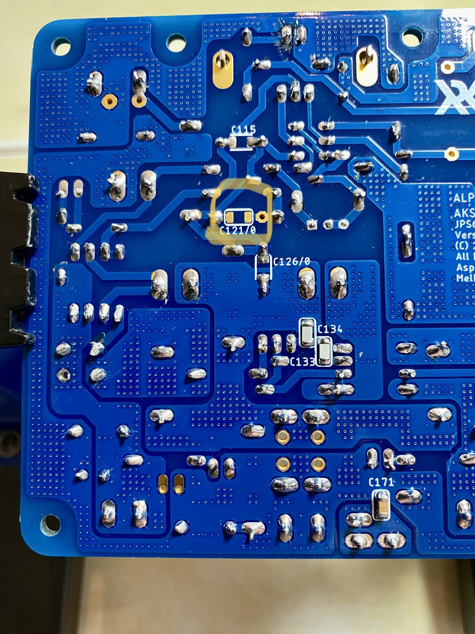

Hi guys,
Does C121/0 on back of board need to be populated even though there is a through hole in that C122 location but they are of different values and that location on back is circled instead of open end markings
That leads me to believe it is not optional but should be used.
Any thoughts?
Any thoughts?

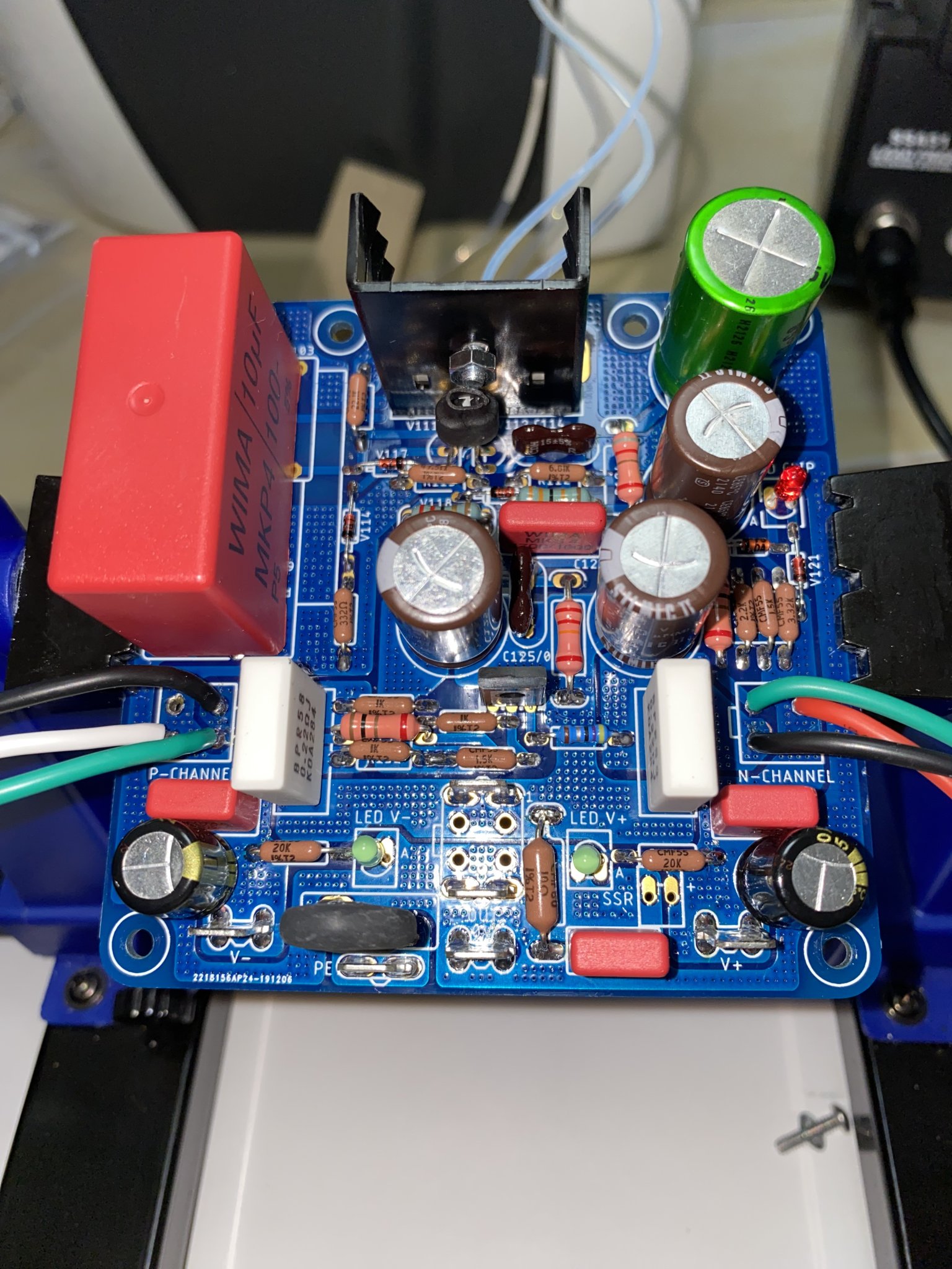

I am trying to dial this thing in vocals are a bit to bright and fatiguing for my taste.
Nice punch but to much upper end.
Maybe it just needs a good long burn in.
Tried 3 different input caps, I wonder if I used the npo cog in place of the 2 silver micas
And maybe a Silmic 470uf in place of the Muse would help?
Scott

Hi Scott,
The Alpha Nirvana, if buil properly, is anything but fatiguing. So if it sounds harsh, there may be an issue with it perhaps oscillating at ultrasonic frequencies. Can you show us a close up photo of the top side and bottom side?
The critical cap here is C125/126 or C1250/C1260. Nominally 10pF but maybe try 15pF silver mica or NP0. If you are using 5pF that may be too low.
Other important one is C114/115 and needs to be 15pF NP0 or silver mica.
These are the keys to the sound being just right with dynamics and liveliness but not fatiguing.
