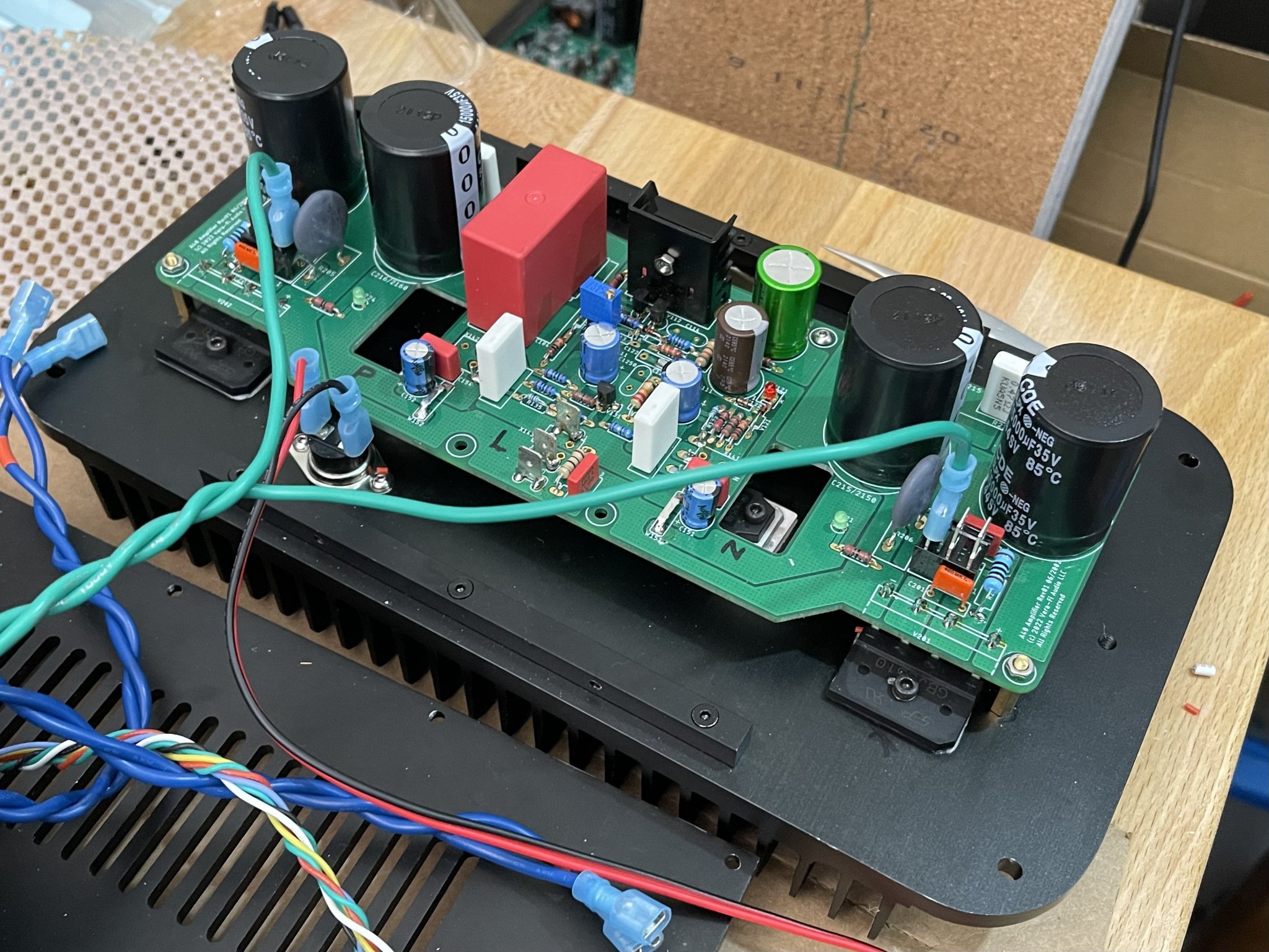

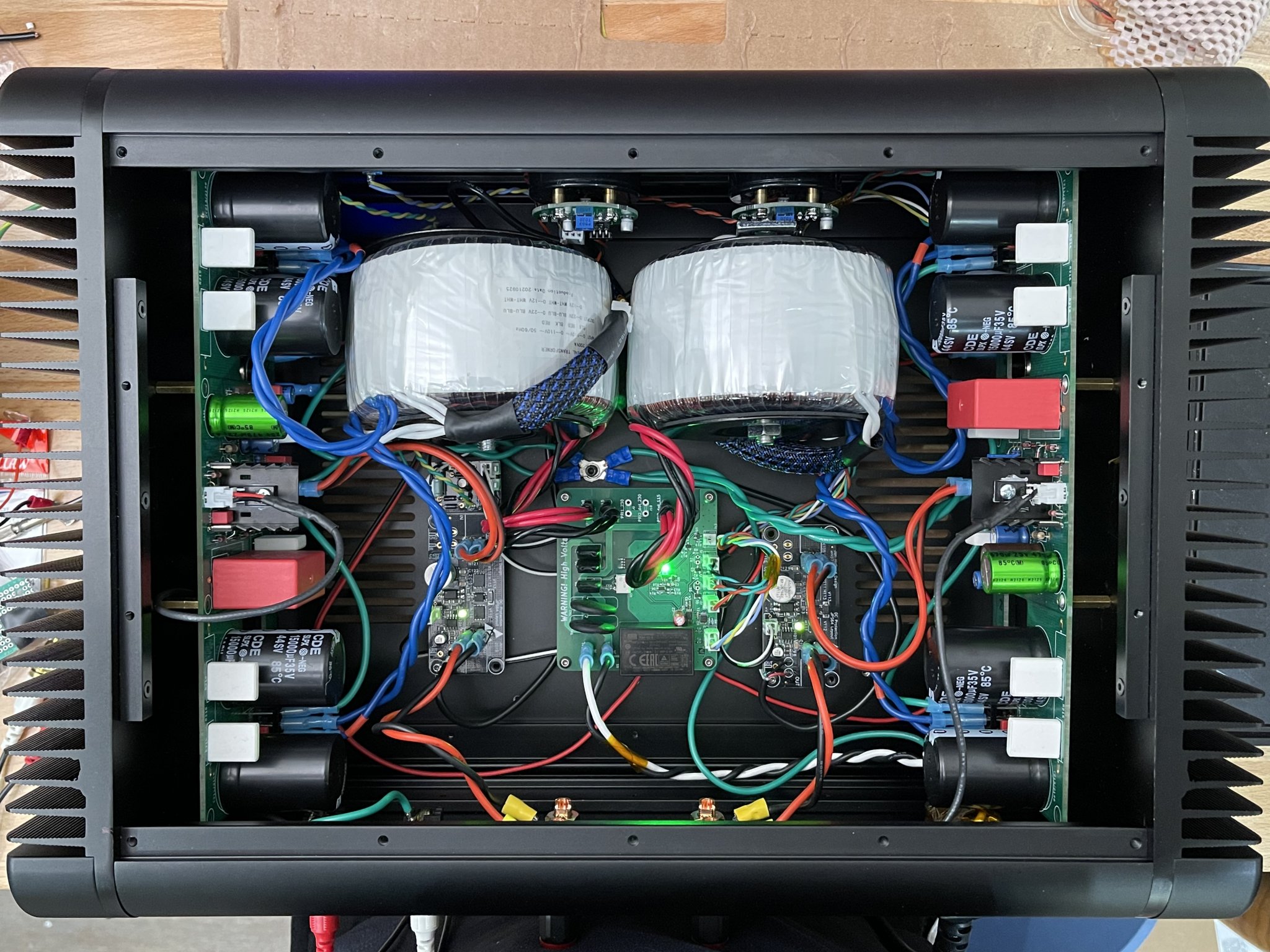

Here are some video clips of the Alpha Nirvana. Anand has a very good description of the sonic qualities. It’s a Class A amp that has the bass authority of a Class AB amp while sounding like a SE Class A amp overall.
I put the CRC PSU directly on the amp here to free up room on the chassis floor which has dual trafos and a soft start and speaker protection SSRs.

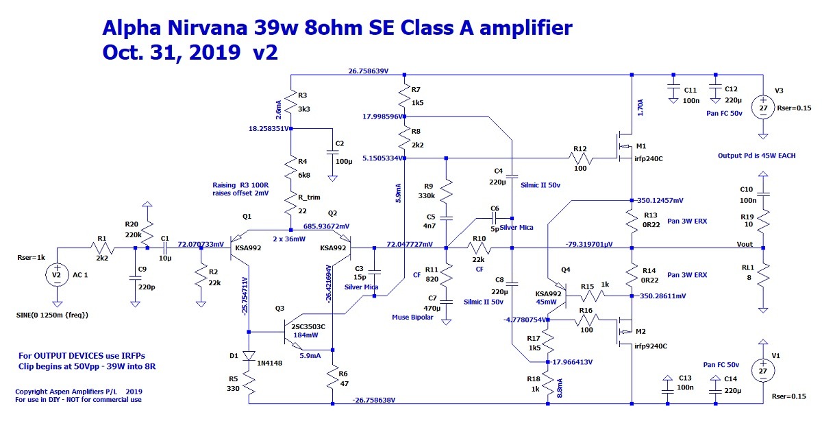

Question for Hugh @AKSA I really like my A39, thank you for sharing this with the community. But...like any audio addict I need my next fix, I need to tinker 😊 I know I could throw some cash at it with some naked foil resistors and pricey German capacitors, but I can't help wondering if there are gains to be had with something like CCS's for the VAS transistor or input LTP? My EE skills are lousy but I'm willing to have a go. What do you think?
Hi Simon,
What you propose will change the nature and sound quality of the amplifier and essentially make it a different amplifier. This is DIY and you are free to play with the circuit as you wish. I would suggest getting in the LTSpice simulation and testing your schemes for adding another transistor for a CCS that can maintain circa 2.6mA on the top of the Long Neck Pair. A CCS on the VAS stage is more difficult. In all cases, extensive sets of simulations will be needed to make sure it works in all ranges.

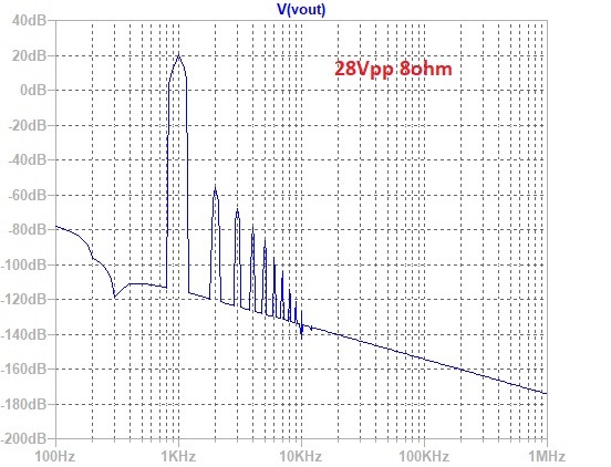

I know that Hugh’s designs are tailored to have a dominant second harmonic, lower third harmonic component and monotonically descending higher orders. Also, the FFT profile should be similar at low and mid and high power. There are also a lot of special tricks in the feedback network to allow a high damping factor at low frequencies for the slamming bass. It’s fun to play on LTSpice doodling but takes a lot of insight and trial and error. You could start another thread. If you can improve on this FFT then maybe you have something. Here is current amp simulation at 28vpp into 8ohms (about 12w power and quite a loud volume for most speakers):
Usually, adding more parts and CCS will lower THD so that the smaller peaks will be lower relative to the main peak. That sound might be to your liking and there are other amps that do this and also maintain a similar profile.

X has precisely stated my thoughts accurately and I can stress that replacing resistors with CCS will change the harmonic profile
Accordingly if you change the bootstraps you will alter the sound quality, however I can cannot say it might worsen the SQ; you might prefer it!
