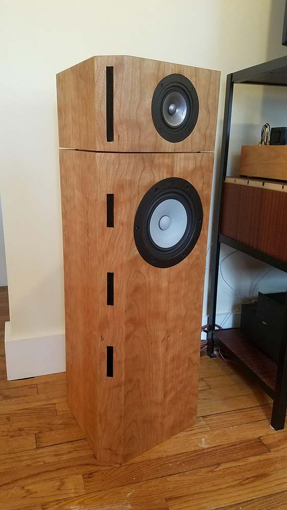

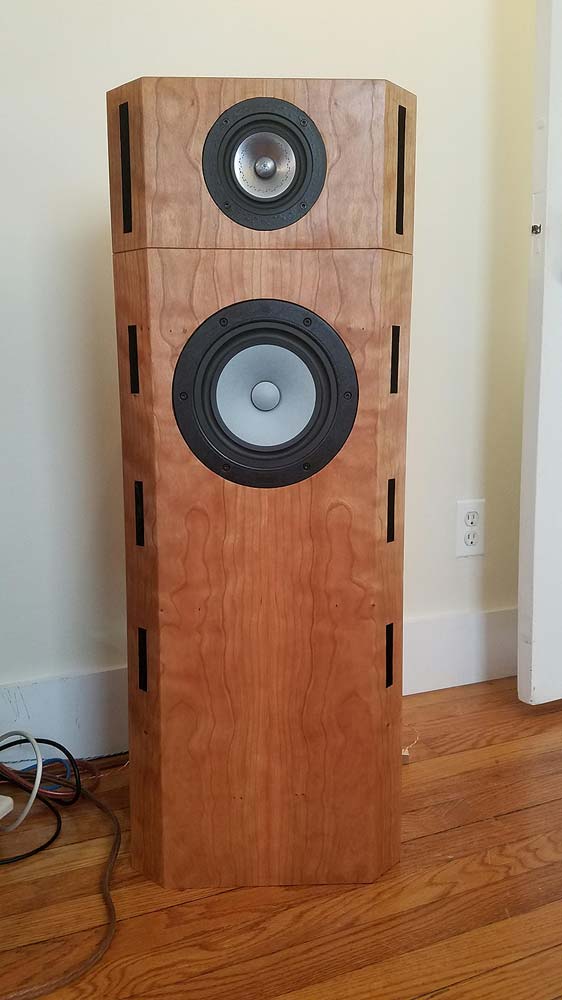

I finally finished them!
There are few benefits to working for the federal government during these strange days, but a recent one is a prodigious amount of free time. Among a host of home improvement projects, I was able to steal some time for veneering.
4 days, to be exact.
This was my first veneering project, and these were probably not the best/easiest project to learn on. It took about twice as long as I expected, but I got em done.
Many thanks to Chris B.. I never would have been able to pull it off without his expert advice.
Congratulations, the finished speakers look really good! Doesn't look like a beginner project at all. 🙂
Would you mind sharing a few more details about the set up you are using and some listening impressions? How many hours do you have on the drivers?
+1, Chris's advice regarding woodworking and veneering has helped me a lot too. Thank you Chris, your helping out beginners like us is much appreciated. 🙂

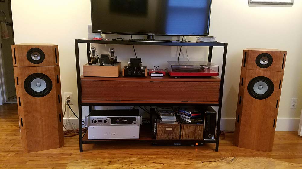

Thanks, Zman.
My setup is as follows:
Sources: Project Debut Carbon with Shure cartridge (can't remember the model at the moment) through a Bellari phono stage.
Lampizator Amber 2 DAC
Pre Amp: AES AE3 upgraded throughout with Auricaps. Sylvania ChromeDome 6SN7s
Power Amps: Bottlehead Stereomour SET with Mullard and JJ tubes (driving the 7.3), Crown XRS1500 (driving the 12pw)
Crossovers are passive line level, using whatever caps and resistors Mouser sent that fit the specs. I used Duelund 16g tinned copper wire, just because.
Speaker cable: twisted pairs extricated from CAT6. Thin and solid, as directed by Dave. Haven't tried anything else, but is sure sounds good. Soldered directly to the driver with no binding posts used.
The sound is sublime. Revealing, but never harsh or shouty like some of my other full-rangers were. VERY fast and detailed yet super smooth. Bass is prodigious and, again, fast. Punchy is a term my guests use frequently. The realism and soundstage are downright freaky.
There are undoubtedly many speakers that do some things better, but in my (small) room, at my normal listening levels, these are truly fantastic. I cast a very wide musical net. From Jamiroquai to Jason Isbell, Metallica to Bach, they'll do it all (within reason). They won't necessarily blow your hair back with crazy SPLs (though I give up before they do) and poor recordings are revealed for what they are. But feed them something truly well recorded and, in my semi-near field situation, they blow my mind.
Highly recommended.
