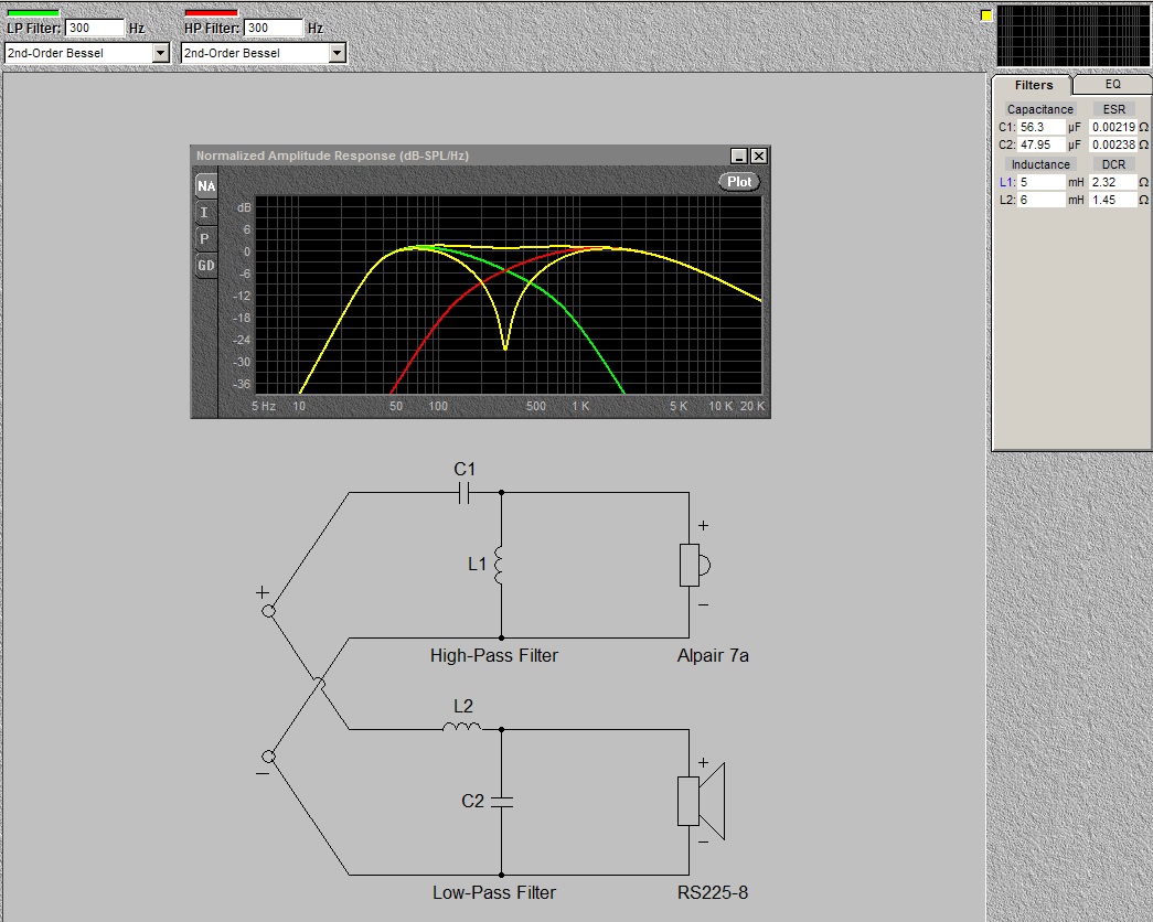

That was X-Over 3 Pro, with it's built in modeling.
I fiddled with the component values to get something that looks good.
A7 Gold RS225-8 SIM
Here is a quick sim with the RS225-8 in 38L @ 35hz.
This would be a 3" port about 9" long.
This doesn't take any baffle step comp. into consideration but you could easily build your baffle width to be close to 300hz unless you want a slim cabinet.

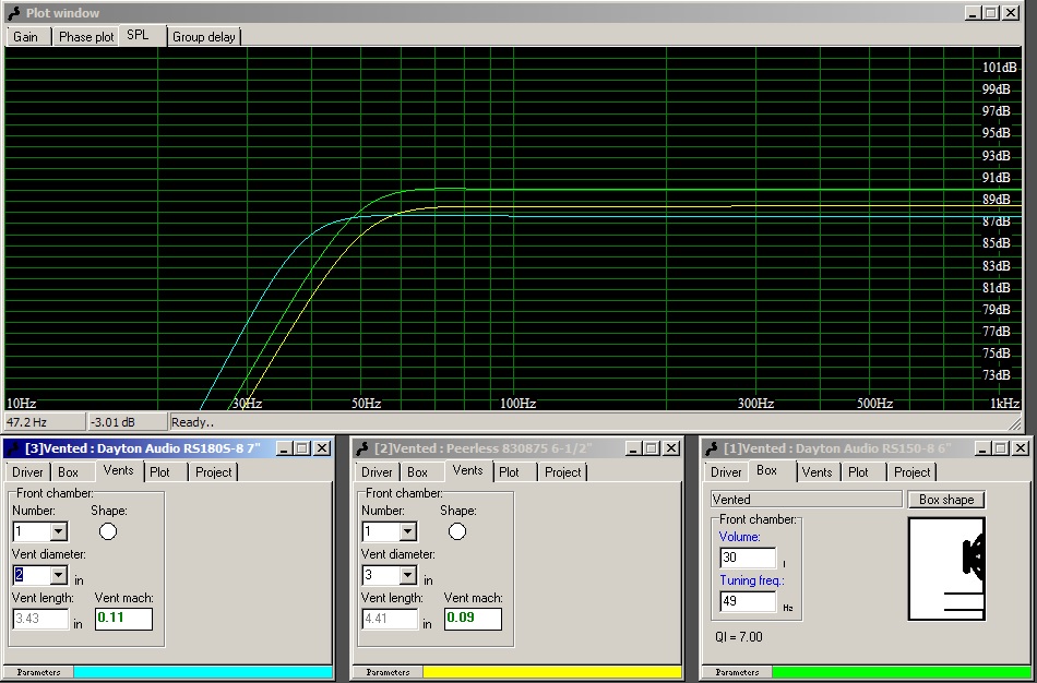

Woofer Comparisons
Here are a few box sims for dual peerless, dual dayton RS150 and single dayton RS180S-8.
The RS180 has the same OD as the Peerless but the peerless has a truncated frame that makes it .75" narrower.
If that extra .75" is a deal breaker then so be it but for a similar cabinet size and half the driver numbers and cost you get an extra 12hz @ -3db and 10hz @-6db.
The RS180 will be well out of its breakup around 4-10k if you were to cross over at around 300hz.
