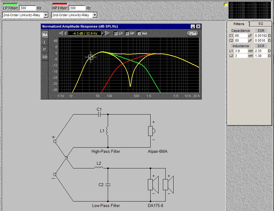

AP6.2 Gold x Dual DA175 Passive FAST
Here is just a simulation but it looks kinda promising, Parts would cost about $200 +S&H.
4 DA175's should provide plenty of bottom end.
The A6.2MA will be in the Madisound 1.7l chamber and the DA175's would be in 1.8-2cuft shared tuned to 31-33hz.

I am seriously looking at the Dayton RSS315HF-4 in a 50l sealed box. Using a Linkwitz transform or a DSP equivalent, you can get 103dB@30Hz and 97dB@20Hz. This at 250w/ch and not exceeding either Xmax or RMS power limits. The beauty of sealed is that you can run prodigious power through the speaker without worrying about the cabinet unloading.
Bob
